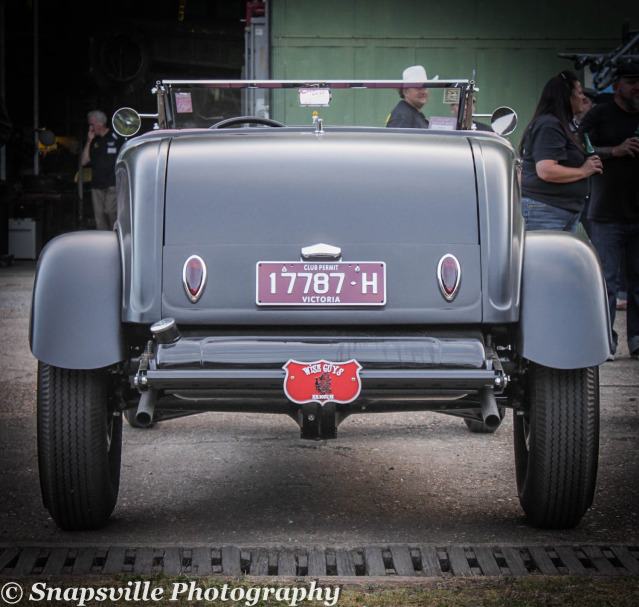

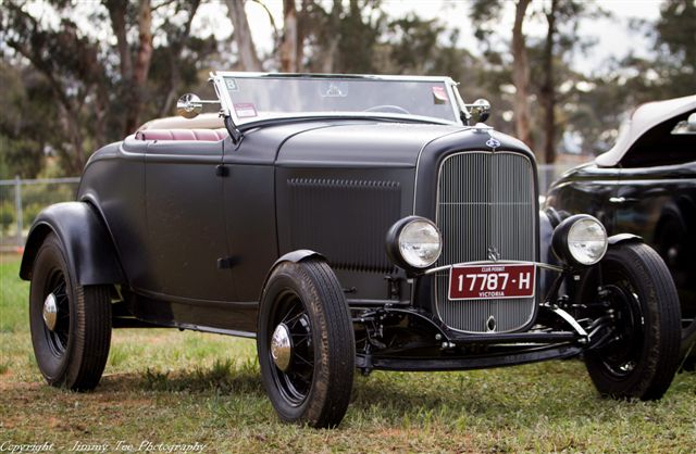

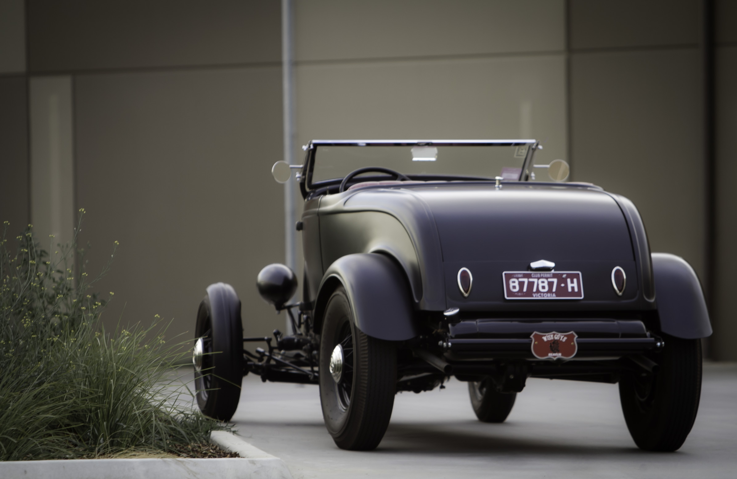

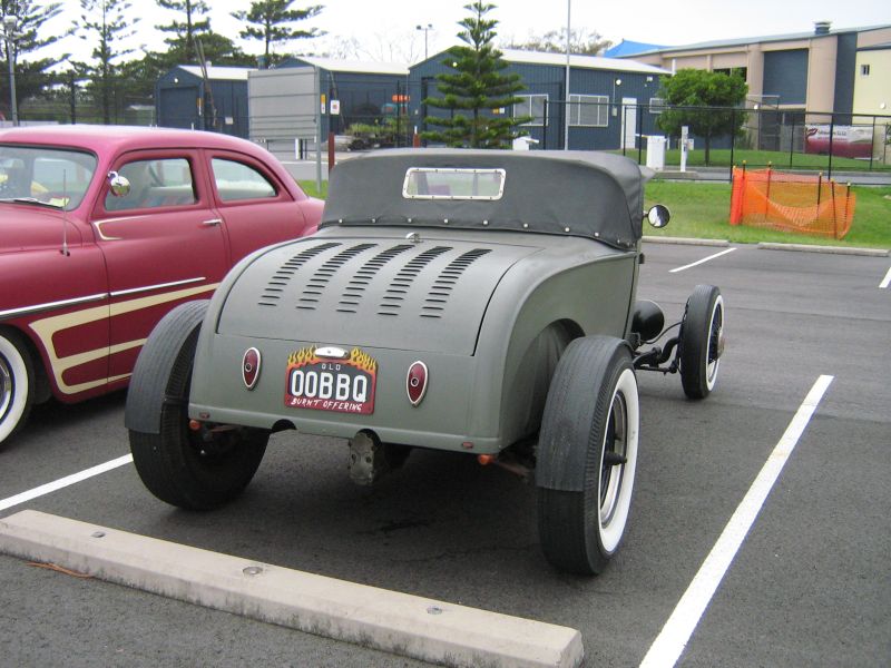

  19. Here you go.....original 36 Ford spare wheel cover on the front & bobbed 32 fenders on the rear.
    Removable in a few mins.
    Done.
    To keep the fuzz at bay, I keep em on this car but they "fall off" from time to time. This is the land down under, when we have more bullshit "laws" than we have people (sheeple)

  20. best set up you can hope for (I like the look) 44 gal drums please no, have seen some on a "bobber" it did suit that look but an early roadster nup.
  21. sorry forgot the pic -

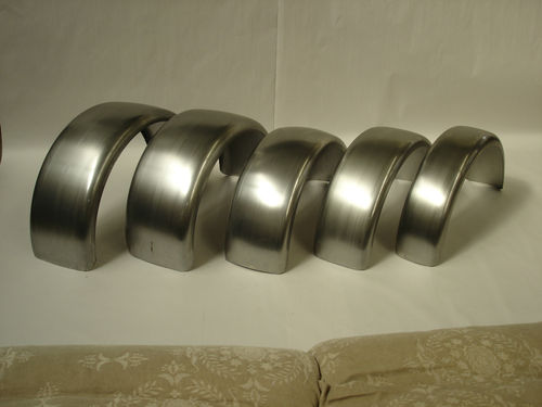

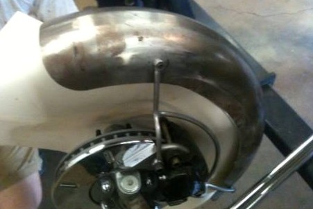

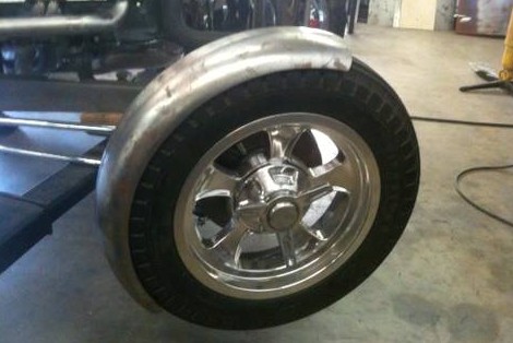

    mine came straight from China thru our friend Jesse James ...
  24. ^
    I
    the way to go for sure, the ones that somehow fall off reflect badly on all of us, we are all ready the most scrutinized car people on the road and don't need any more rules "to save us from our self".

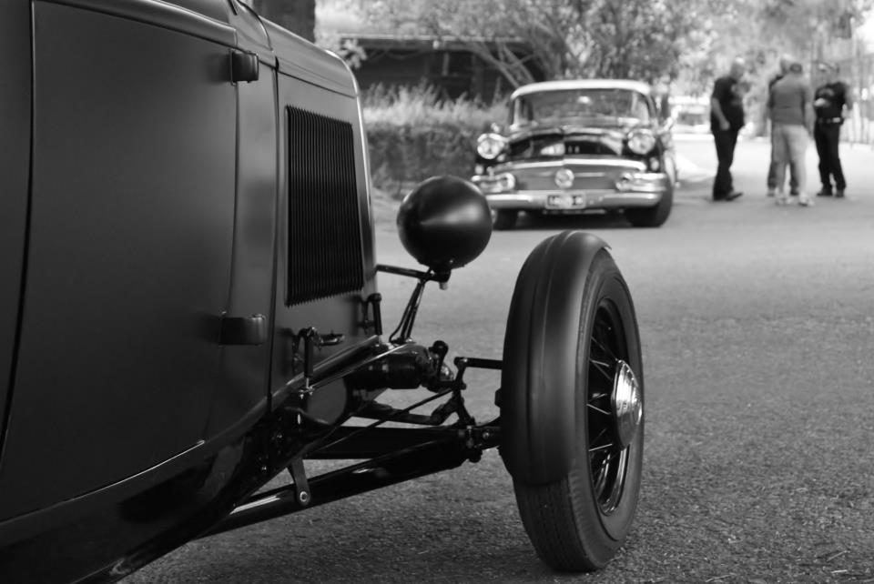

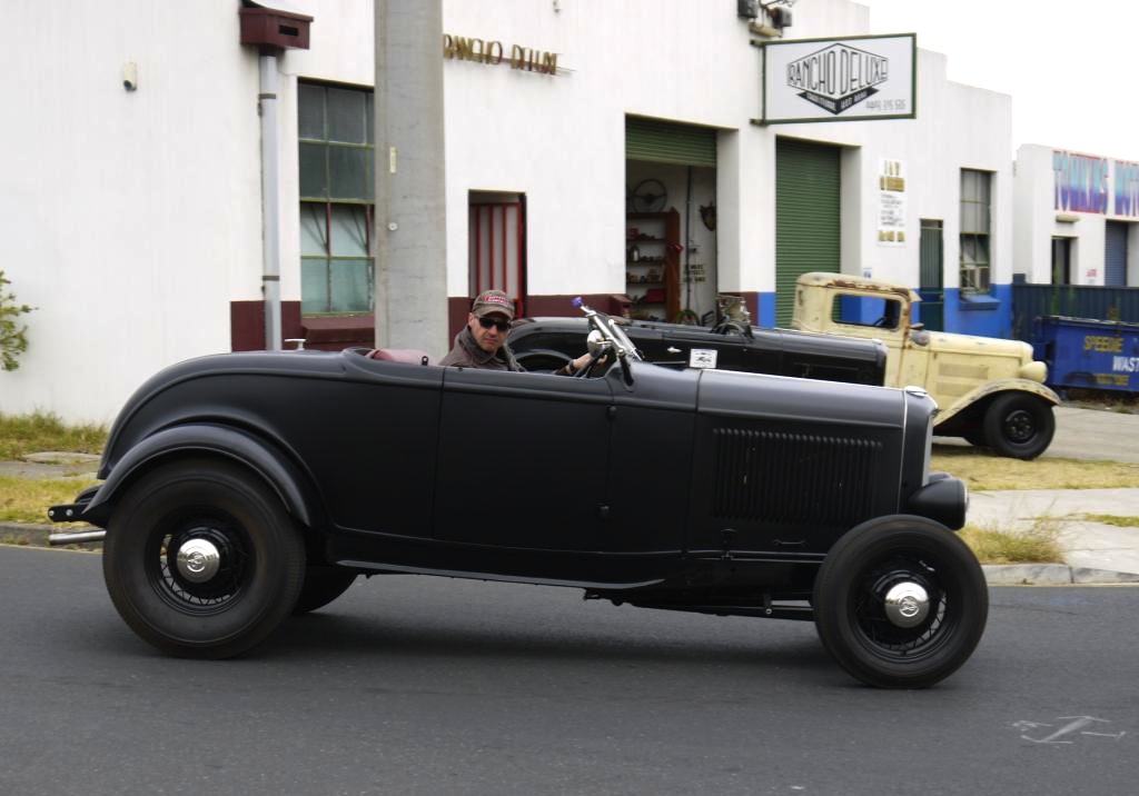

  25. Guys have a good alternative to running obvious cycle guards..
    One of my good mates, Dick Thornton (Some of you may of heard of him, hes a local southside Brisbane guy), had the bright idea of using fibreglass from memory and patching it over the tire he has on his Roadster, and then glassed it into some flat bar strap mounts and painted it all black.
    He now has cycle guards with the shape of his tire molded into the cycle guard and has them very tightly mounted so it almost looks like he has none on at all.
    I will try and find a photo of them..
  26. Heres a photo from about 4 or 5 years ago.. the car is now black so some of you would've seen it from Wintersun / Cooly Rocks On and other local shows.. but it shows the cycle guards pretty well.

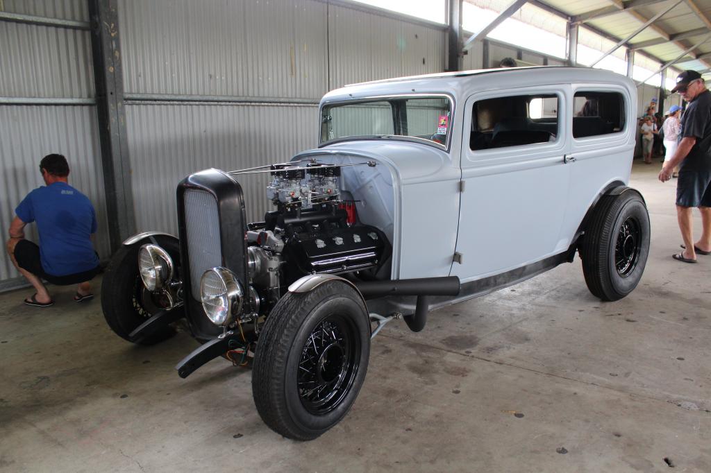

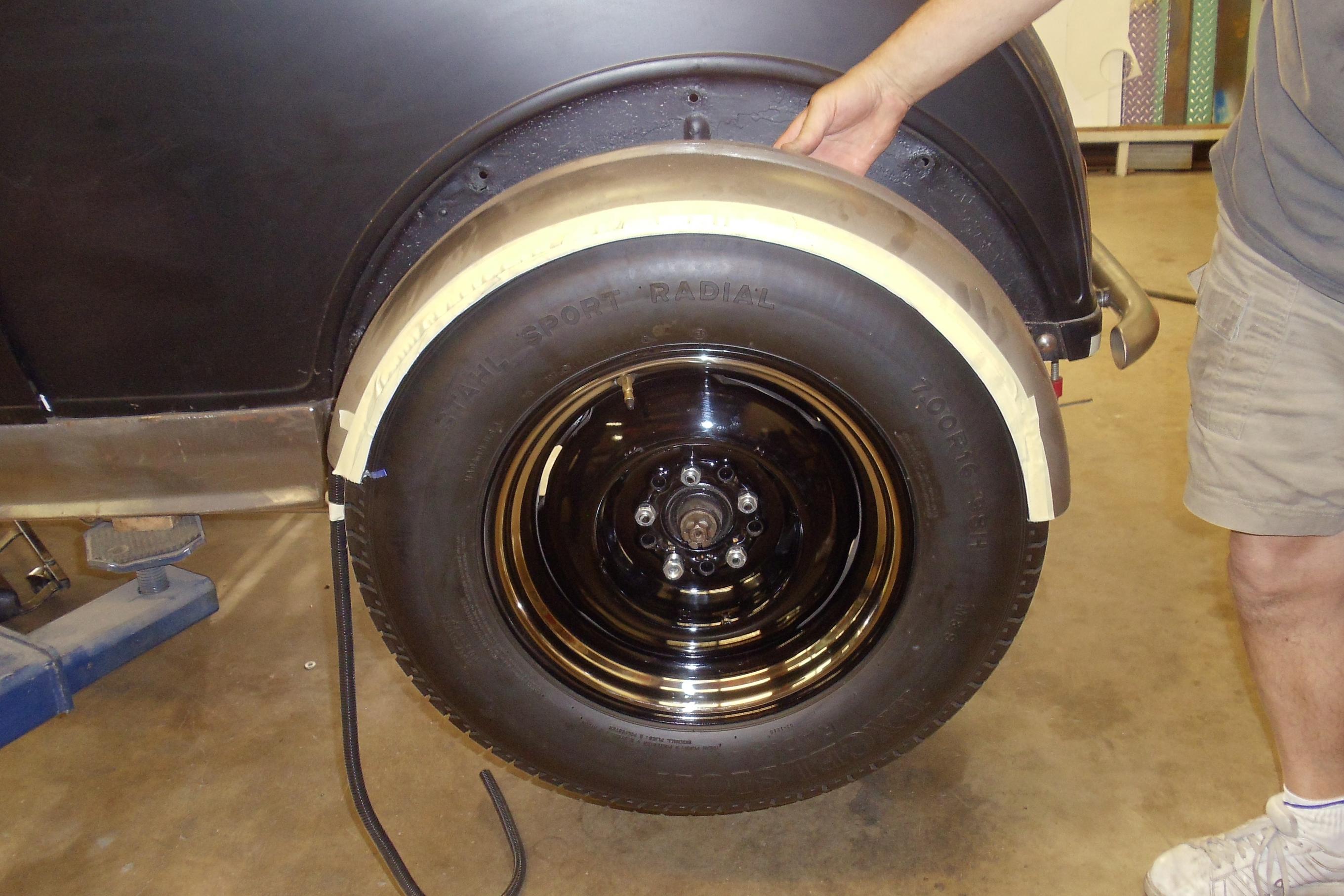

    Mine has 36 spare wheel cover on the front and fibreglass wider 36 copies on the rear. The rear are held on with sikaflex so no bolts through the guard. Front are welded to the bracket. Painted them flat black i hardly notice them on there.

    Nice. But I've never, ever seen 36 Ford (or similar) spare tire covers for sale, new or used. Gary
