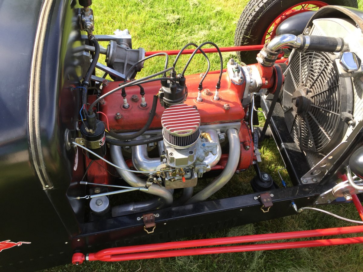

    I know MG ran a knee action shock. They may be Houdallie I am not sure. Chevys and some Mopar ran delco love joy knee action shocks. here is a shot of my coupe. [​IMG]

    Exciting news! The coupe runs. I need to play with the timing some and put some smaller jets in it. The muffler will go on quickly too. I am going to make the hill climb! Lots of little things to do now.
