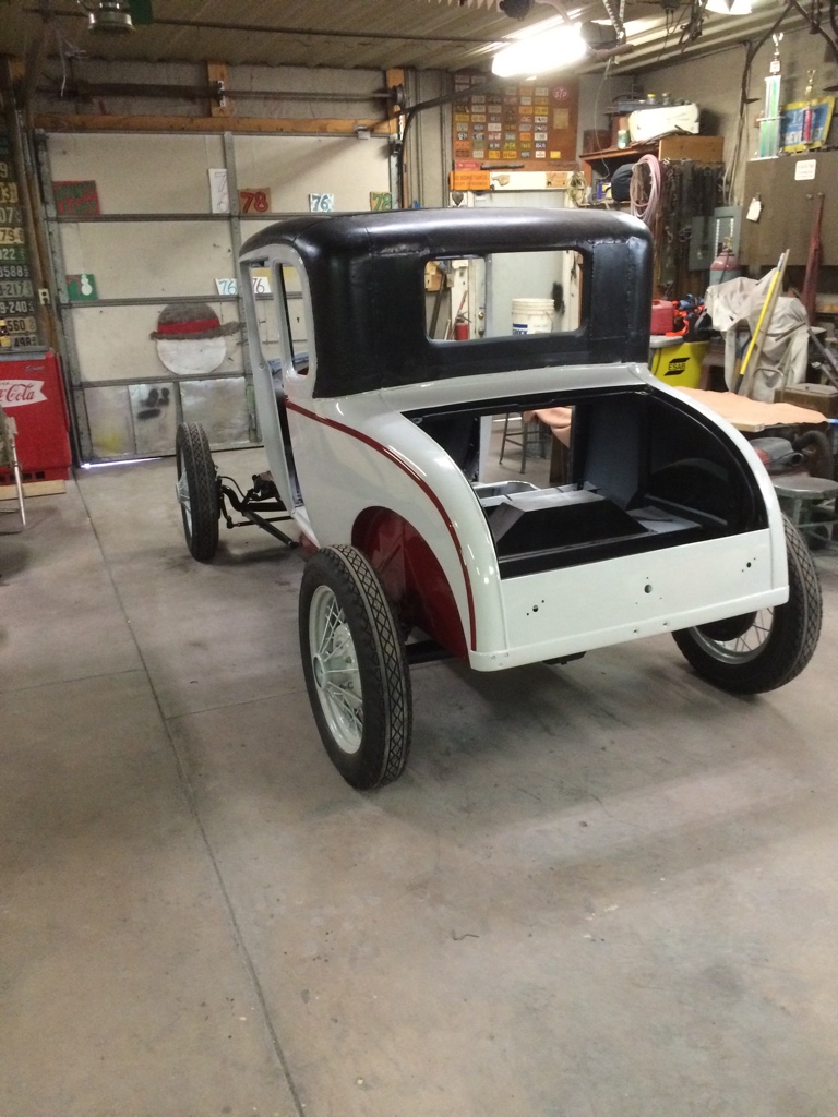

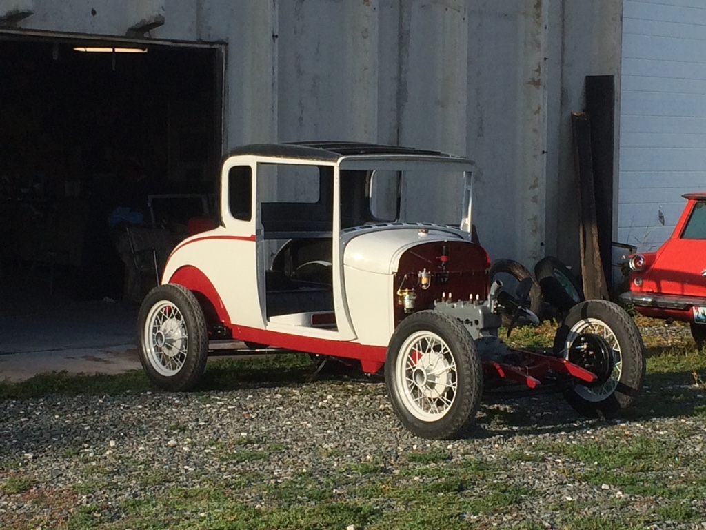

    An exciting day for my banger world. Got the body on the chassis today. I am going to make the Hill Climb in Colorado.

  5. Lucky you! are you gonna drive her there being you're only 6 hours away?
    I was just wondering, so I checked my hours and it's 18.5 hours! (OUCH:eek:)
    Maybe next year for me? I have to keep my engine together for T.R.O.G.
    Good luck and have fun!
    Joe

    Love the colour combination. Be sure to post some pics of the Colorado Hill Climb when you go. Thanks

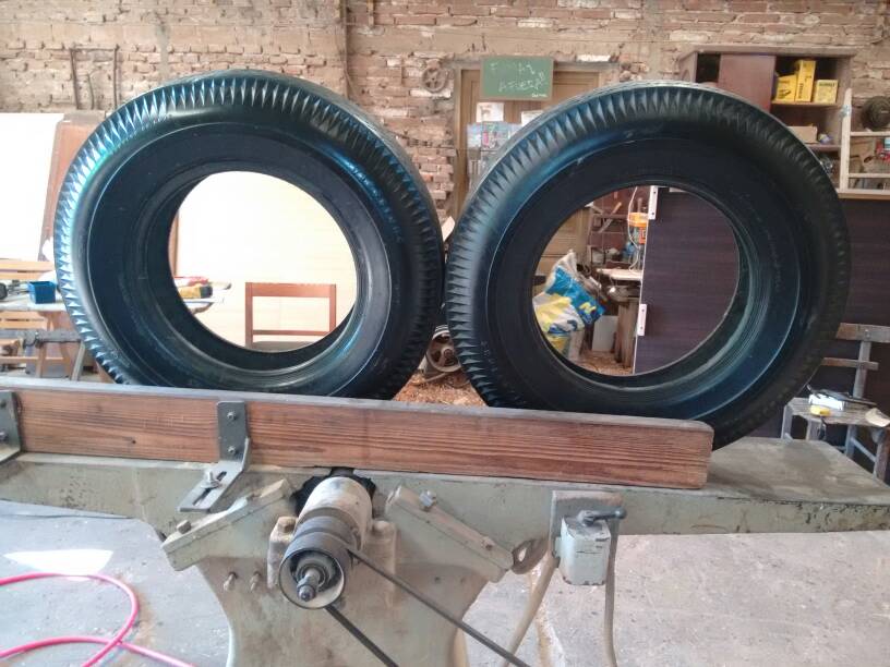

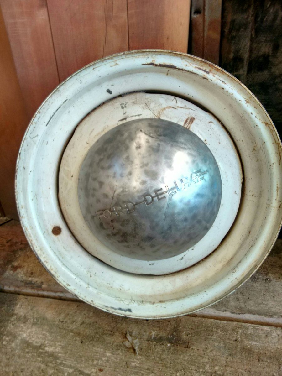

  12. Working on the Banger RPU! I made a reversed eye and low front spring, 32 axle with perches, mechanical brakes!! Found a pair of early Firestone tires 15 x 6.50! Plan to used with 15 rims and Ford Deluxe hubcaps and 7.50 x 16 at rear!!
    Pictures 16 F100 rim with 40 deluxe hubcap!
    Rear Pirelli style tire!
    Front end and Firestone's

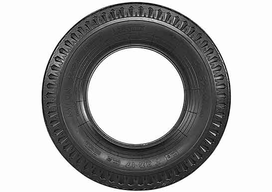

  15. Link to the Pirelli style tires please???

  17. Hi Cactus! Been in Argentina is almost impossible to find new classic style tires, so the light trucks were the option in those lands! Tires like Firestone, Pirelli and Fate!!
    Found a link on Pirelli.mx but isn't listed on Pirelli USA! Certainly this tires have the old look! Maybe because there are plenty old Ford pickups and light trucks over my country!
    http://www.pirelli.com/tyre/mx/es/truck_bus/sheet/ct52.html
    ratamahata
  18. They do have a nice look to them! Thanks for the link anyway!

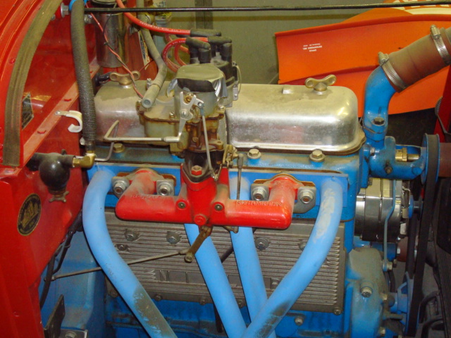

    Here's a B in a '29 CCPU with an original CRAGAR head. plenty of room. DSC00021.JPG
    To Scott F....my '31 powered Zipper roadster pulled 60HP at the rear wheels. Engine has a single 97, Crower cam, inserts, FS ignition, Brumfield head, headers and counterweighted crank.
