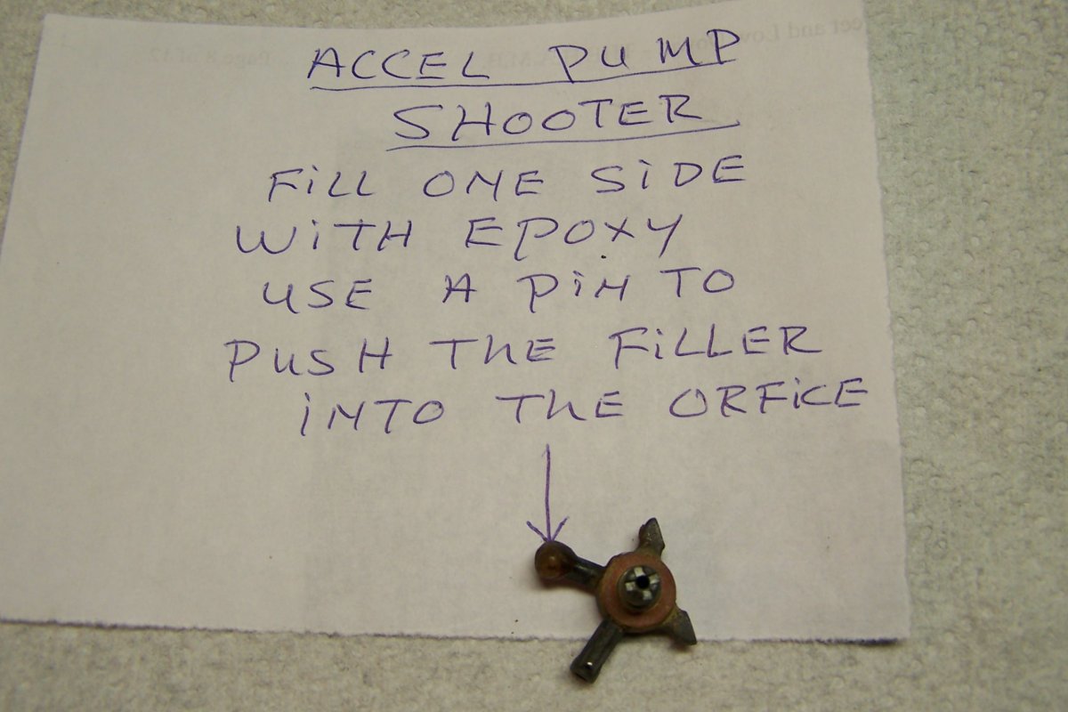

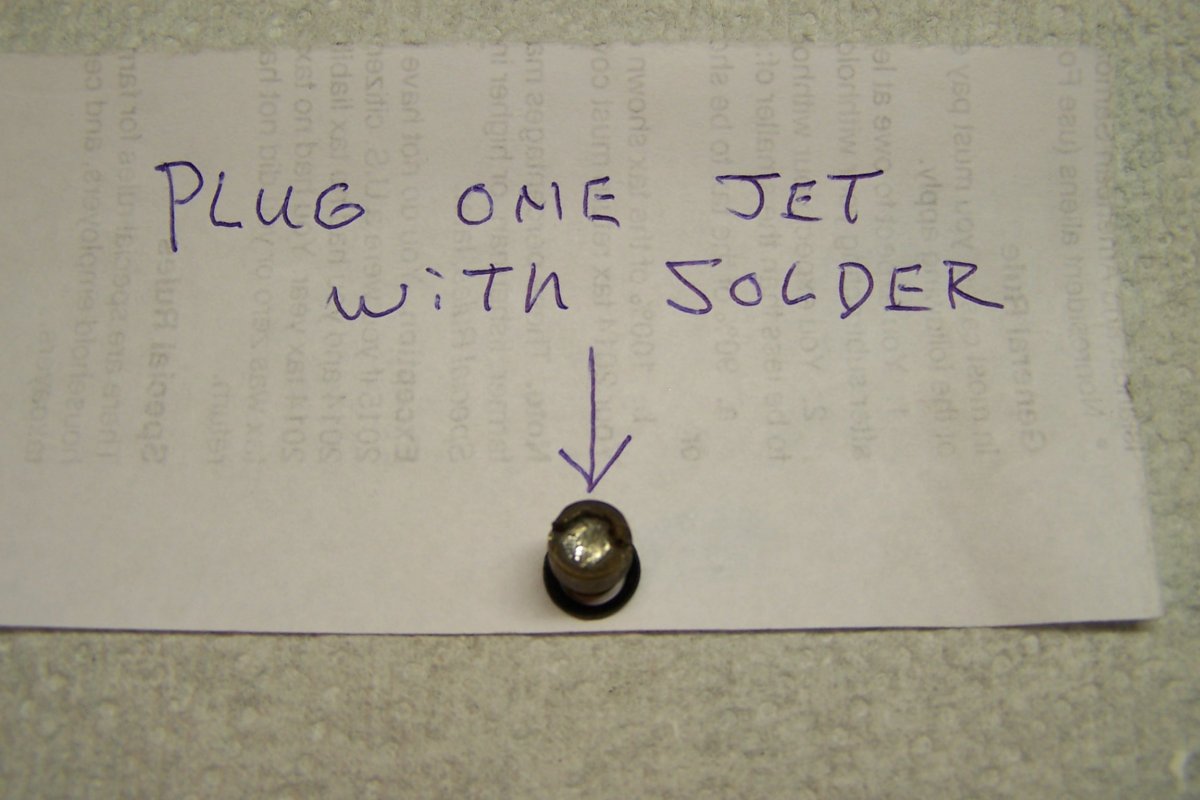

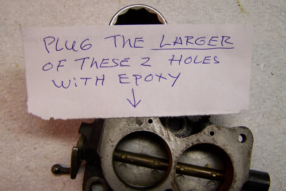

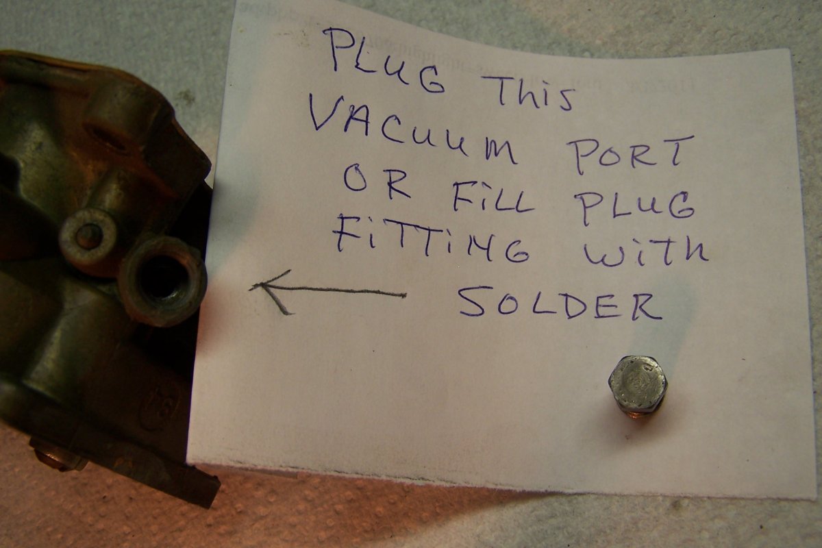

    Here was my solution to dual 94 carbs being too much for a nearly stock "A" engine. I have this setup for two years now; first on my A engine and presently on a .040 over "B". I wanted the look of dual carbs so I blocked off one venturi in each carb; in a sense made two single bbl.'s out of them. I chose the venturi farthest away from the linkage to get the best seal on the throttle body shaft. All you need to do is block off a couple of vacuum passages, plug a jet with solder and cap off one side of the accelerator pump shooter; and make a block off plate for the throttle plate not used. The following pictures will show what I did. My 94's came with 11/16 venturis and .051 jets but the engine ran badly until I went way up in jet size. Presently using .062 jets. Jet size may vary depending on engine mods and intake design. The throttle response is instant at any rpm and pulls real strong.

    Thanks for an interesting tech on an age-old issue. I'm curious if you made any changes with the power valves? It seems like with the stock PV's you would still be getting twice the enrichment needed, or does blocking the discharge nozzle for the accelerator pump take care of that?

    Sorry, I left the power valve issue out. I have a vacuum pump and made a fixture to hold the power valves, and an inches of water gauge so I could mess with the springs on them...got them down to approx. 4.5 inches of water. No I don't believe the accel pump nozzle does nothing more than it should and remember you only need on side now as everything is dead on one side: idle screw, throttle blade and idle circuit. If for nothing else, blocking one side of the nozzle makes the other side squirt real strong. As I said it fooled me as to jet size; you would think one .051 in each carb would be enough as if you had one single 2 bbl 94 on the engine. But it was way too lean and the only next larger drill size I had was approx. .062. I now have some more drills to try to see if it can be leaned out a bit. It burns a nice brown on the plugs and I don't want to go too lean and don't really care how much gas it uses. I can jamb the pedal to the floor at any speed and it will not bog or pop. Be aware that there are at least 3 venturi sizes that I have found: 15/16, 1 inch , and 1 1/16th. So if you do this, make sure that both carbs are the same and and sync them with a u-gauge
