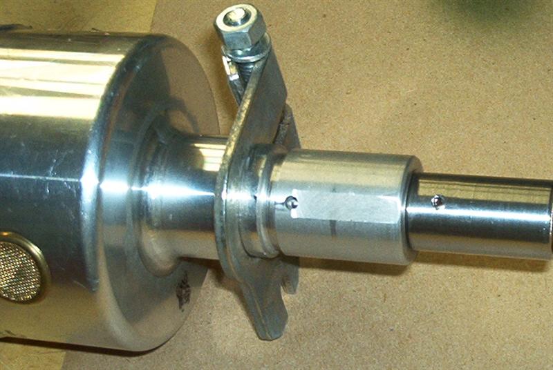

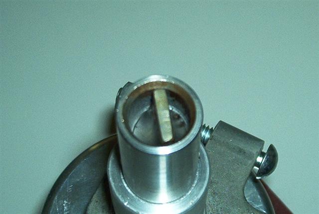

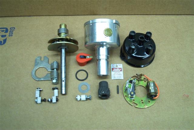

  16. I never cared much for the "A" distributor and I have used FS, Wico, Mallory, and now I'm running a Ford model "B" which is a simpler design and can be tuned with modified or "new" weights and springs from FS. I use Stipe point cams purchased from Renners as most suppliers cams are rough and some are not concentric, and I use stock points. Renners will also suppiy you with a new shaft if needed as most "B" distributors were not drilled through the bushings at the oilers. You can buy round modern looking distributor caps and wires from most suppliers. Here is a pic

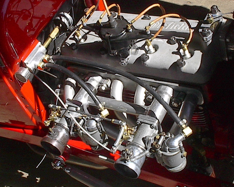

  18. Magnus B
    Joined: Jun 19, 2005
    Posts: 885
    Magnus B

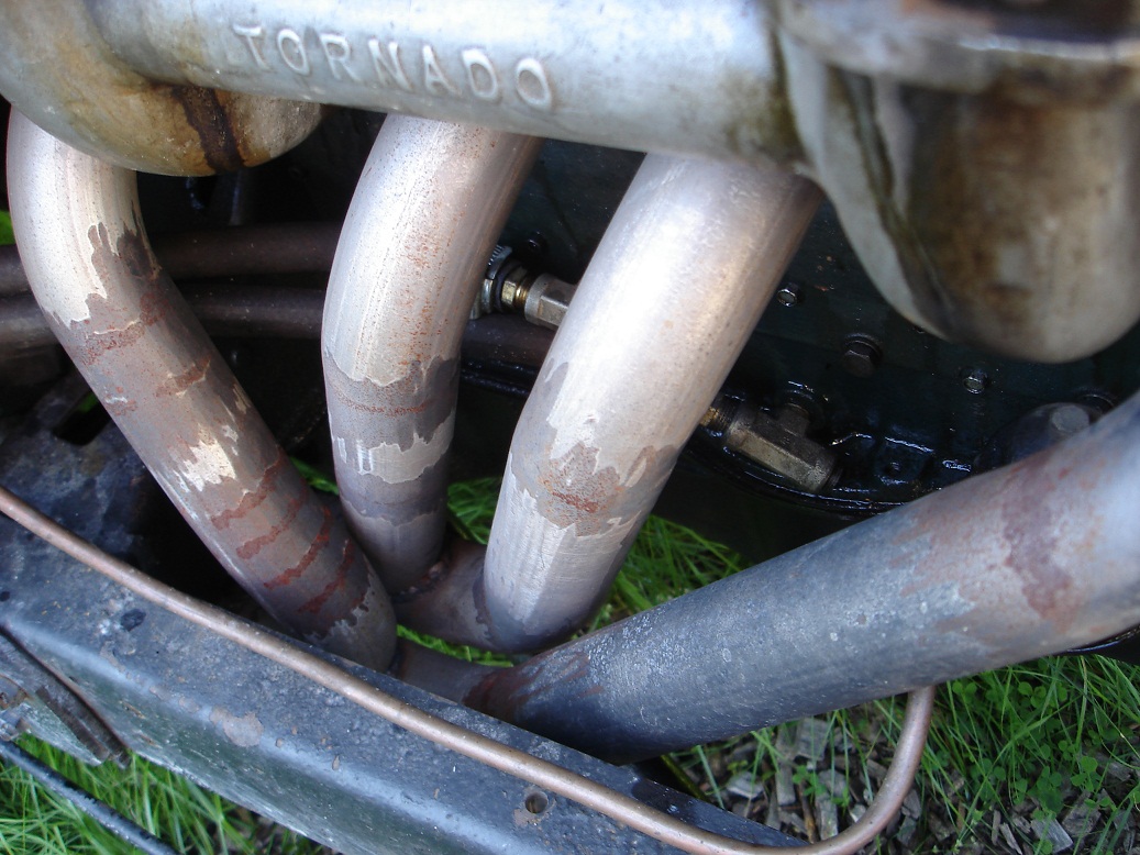

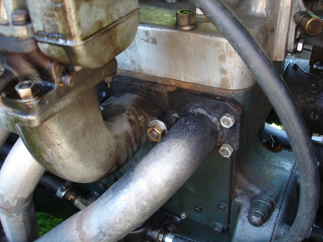

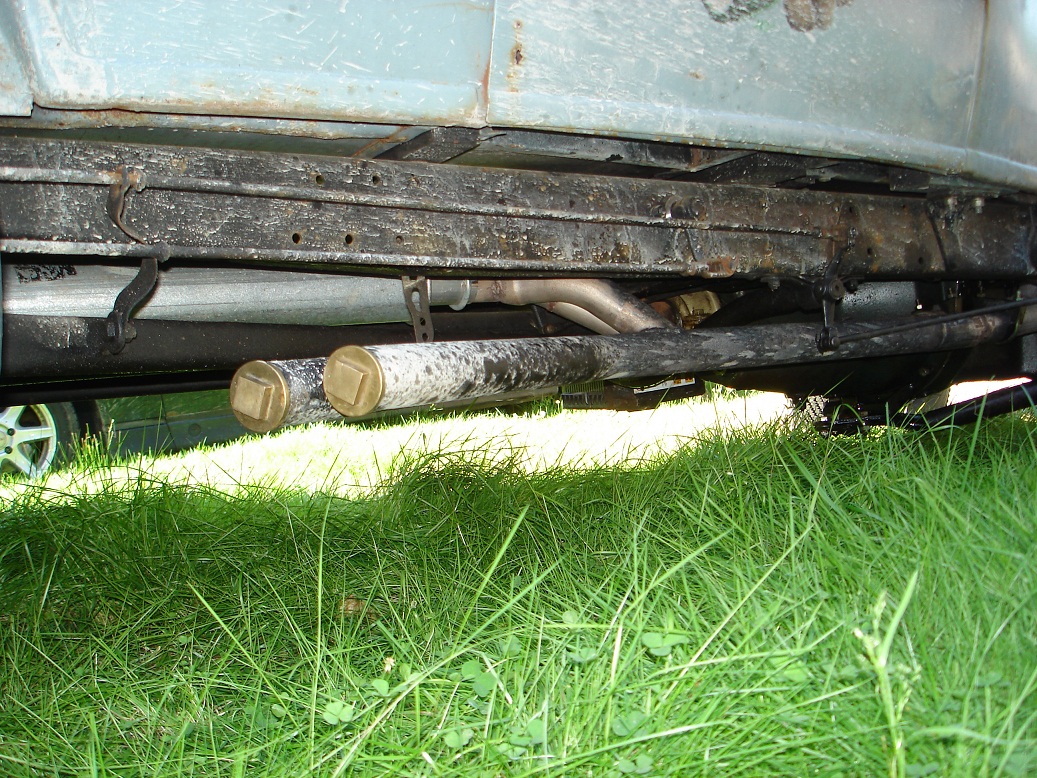

    Well that would work of course. Unless I did such a sloppy job welding my last exhaust manifold. I used 2 shortened stock manifolds and the ports didn't really line up after I was finished. I actually used rings as locators during the welding, but after they cracked and I rewelded them a couple of times it was just a mess. One advantage with the is that olny the header is held in place by them so I can remove the intake without removing the exhaust.
    I forgot to add the pics of the new header. A bit to large tubes, but that what they had at the store.

  23. RussTee
    Joined: Mar 25, 2008
    Posts: 1,186
    RussTee
    Nice work magnus now try building one for a right hand drive just to test your skills Ha Ha
