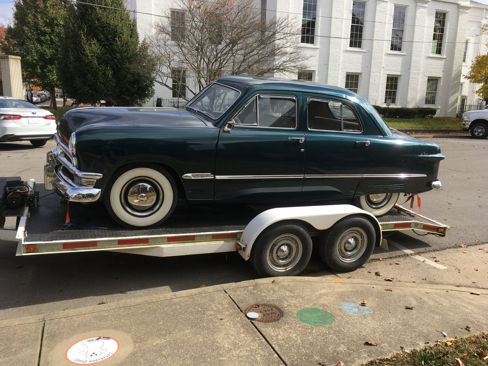

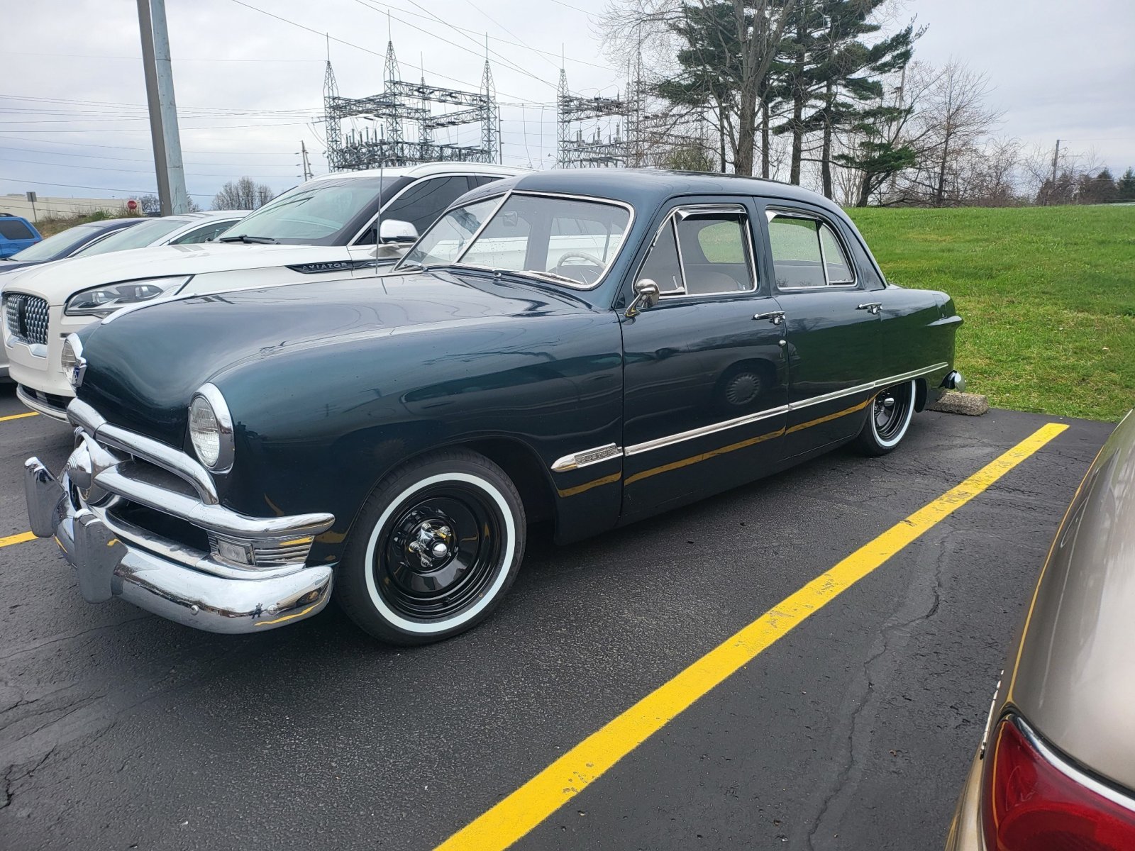

    Guys, here is the other post.
    https://www.jalopyjournal.com/forum/threads/high-compression-heads-worth-it.1273049/
    My son just bought his first flathead.
    He too got very frustrated getting it to run smoothly and dependably.
    He was lucky to bounce his problems off me to get it running well.
    You just need some direction. 11F22057-F6A1-4E71-A861-CF7E350F40A0.jpeg FA732D7D-E895-432E-8F33-1A06D43A37C4.jpeg
