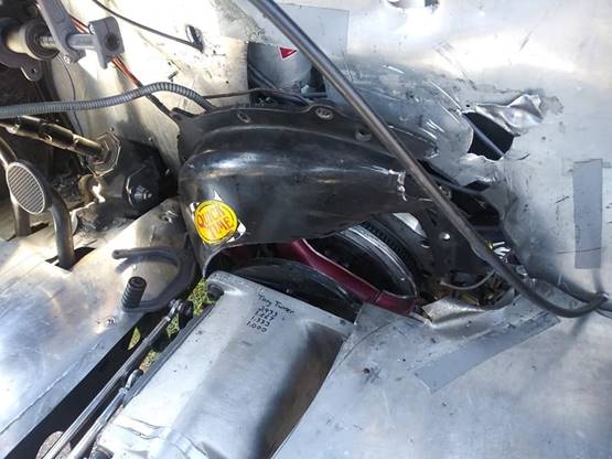

    glad to hear! sorry for the damage. thanks for the update and the tip about not drilling into the housing.
    I started the thread, so damage and/or any injuries might be avoided or minimized in the future, not to spread rumors or face book drama.

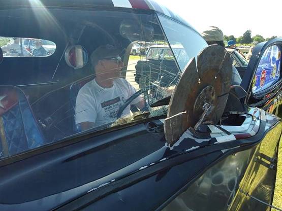

    Hello,
    That is some scary photo. (some work, circumstances prevent it other times…)

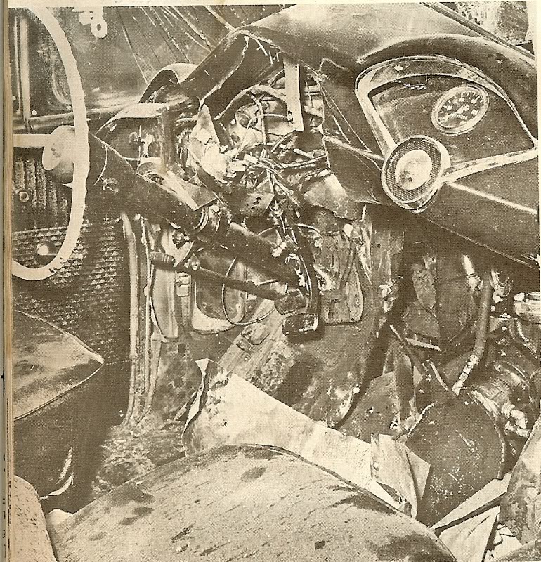

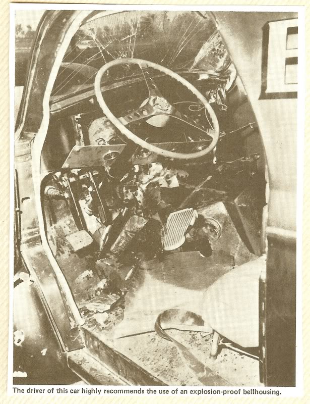

    In August 1960, upon seeing our C/Gas Willys coupe the next day after the clutch explosion, fire and crash into the Lions Dragstrip fence, we were amazed. It did not have a huge plate sticking up like the photos, but there were a million metal pieces wedged into the steel dash, door and window frames and lower kickplate areas.
    Luckily, my brother did not get any metal fragments on or in him. A helmet, long sleeve shirt and his lucky, favorite, nylon Wynn’s Friction Proofing jacket helped. But, those items did not prevent the 3rd degree burns, despite the fire extinguisher.
    We had the required two piece metal scatter shield that all of the top racers were using at the time. The explosion was so horrific and powerful that the scatter shield, the clutch and bellhousing were in pieces and nowhere to be found in the burned out interior. Just a giant hole in the floorboard where there used to be a nice, curved, metal replacement floor.

    Yes, a 360 degree one piece probably would have helped. (not made at the time, but several months later by Lakewood) But, the brute force in those explosions is unparalleled in power. The burns were terrible with 30% in 3rd degree. The Moon Tank in the cab was the culprit for the fire. (the law was passed to move all tanks to the outside within two weeks…)

    @Dog_Patch I'm glad you're unhurt. As a kid I remember seeing the photos of Don Garlits' car when it's clutch blew. I was also at the HAMB drags a few years back when one of the racer's flywheel took out the mirror of a truck parked in the pits.

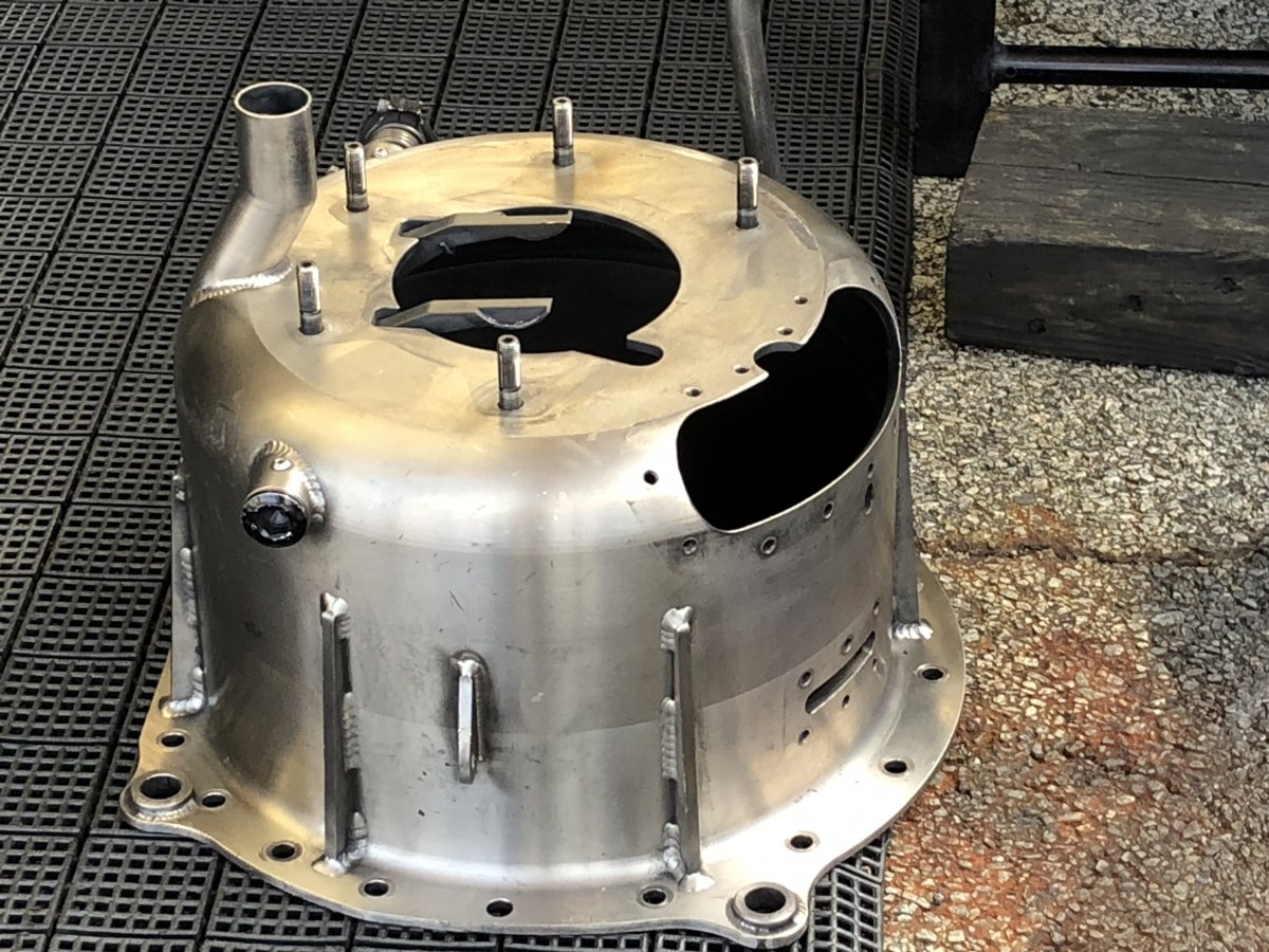

  8. I run cast iron truck bells in my cars, have been doing that for years, on the street and on with stock cars. Not a tremendous amount of protection and I stopped pulling hole shots decades ago.
    But that sudden release of the clutch pedal at 7 or 8-grand is another story. I would think that QT would want a closer look at the blown up one and pony up a fast replacement on the house.

    Looks like the trans input shaft broke by the center of the disc. All of our sticks have SFI housings but do not see launches. We also use solid centers. I glad he wasn't hurt.

    Agreed on them needing to do a postmortem on the blown part to look for failure points and opportunities for improvement.
    Looks like Holley now owns Quick Time. They also own Lakewood.
    I run a Lakewood bellhousing in my street car. Good piece of mind.

    An 1/8" thick scattershield is pretty thin considering what is expected of it, that should be the 1st warning. The Lakewood I ran was 1/4" thick, or 2x the protection.
    Years ago I put a Lakewood scattershield on my street driven Road Runner, the guy at the local speed shop wouldn't order one for me because he thought it was a waste of money on a street car. History proved it wasn't necessary, but it wasn't the speed shop owner's feet next to my bell, it was mine. I ordered the Lakewood from someone else. A few weeks before I had went in to order the scattershield, I spent some time one night digging chunks of a flywheel out of the street, the results of a very fortunate Nova driver's holeshot.
    The rotation of the flywheel is clockwise. If the flywheel (or clutch) come through the bell at the bottom or on the left side of the rotation, everything would be coming towards the drivers feet and the dash. He was lucky the scattershield failed where it did. Gene

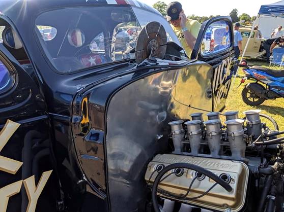

  27. C1A8FF3F-AEDF-4C6A-975B-8356DACB19A8.jpeg Goals- saw this at the top fuel pits yesterday
    saltflats, OLSKOOL57 and Deuces like this.

  29. That’s why I had to make a drawing - looking from the front it’s clockwise. From the back it’s counter clockwise. The steel hat beat the dowel pin out of the block and the bell bolts weren’t meant to support the side load and they all sheared. Engine tilted forward broke the front motor mount, trans popped out of the pilot bearing and away squirted the disc

    That solid disk has to act like a giant throwing star when the clutch blows. I'm just wondering if that may be too much spinning force for the way most scatter shields are made that have contained clutch explosions of less stout disk assemblies. That what looks like 1/4 plate hub is going to go somewhere no matter what you have around it.
