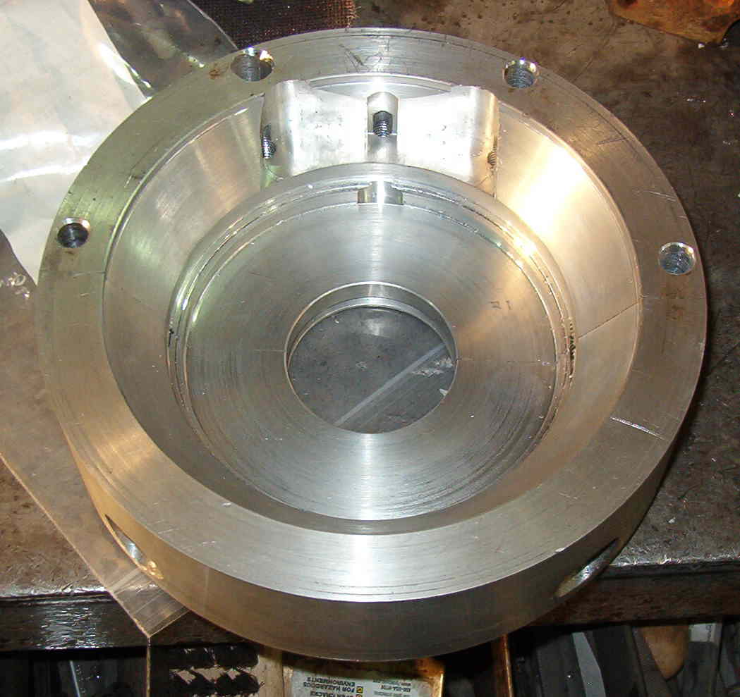

  1. Could you please show a picture or 2 of how you made the rear main seal housing and the adapter for the bell housing? Do you adapt it to make use of the rear main bolts or did you pin it to the block? it would be great to see how you did it.

    Fur Biscuit, I am not too swift on the computer and do not know how to download pictures. I do not have pictures showing much detail of the housing. But basically, it bolts to the back of the block and goes over the top of the main cap. It is in two pieces and comes apart at the pan rail. It uses the Burtz model A one piece rear main seal. I could send some pictures to someone if they would download them to the forum.

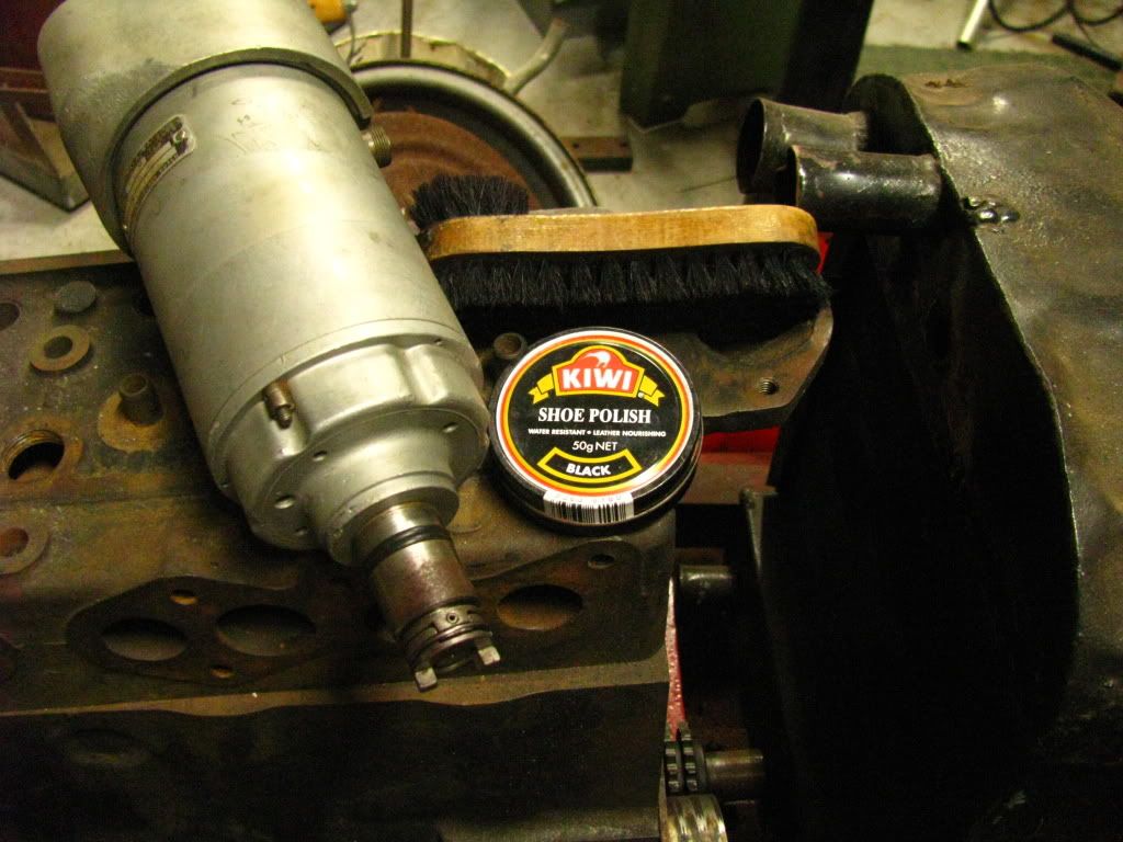

    That mag looks like some sort battery powered thing that women use to "relax "with.

    The joy of magnetos is you don't need batteries to get your 'old girl' started,
    she just needs a firm push from behind. :p
    Magneto & Titanium Man

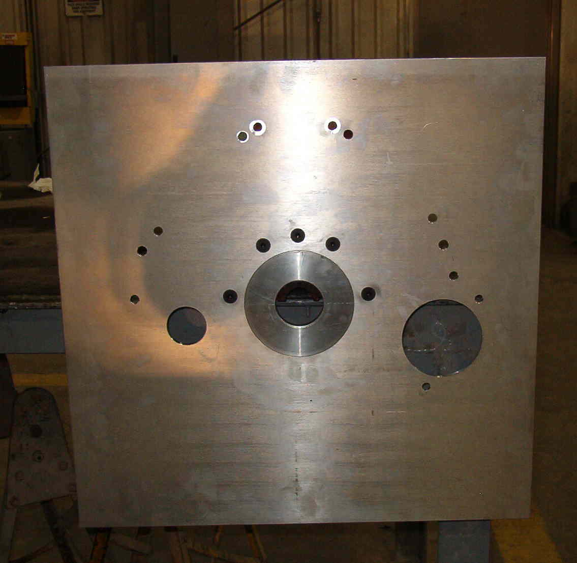

    <TABLE cellSpacing=0 cellPadding=0 border=0><TBODY><TR><TD vAlign=top>Thanks to Rich Fox for offering to post these pictures.
    I will try to explain how I made the seal housing and adapter, I started with a round section of aluminum about 11" in dia. by about 4" thick. It needs to be cut in two and bolted back together as 1/2 will be bolted to the back of the block using the old magneto ring bolt holes. The other half with the newly drilled and tapped holes will form the bottom half and the modified oil pan will bolt to the front of this. I hope the pictures will show this better. It is difficult to explain with out seeing it. Bolt the two halves back together and chuck it up in the lathe. The split line needs to be centered as that will wind up even with the pan rail. I turned the outside to the desired diameter. I purchased a mid-motor plate from a drag race supplier and used this as the actual adapter plate. These plates come CNC machined with the bolt pattern for the bell housing, starter hole and bolts and a large center hole. While I had the piece in the lathe, I turned a step to match the hole in the center of the motor plate. In the bore of the seal housing you need to turn a groove to accept the Burtz model A rear main seal. The housing is then turned around in the lathe and hollowed out to clear the protrusions on the back of the block and the rear main cap. It is necessary to put in the bolt pattern to bolt the upper half to the block, the lower half to the back of the oil pan. And drill and tap some holes to hold the plate to this housing. The reason for using a 1927-27 block is that it has the upper support bosses cast in the block like the Model A. It is necessary to use these bosses for support. I made a steel flywheel using a 302 Ford starter gear. That way I can just bolt up a stock 302 Ford starter. I hope this is helpful information and it can be understood</TD></TR></TBODY></TABLE>

  22. thanks. I think you said that you are using a model A crank, since you made the adapter/ spacer, did you still cut down the rear main on the crank, or did you leave it at the stock model A length?
    On the crank, what type of insert bearings are you running?

    I am using the Model A crank and leave the rear full length. I am using Contenental and Onan bearings. I can't remember which one is on the rods and mains. My next engine will use the new 1 piece Model A bearings that are now available. It would make it easier to get the oil holes where they are supposed to be, plus not having to mess with muliple inserts per journal. Thanks for offering to post these pictures. I had already sent them to Rich.
