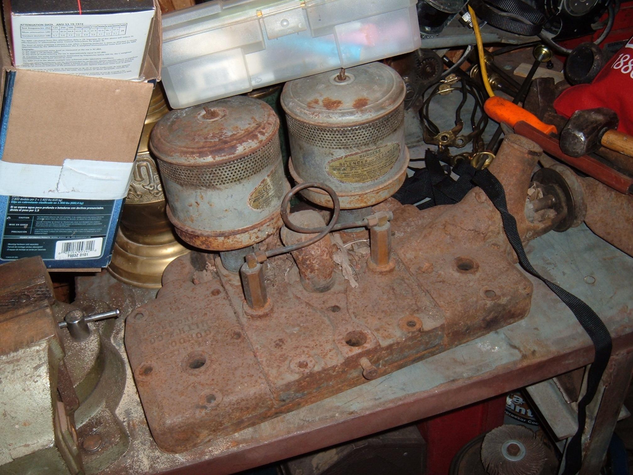

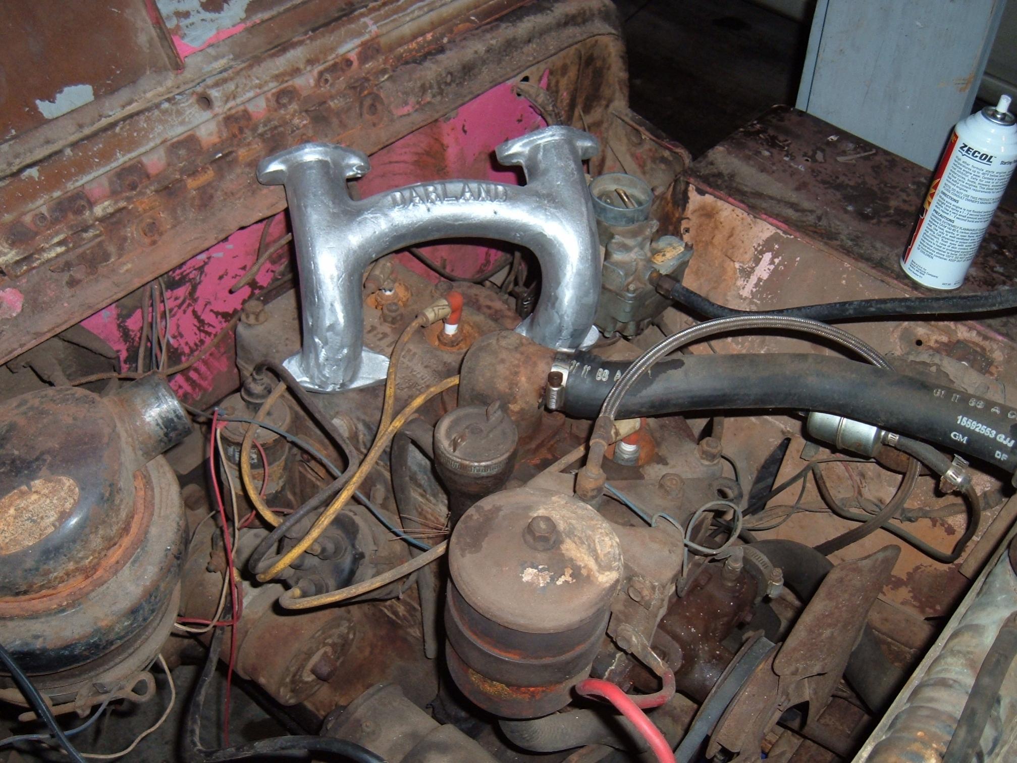

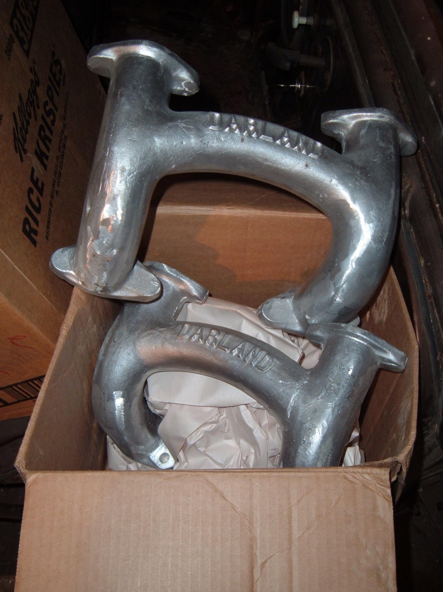

    Just like Rich Fox I like to let you Ford guys look at somthing else fora change.
    I bought these a month ago but didn't take pictures. They are made buy a Gent
    in Oregon. He's on the HAMB but doesn't post much.
    Here you Go!

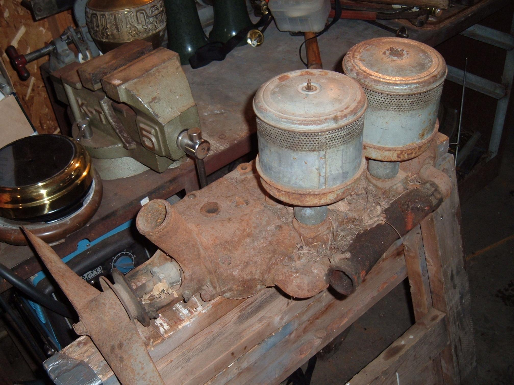

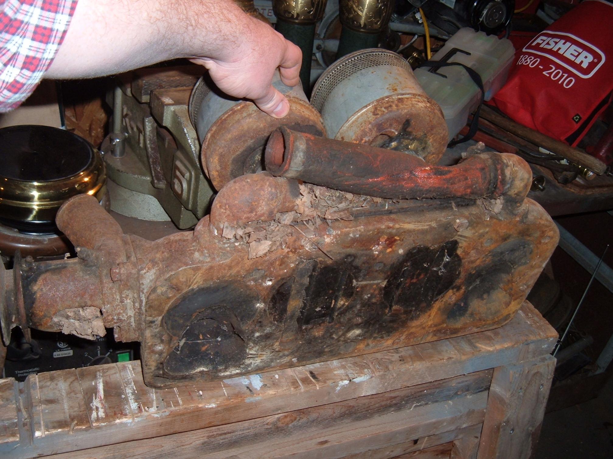

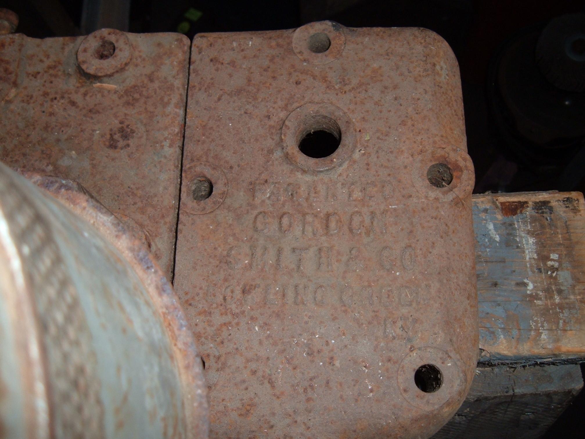

    Just for fun I thru in somthing I picked up at an Auction... It's Ford Related.
    Jeff
  26. RichFox
    Joined: Dec 3, 2006
    Posts: 10,020
    RichFox
    I thought the intakes might fit a Willys. But I don't have any idea about thr other thing.
  27. Crazydaddyo
    Joined: Apr 6, 2008
    Posts: 3,345
    Crazydaddyo
    Air compressor head for a model A.
  28. hotrodjeep
    Joined: Feb 3, 2009
    Posts: 867
    hotrodjeep
    from Tama, Iowa
    Your both right, Intakes for the Willys 134 Go-Devil, And a Gordon Smith AC Head.
    Yuu win................................. More pictures!
    Jeff
