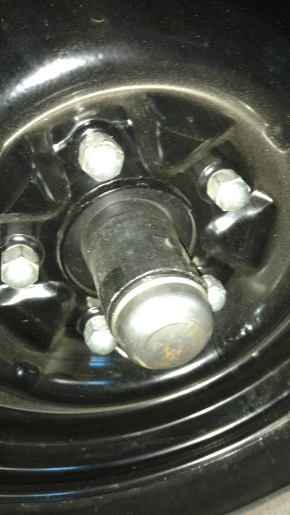

    Here is a dust cap that will work on an A hub. Have to make the stock washer smaller. 1587938262256.jpeg IMG_20200426_154659937.jpeg

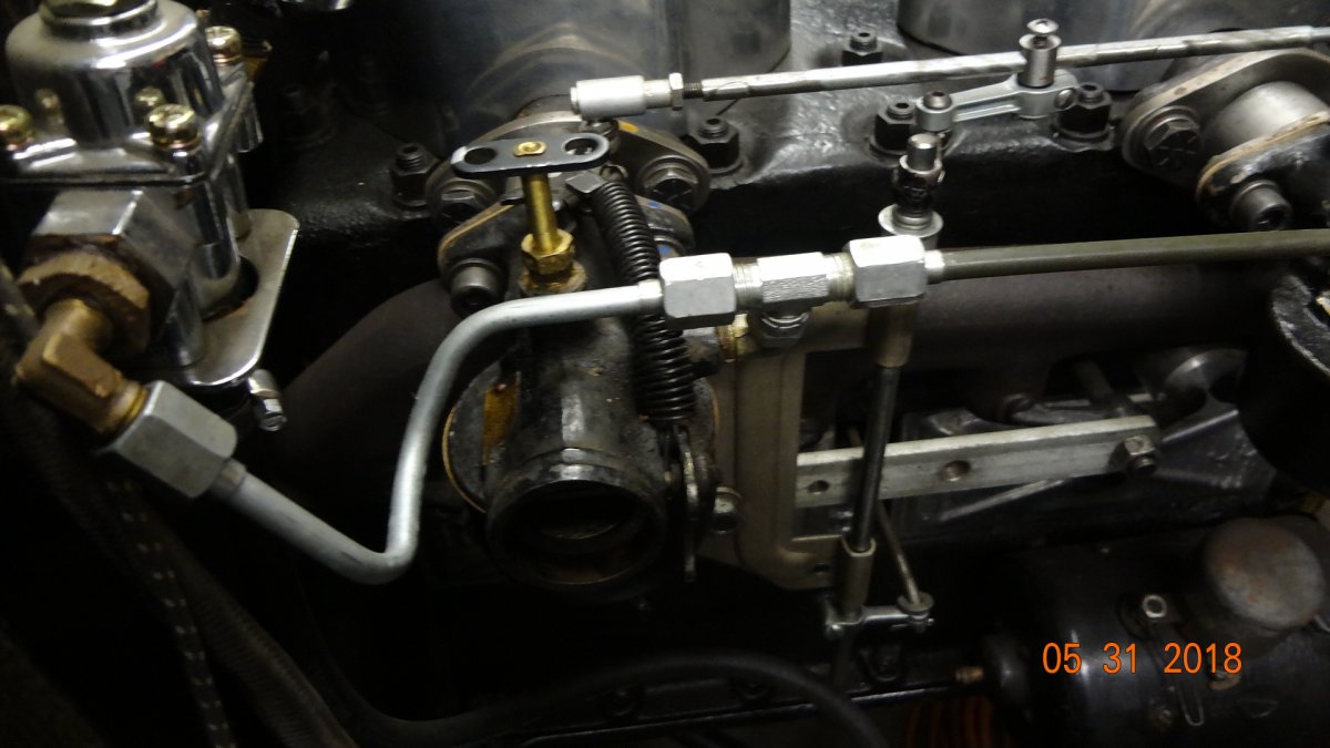

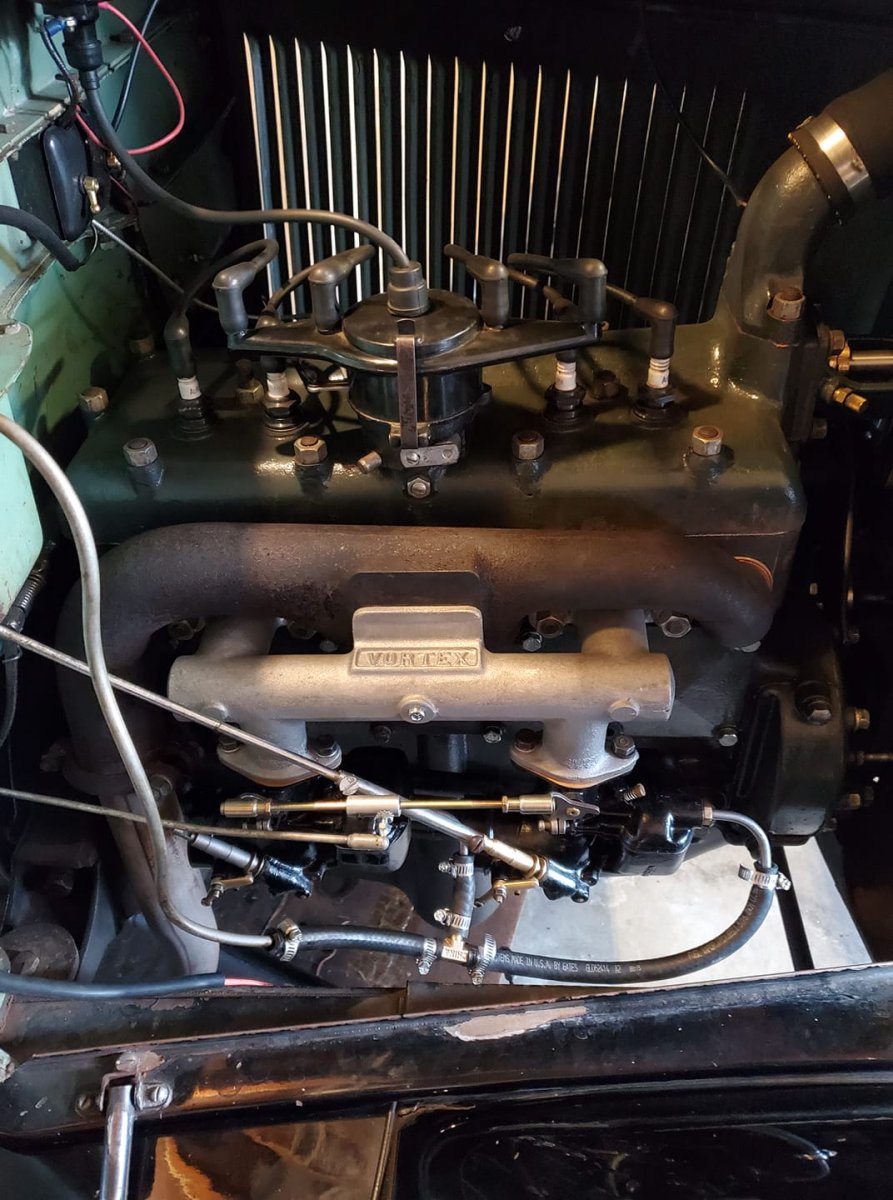

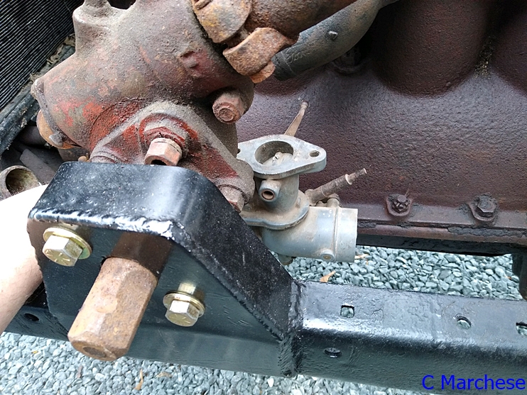

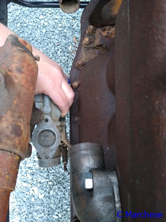

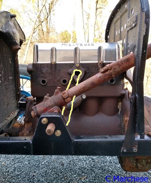

    Does any one see anything wrong with mounting my Model A carb way down by the framerail and making an intake tube going all the way up to my Frontenac head? The reality is the height is probably 5" - 6" higher than a stock model T carb that sits in about the same proximity height wise near the frame. Space is kind of at a premium on this side of the engine so not much choices here. I was trying to stay away from using a fuel pump and mounting the carb higher to keep it more traditional. Just wondering what the thoughts on a long intake tract like that might do performance wise.

    I don't have anything in my experience that could say good or bad. But thinking about it, I don't know why not especially if you don't want to pressure feed it other than gravity. One way to find out
    Linkage will be fun

    Hi guitarguy: I have posted two pictures.... one picture is of a 1918 Model T with a Rajo 4 Valve that now belongs to winduptoy. I ended up with two NH carbs, a 6 volt fuel pump and a Holley pressure regulator.
    The next picture is one of my attempts to locate a Model A carb low enough in order not to run a pump. The intake is a Winfield intake flipped upside down and added a tube to allow gravity to supply fuel to carb.
    This did work, however while driving the engine started to loose power and would shut off. Coast to the side of the road and check under the hood. There was a liquid coming out of the carb, thinking it was a float problem I turned off the fuel. It turned out to be mostly water.
    Long story short the intake tube had a lot of frost on the outside, and there is enough frost to close up the intake tube and shut off the engine. Once some of the engine heat warmed the intake and all the frost melted I started the car and drove home and water once again ran out of the carb.
    You can draw air/fuel that far but without carb heat you may run into problems. Gary in MN DSC00910.JPG DSC01593 (1024x576).jpg

    my only question is : will it be able to draw sufficient air (updraft) .

    I thought that may happen Gary in MN. I have seen copper pipes coiled around manifolds to warm with engine coolant.

    @Gary in MN , First off, THANK YOU for the great reply. I was wondering about the ice factor myself, as my stock T's will ice over without the heat shield intake in place. I guess I can hide an electric pump easy enough somewhere and run a carb up by the inlet of the head like I see so many used to--and still do. I wonder what they used to do for pumps way back when though. I know there were vacuum cans but I cant imagine everyone ran those. I know that had hand pumps---but wold it really push fuel up hill fairly consistently? Were there small electric pumps back then? I'm really trying my best to keep it 1935-ish era on the build.
    @V4F I too was wondering about the flow dynamics of the tube.
    I appreciate any input, You all are the best, but don't think I gave this zero thought before posting. I like to reach an unreasonable conclusion before I post such non-sense and asking crazy questions.
