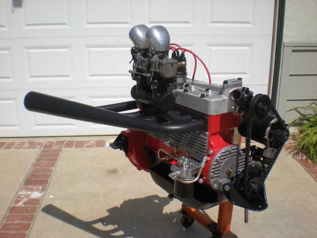

    Nice looking engine.

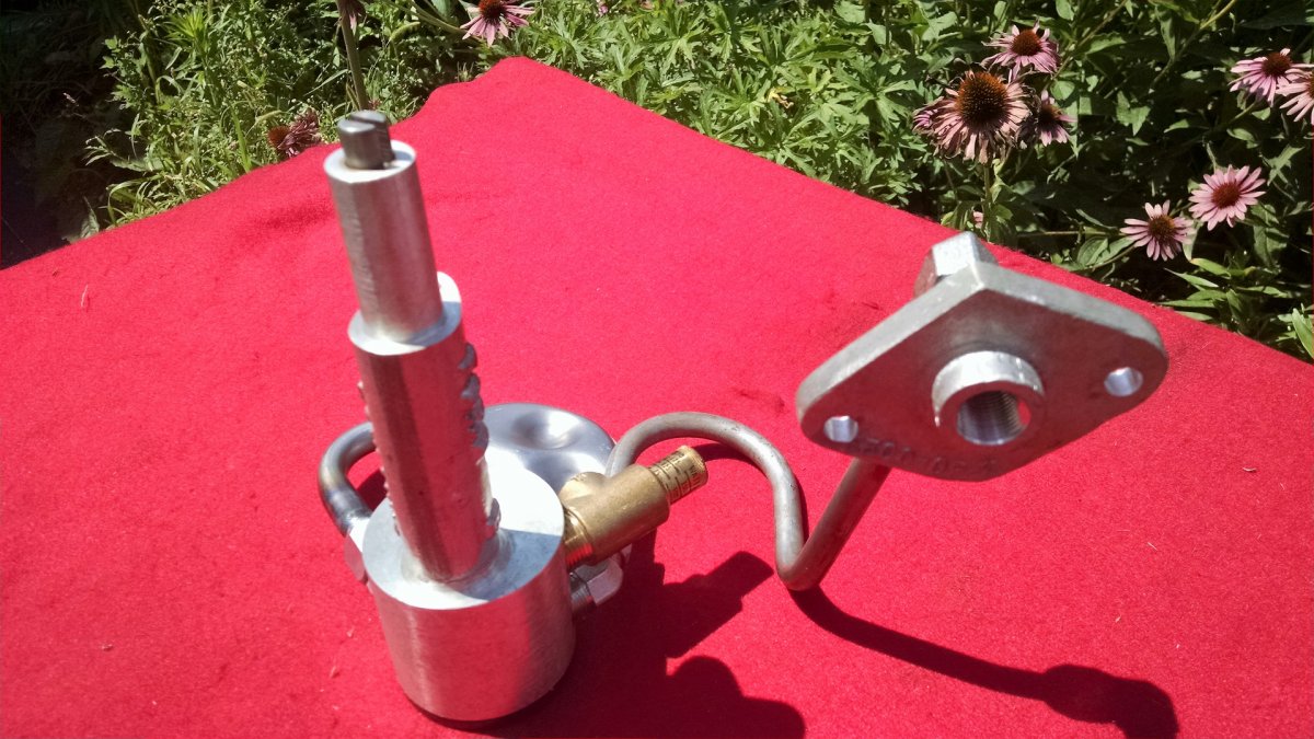

    This is a pump that I put together with the inlet on the bottom plate, like CAT does their pumps. It has early V8 pump gears, hence the spacer and the relief tapped into the pump. I used a 90 degree street ellbow and the pressure relief is a 35# from McMaster Carr for an air compressor. IMG_20180415_144649922.jpg

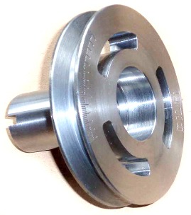

    i have had several pulleys brake . ive tried a lot of ways to keep it tight (2 piece) . solution was this pulley ........... steve pulley.jpg

    Is that Yapp’s?

    yes it is . right now i have a new 2 piece on & it is already loose ................... good insurance ........

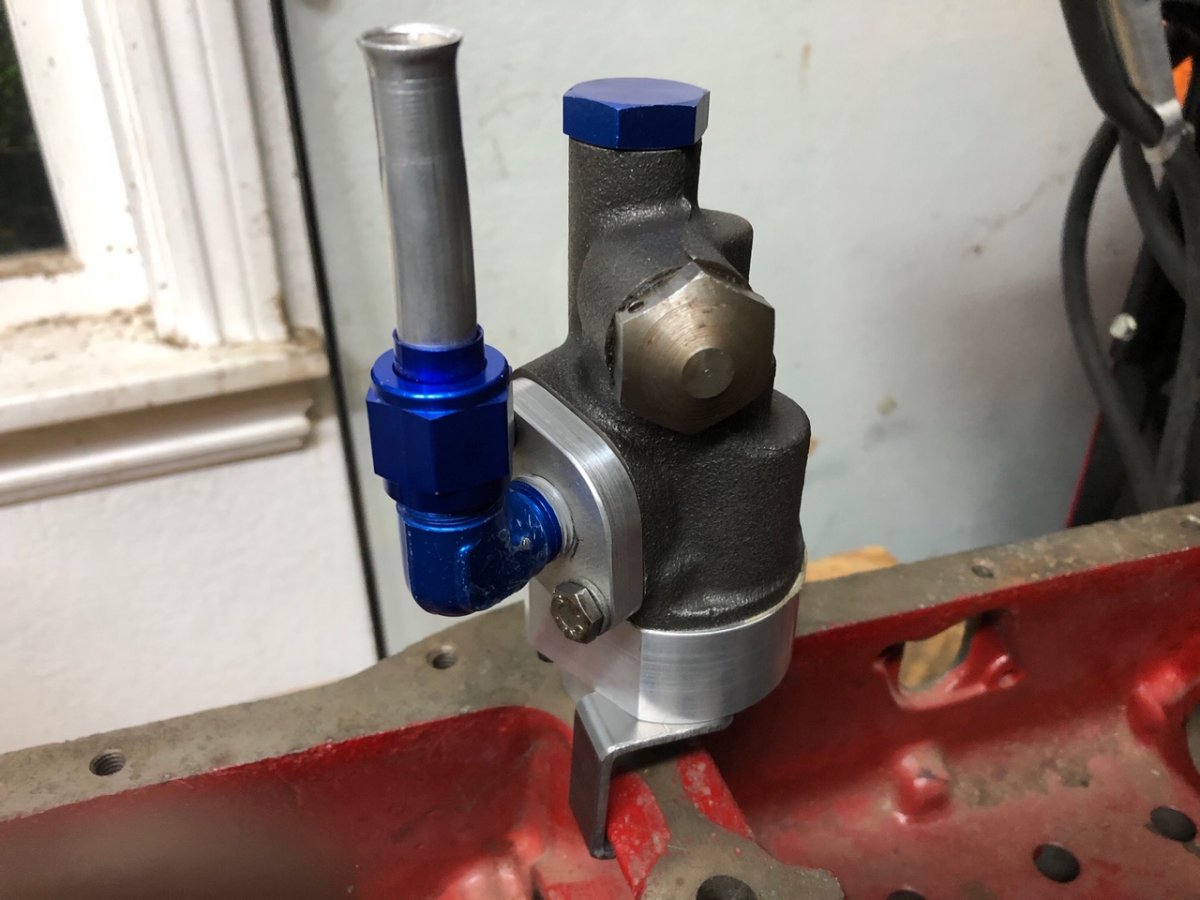

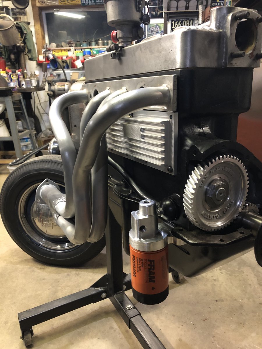

    18DD8A08-DA9A-461F-BEF1-0BCF9E657BBE.jpeg Has any one had issues with this type of adjustable oil pressure relief valve ? My engine guy is very thorough in examining every component to the Nth detail . He was concerned as they are fitted with neoprene seals which are good to 180 degrees, when under load oil could see 230 or 240 , he went to the web site of the seal manufacture and I believe he asked them directly what temperature the seals are designed to run at . I cant get to see it right now as of course it’s lockdown , he was talking about the possibility of fitting a Chrysler 440 external relief and filter. The Chrysler one looks like it belongs.
    winduptoy likes this.
  11. Crazydaddyo
    Joined: Apr 6, 2008
    Posts: 3,190
    Crazydaddyo
    If that is the unit that Dan Price sells, I am using one. The engine has a broken crank in it now. But not because of the pump. I have not had any issues with it when it was running.
    If you have concerns about it, email Dan and ask. Maybe the seals are made of a material that can withstand higher temps. Maybe they are Viton and not neoprene.

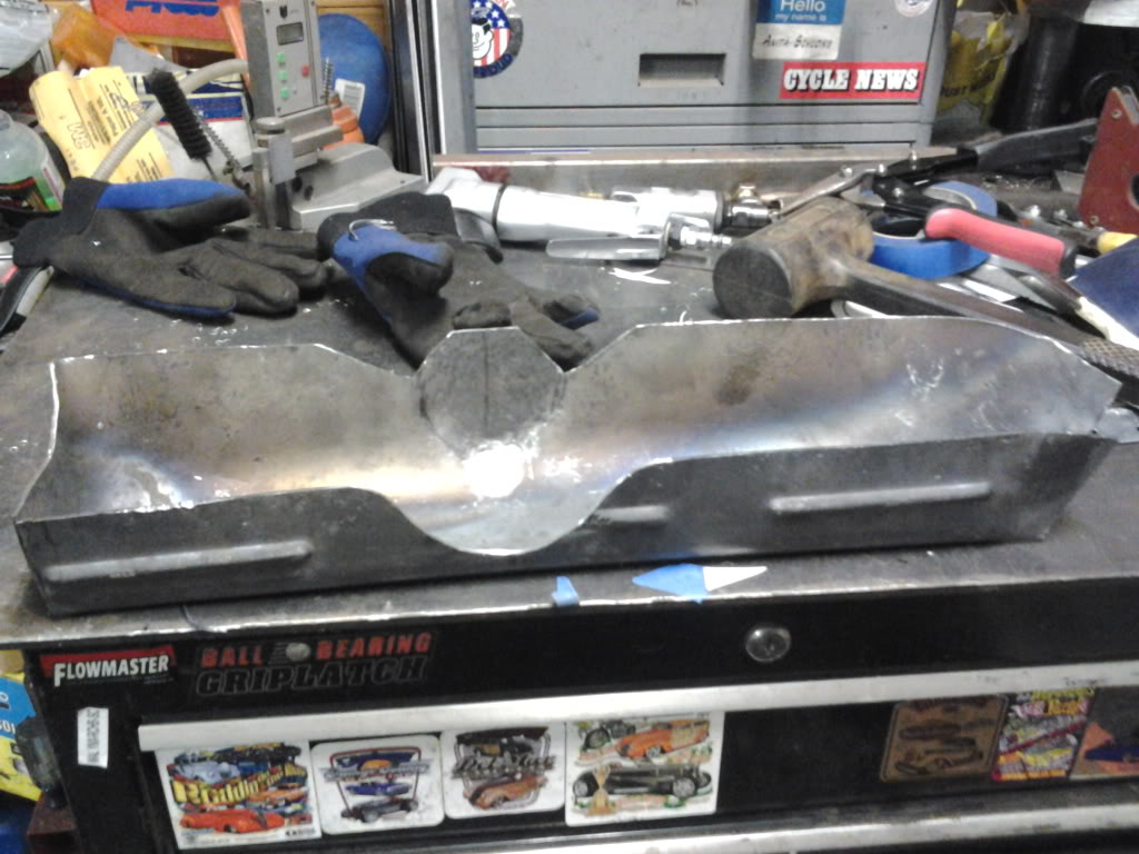

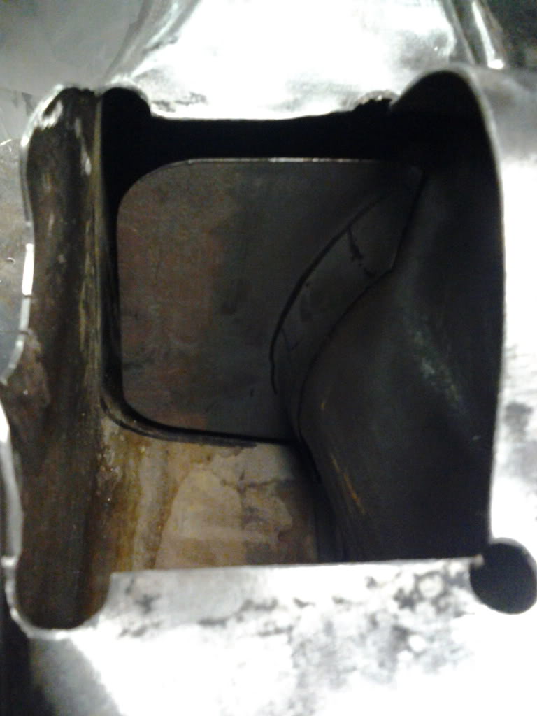

  19. After near disastrous results with V8 type pumps and an aftermarket pump made by Dan Price; I came up with a solution that lets me run fast and hard, including Hi-G turns. We took a stock B pan and cut off virtually the whole lower half. We isolated the crankcase with a solid horizontal baffle with deflectors taking oil off the thrust side of the crank and into the sump below. In the sump we installed a GM style pick up with vortex shield. In the sump we trap and remove infused air for between 5 and 7 quarts of oil . We figure that because oil will not move up a vertical side by more that 45 degrees; it cannot get back up into the fast spinning crank (thus more power)! A bung is in the lower side of the sump; and a fixture installed to a flexible (aircraft) line to the external single stage pump. The pump is adjustable (I have it set to 60 psi); and is driven by a Gilmer Belt off the nose of the crank. From the pump a line goes to a one quart filter; then to two smaller lines to each end of the engines oil gallery. I must emphasize that using solid lines for oil and fuel in high vibration applications is asking for trouble.
  20. GuyW
    Joined: Feb 23, 2007
    Posts: 555
    GuyW
    Old Dawg: do you have any pics of that pan?

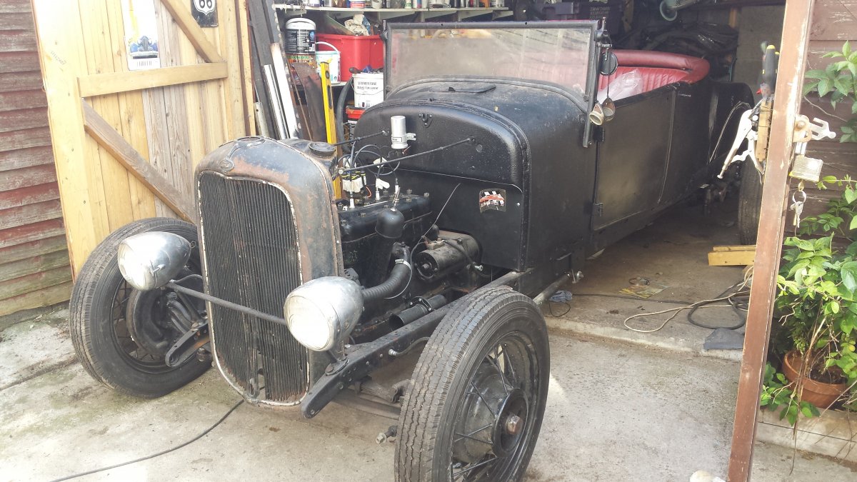

    Here's my banger powered 27 or under powered T. It's only got the 14.9hp engine but it will get me going for now. Still lots do to. I think the timing is off. Lots about timing model As out there. Anyone got any tips for the B . it will tick over but backfires and stalls when I try to rev. thanks in advance. Murf 20200423_161723.jpg

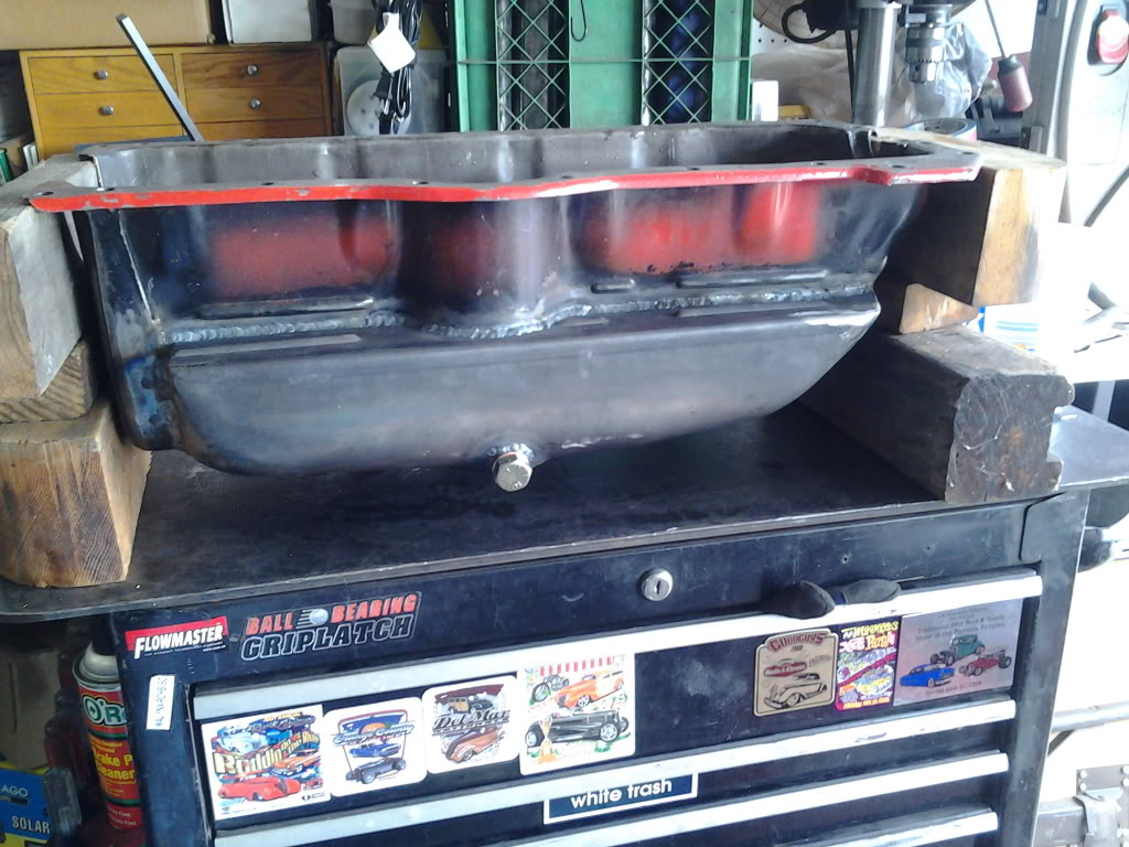

    I noticed that I was loosing oil pressure when going around long sweeping right hand turns. I couldn't go deeper with my pan because of ground clearance issues. So I went sideways with a bump out on the right side of the stock pan. I also added extensions to the stock pan baffles and added some hinges to allow oil to move when I wanted it to, and keep it around the pump as much as possible. The bump out was made from another pan and added a little more then a quart to the capacity.

    The B timing cover is different than the A. Did you static time it like the A using the pin in the timing cover?
    Are you running a B or an A dizzy?
    14.9hp should turn the tyres
  28. murf 32
    Joined: May 30, 2013
    Posts: 66
    murf 32
    Hi
    I static timed it. It's a complete engine that came out of my B. I put a new modern type distributor cap on it as it was missing. I'm sure it's just something silly. But annoying. It did seam to run fine when I tested it before putting it on the car. Cheers
