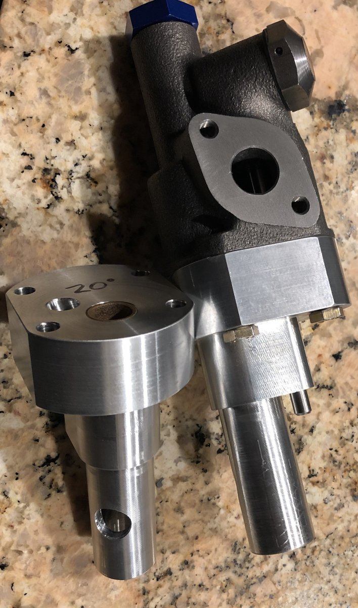

    If you are going full pressure oiling system make sure to have some sort of pressure relief.
    It has been common to use an external relief or a modified V8 pump with internal relief.
    I made these for my own motors.
    burl, Old Dawg, Crazydaddyo and 3 others like this.

    I like the way you reversed the flow by turning it upside down. Does it come out to be the same length as a A pump?
    Crazydaddyo and winduptoy like this.

    Thanks, reversed it works well
    no, it is shorter than "A" pump, it gets an extension out of the blue cap that is adjustable to hold it up in the block.
    I also use an aluminum tube that I can put in the pan strategically placed.
    Old Dawg and winduptoy like this.

    Is it held in place by a spring like the stock pump?
    What do you use for a pick up?
    Nice work.

    im using a "V-8" pump modified . preset inside . i run pretty sticky oil , when cold (steady 20#)
    when warm (25 - 27 #s) . held to block with a "distributor type" forked hold down . been running 8 yrs ...........
