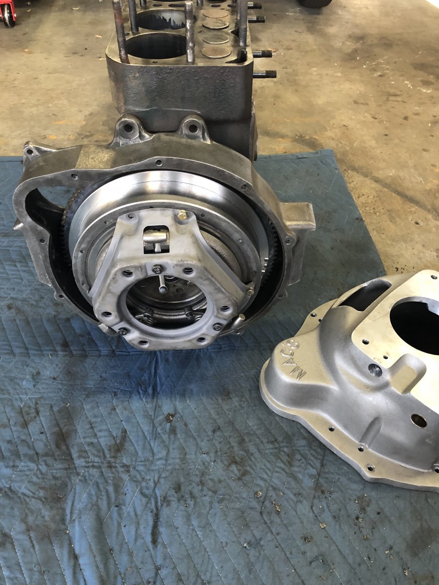

    JT1930 that is a nice bell housing..

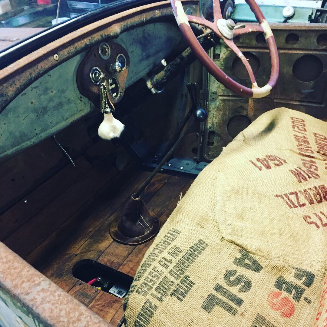

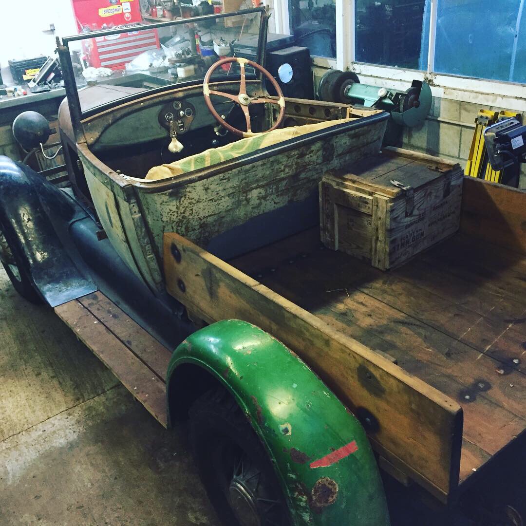

  2. My Roadster finally taking shape...2 years into it this month.

    @Nosetime your roadster is looking great. I see it on Instagram. Love it.

  5. @JT1930 Thanks, I appreciate that!

    nice bell housing !!!

    Thanks, appreciate it. Still a bit to do, but really enjoying working on something this old.

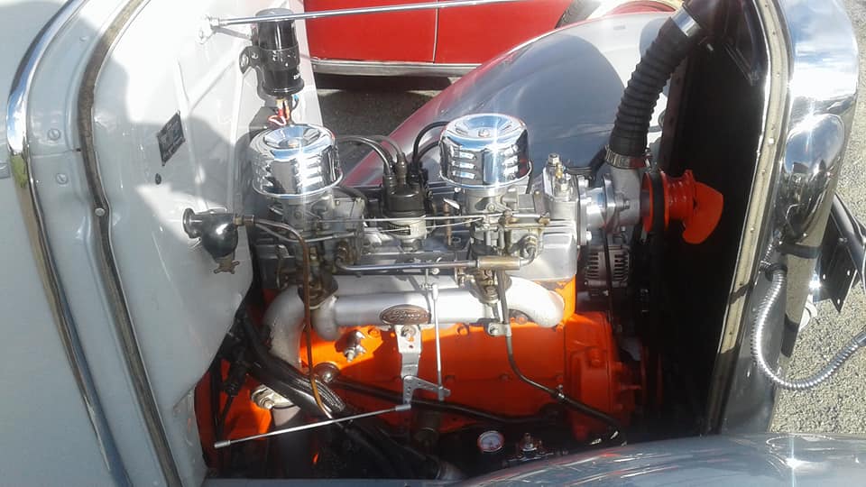

  11. Hi all, been a while since I’ve posted anything on the banger threads. One question what is the optimum cooling system for a twin Stromberg 97 equipped B engine running a Thomas head? I have a V8 water pump, 28 radiator, and an electric fan as no room for the fan off the water pump. Thanks, Greg
    Hi Greg, this is what I'm using, V8 pump with adapter and the fan/pulley from my orig. pump.

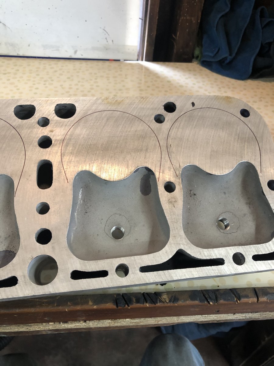

    Banger people...... in order to run a Winfield 6.1 head should you have it relieved a few thousandths ? What is minimum clearance between piston and head also. Pulling the silly putty out. Thank you.
    ** measured. .030 - .032 distance.

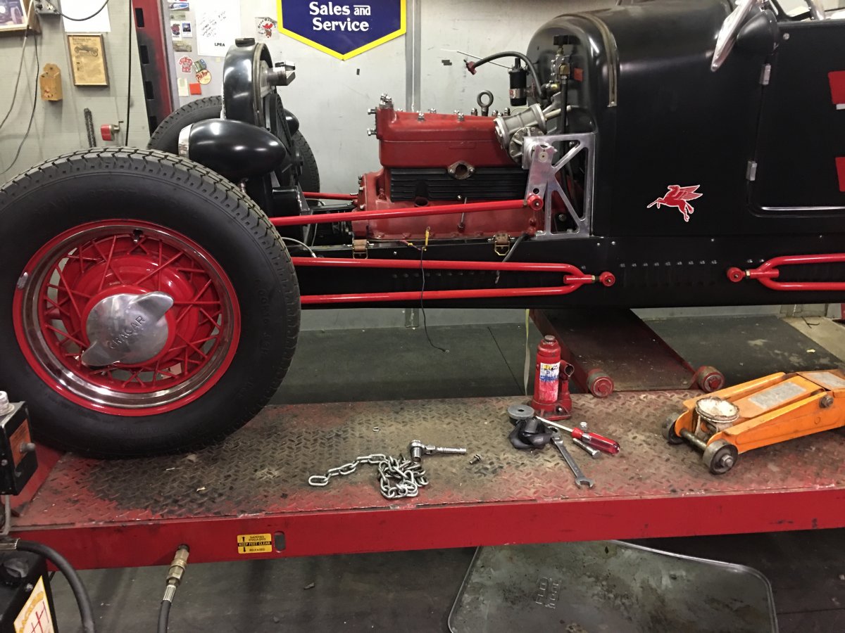

    Picked up my engine at Bert’s last week. Putting this engine in is easy.....until today! A 30 minute job took 2-1/2 hours. Can’t figure out why. Will button it up this week and test drive next weekend

    I have been running one of the repro crow's foot Winfield heads since 2009 with no counterbore, just flat. My pistons were about 0.040 above the deck, so I am figuring you will have more clearance than I have been running. I would recommend checking the fit of your head gasket carefully with this head; my gasket slightly overlaps the combustion chamber on the valve side on all four combustion chambers. Because of that overlap I have been installing the head gaskets with the crimp seam against the block so there is no chance of the seam being exposed in the combustion chamber. So far the gaskets have been able to survive even though they are slightly exposed. I have used both the Felpro copper and Best Brand gaskets successfully.
    When I purchased my head in 2008 this version was advertised as 6.8:1, so the compression may be higher than the 6:1 you reference in your post. I also subsequently had another 0.060 cut off the head to bump the compression and to reduce the footprint of the combustion chamber so that the head gasket fit better. Be careful of too much spark advance with this set-up, I broke two crankshafts before I learned I needed to limit total advance to about 24-26 degrees.

    @5280A2 Good to know. Thanks. And yes my pistons come out the hole around .040 since they are .060 oversized pistons. This was measured using a model a best gasket. Looked fine when place on the head. Nothing over lapped. I am going with a premium model B head gasket from Snyder’s. They are a bit thicker also. From what I’ve read .100 thick.

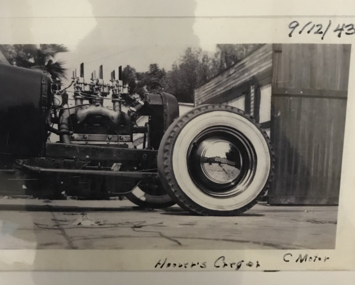

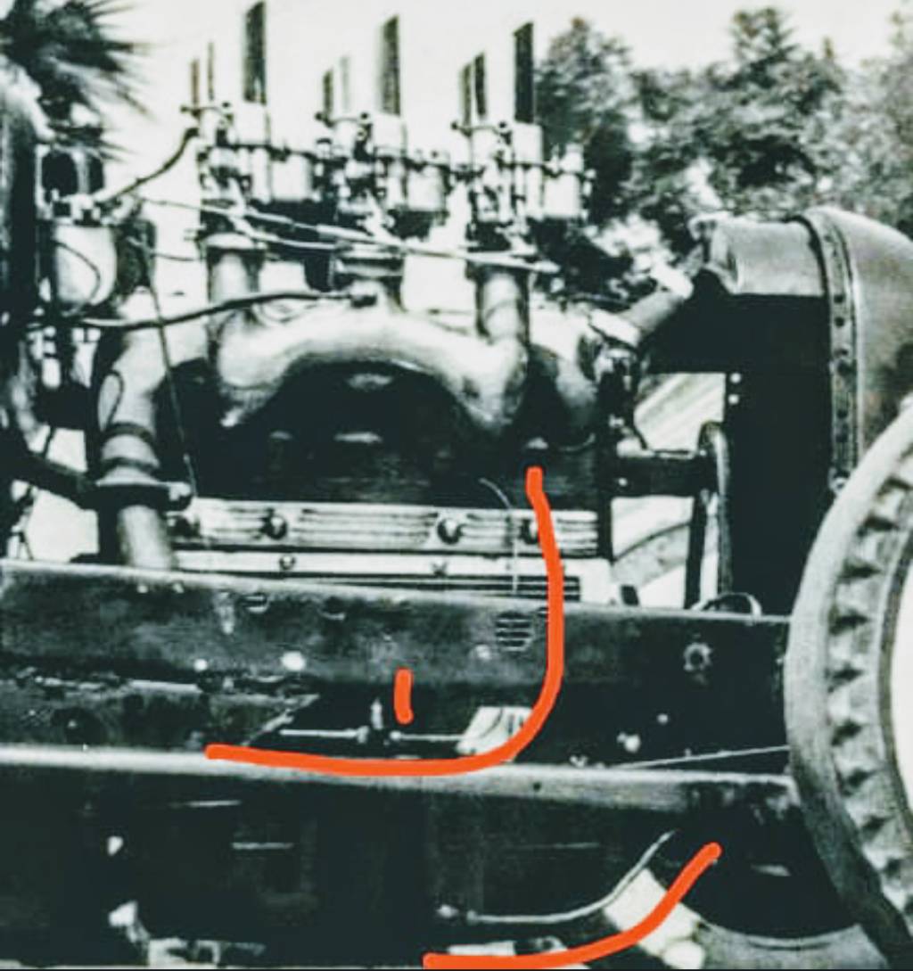

    760415E6-85B4-4069-BBE1-0A722609E50C.jpeg I bought this picture from a lady a few years ago. I've wondered if that line to the bottom of the pan is a return? Wish I could see more, there's some cool stuff going on there...

    Thanks ratamahata- I've got a pretty good idea of general pressurised layout. (In fact I'm building a system using G. Riley's instructions right now).but I don't recall a return to the bottom of the pump area.
