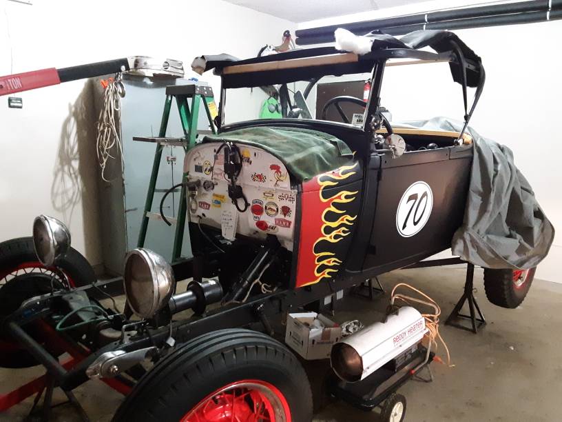

    Hoping to get mine running by the end of May. Its been a long slow process. IMG_3595.jpg

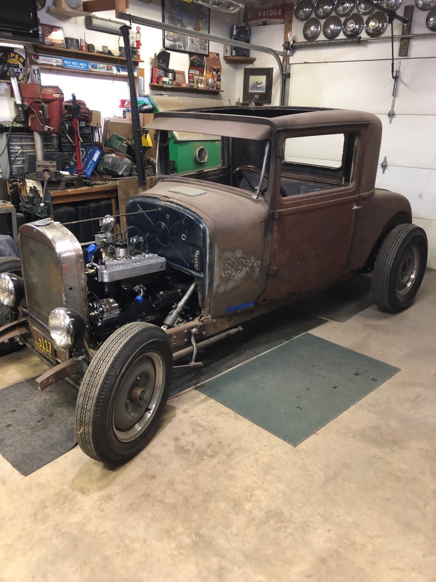

    checking for the new month getting closer to getting this pile running and driving db.jpg

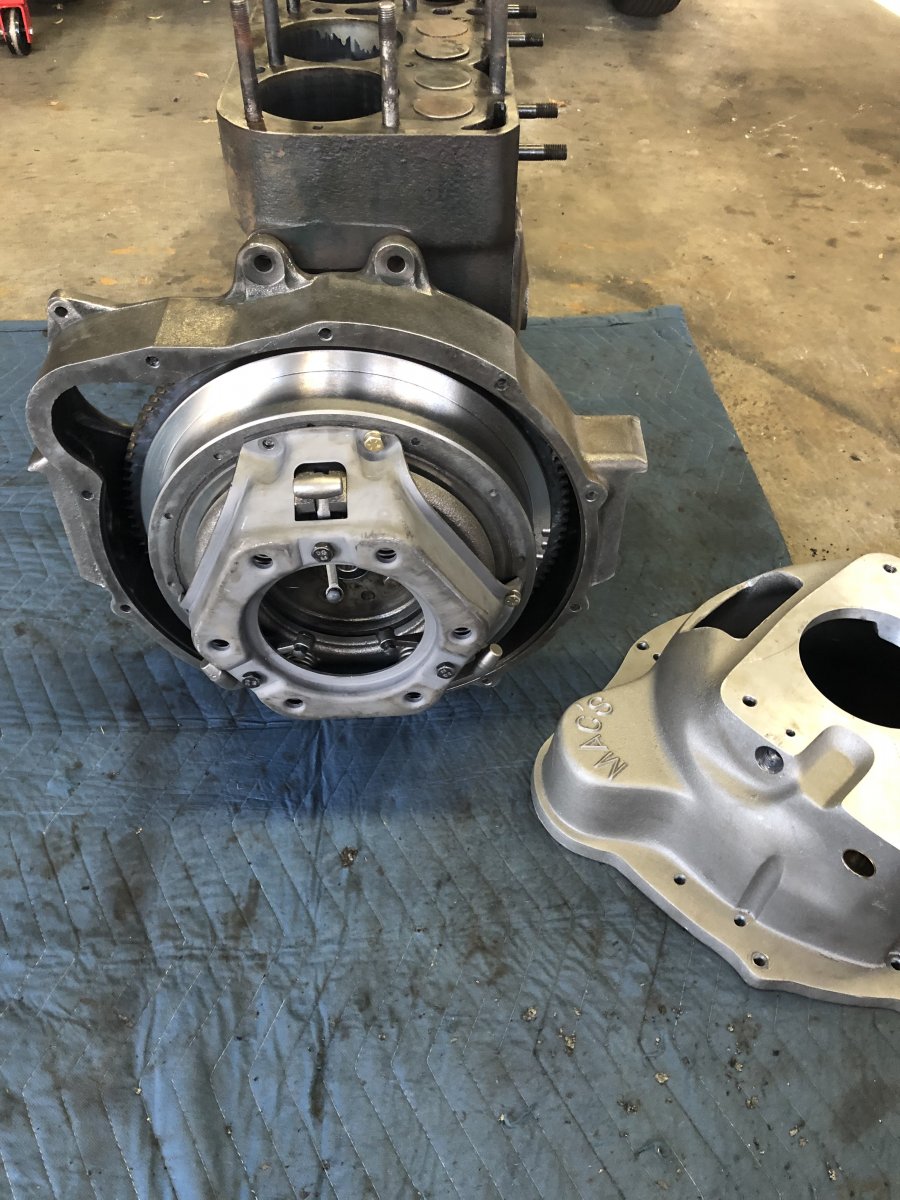

    Here’s something bad...... And here’s something good...... It would figure Snyder’s doesn’t have another babbitted .020 rod to replace this one that’s destroyed. Got one of their lightened v8 but had to have the flywheel turned down more to fit in this damn bellhousing.
    06A79BAE-1596-4EA6-8503-C1235D232BE4.jpeg 2584E1D6-52A2-4BFD-BAF6-46D508CFD995.jpeg

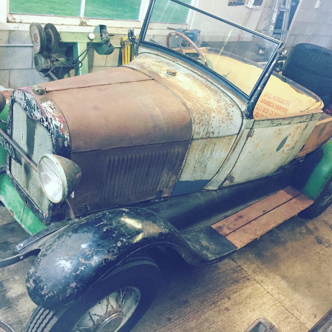

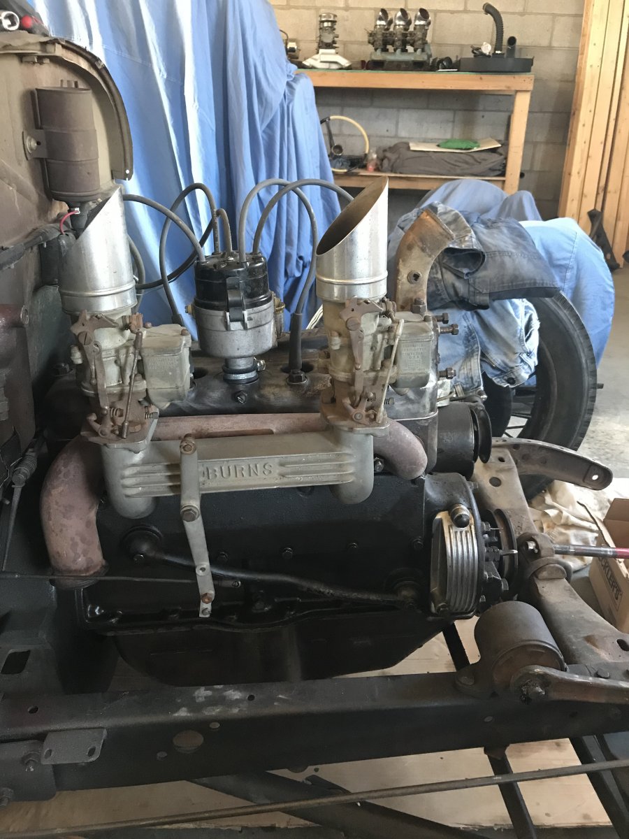

    Been lurking around here a while, so thought I would check in from Invercargill New Zealand. 5AEC7CE3-837F-4AFA-80AD-FAA2B0BF8D8D.jpg 4E223513-C405-4921-8F89-DA6CF64D097D.jpg E0DCD778-EDDD-4088-964F-555151BD73F0.jpg

    JT1930 what bell housing are you using ?

    @JT1930 What was part of the clutch was hitting the bellhousing ? Or do you mean the flywheel was hitting as there isn’t much you can take off a clutch. Its more likely the aftermarket adapter casting is heavier than original.

    @Big John M its Mac’s bellhousing. Nice piece btw.
    @Kiwi 4d sorry. The flywheel is what I meant. After facing it flat to put the v8 pressure plate on I had to get the flywheel turned So it would be a smaller diameter to fit in the housing.

    Its Nice to see Graeme at Macs speed has an inspection hole in the top of the adapter.
    On his V8 ones he does not and if when the clutch push rod is disconnected and falls back the fingers can and do slip off the recess in the throw out bearing and are near impossible to get back on. So the first thing I do is get out the hole saw and put a 2 3/4” hole right there.
