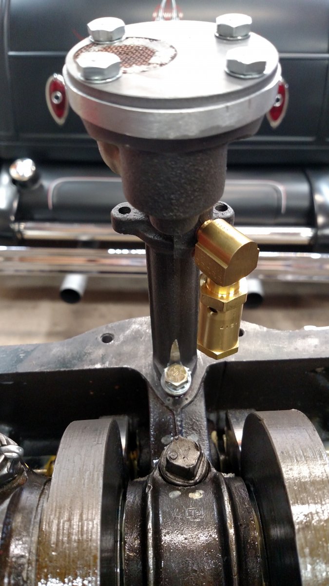

    John got it right. I replied earlier but it didn't post???? was on my mobile device so lets try this
    The relief is set to open at 52 psig and close at 45
    The pump is a Model A pump fit with V8 pump gears, not a modified V8 pump to fit an A.
    Less machine work and the kind that I am capable of.
    The V8 gears from the '36-'48 are the same diameter as the A gears and fit in the A pump case.
    They are taller than the A gears=more volume, hence the spacer sandwiched between the pump body and end plate to accommodate them. Just another way to skin the cat
    Like your engine and see what you did to pressurize the A or that is what I think I'm seeing

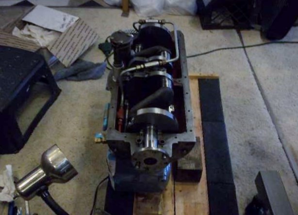

    Couple of questions surrounding the upgrading of oil systems on a model T.
    Rhetorical opener: Splash lube works great up until what rpm range? a wise gentlemen said about 3k rpm. Either way, planning on passing that number. Full pressure mains and rods, easy enough it seems. Have built 1 pressure main system, this time will have the crank drilled. The system was driven by a VW pump off the back of the cam. Going to go with a front driven, exterior mounted pump, off the front plate are. Planning on a side drive mag for ignition.
    This brings me to the problems of reducing all that splashing oil:
    1. How will the wrist pins get oil?
    2. How will the piston skirts get oil?
    3. How to get oil to the lifter valley?
    4. How to get oil to the cam bearings?
    5. How to get oil to the timing gears?
    Last motor:
    1. Oil pump driven off the back of the cam. Lost prime, turns out that I missed some spacers. Didn't like it anyways.
    2. Oil pick up at the bottom of the T pan, below flywheel.
    3. Oil pressure relief valve by pass was run straight to the timing gears, seemed logical.
    4. Camshaft: last engine, ran a cut down A cam straight in the T block with no bearings.
    5. Metric shit ton of fab and patience to get the oil line into the existing holes on the top of the bearings, rather than tap the bottom of the main caps for the oil feed in. Not easy, major PITA. Compression fittings everywhere.
    6. Babbitt.
    On a T motor, the rotating assembly, fly wheel and transmission all live in the same oil. So there will still be a lot of oil moving about.
    New motor:
    1. Insert bearings.
    2. Aux. deep sump with the oil pick up in the bottom, carefully baffled and a scraper/windage tray.
    3. Connector line between the bottom of the pan (flywheel) and the sump at the height of the low oil (~3") petcock to ensure there is always oil in the bottom of the pan to fling around to get the trans and provide a constant volume in the bottom of the sump to keep the pick up submerged.
    4. Front mounted oil pump w/ pick up from above sump.
    5. Where to take the oil from there and get it to the places that matter...
    Questions:
    1. What kind of pressure should I aim for?
    2. First stop is the mains, oil wedge probably will form better if feed comes in from the top and not the bottom. How important? Everyone seems to tap the main caps...but if everyone is jumping off a cliff, do you follow?
    3. After the mains are fed, should the cam come before or after the pressure relief?
    4. Sprayers for piston skirts?
    5. Aux. scavenge/storage tank, kinda like a dry sump system. Mount up high. Stupid idea?
    6. Solder or compression fittings?
    Thanks.

  20. Andrew Mccann
    Joined: Aug 2, 2016
    Posts: 240
    Andrew Mccann
    from Bristol UK
    Hats off for taking a T block that far.
    For me, the 3k limit was always to help protect the Babbitt not the limiting factor of the lubrication but if you’re running inserts then no problem.
    I think the T splash system is so effective with the flywheel there would be no need for full pressure
    What crank and rods will you use?
    What RPM are you after?

    winduptoy
    Yes it's upside down....
