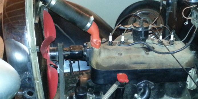

    Anyone know what type of water pump this is, trying to see if I can rebuild it? Tried to compare it to stock water pump but they seem different. Don't want to buy a leakless if I don't have to. The water pump doesn't leak but does squeal. The generator has been eliminated as a cause since it was changed out to an alternator and the water pump has already been greased.

    That's a old after market pump, one of the early ''leakless'' variety. Squealing is something inside that is running dry, perhaps the seal has finally on it's way to dying. Good pump when they worked, I always looked for them on junk engines. Take it apart and look it over. No parts--unless you make them, or or harvest from another pump of the same make---available.
    Bottom line is go with modern leakless.

    That's the exact info I needed. Thank you!
  17. Snyders makes a nice one that's leak less and greaseless with a modern seal. I run one of these. After having rebuilt two cherry housings and have them only last a few 100 miles. I wish I would have just bought the Snyders pump to begin with.
