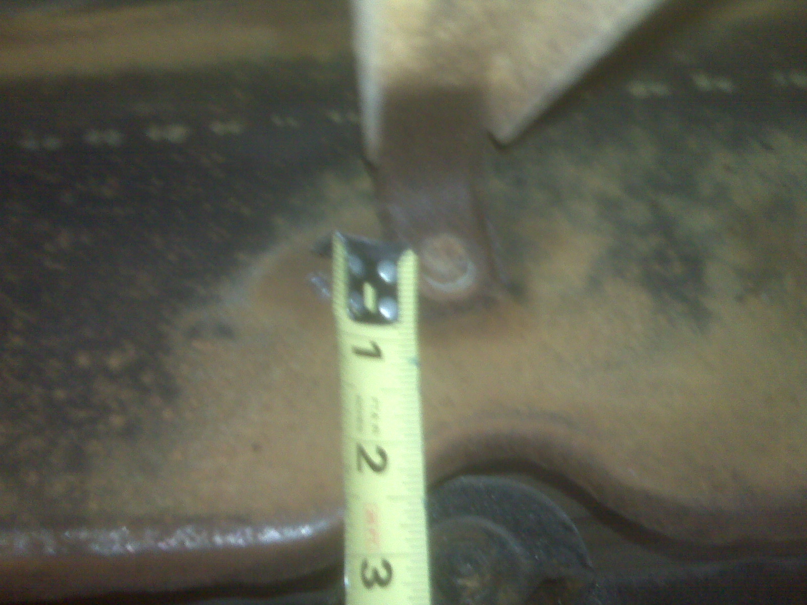

    heres a pic i took of mine, sorry about cell phone pic. also the short side of the bracket goes on towards the frame and the long on the fender. hope this helps
