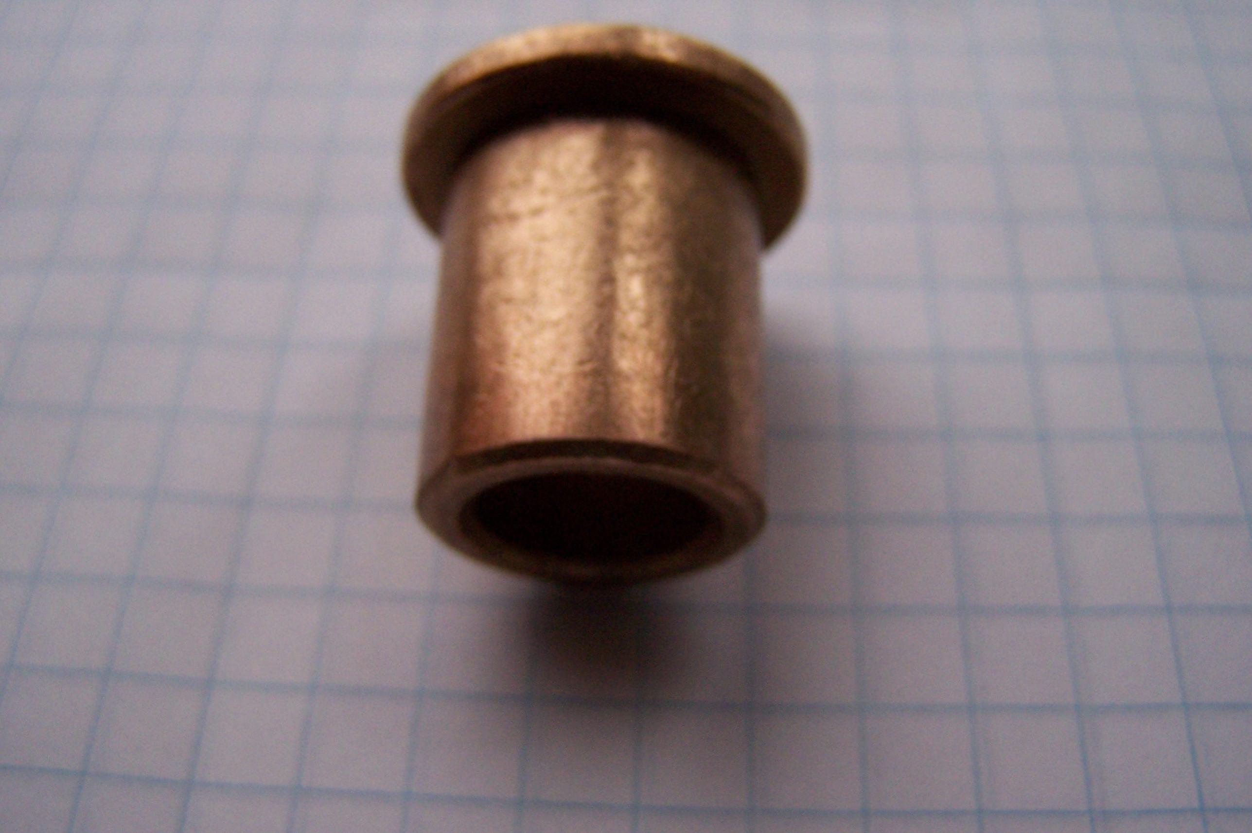

    I was thinking of machining some bronze bushings to replace the standard nylon bushing used in the leaf spring eye's and shackles.........Was wondering if that would be better and more positive w/ less movement since I will be drag racing the Henry J?........Anyone do this and race ?.....good idea or bad.........I have some nice bronze stock to carve up......Thanks, Littleman Dave

    For anyone else who needs these bushings ....
    1" wide x 1" flange ( 1/8 " thick ) x 3/4" x 1/2 " hole.
    Got ours from BEARING DISTRIBUTORS INC.
    Part number ISO EF 081216.
