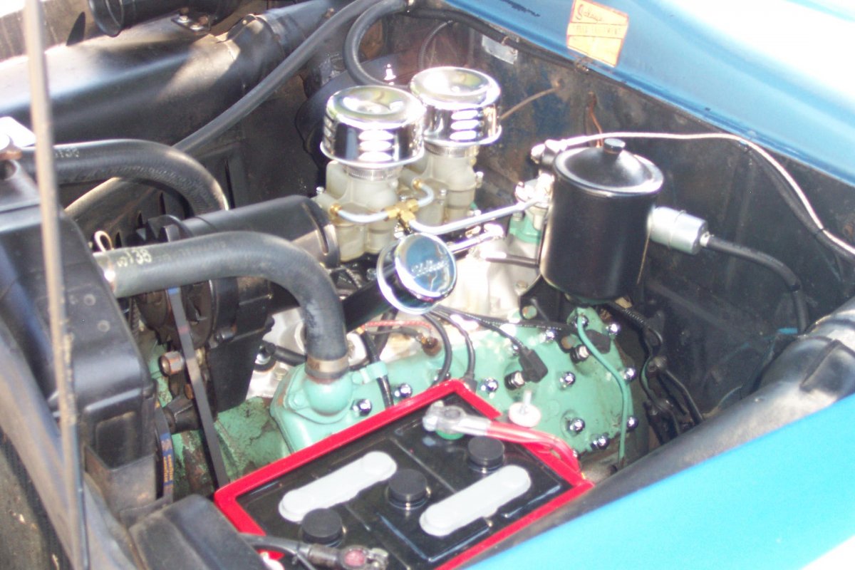

    The AGM batteries are lead/acid, absorbed in glass mat so they won't leak, but will still produce gas if overcharged, so should be vented just like a normal lead/acid battery. I've had really good service with Optimas; 12 years with my first 6V, and over 14 with a 12V red top.
    Optimas can be disguised. Below is a 6V Optima in my '51.

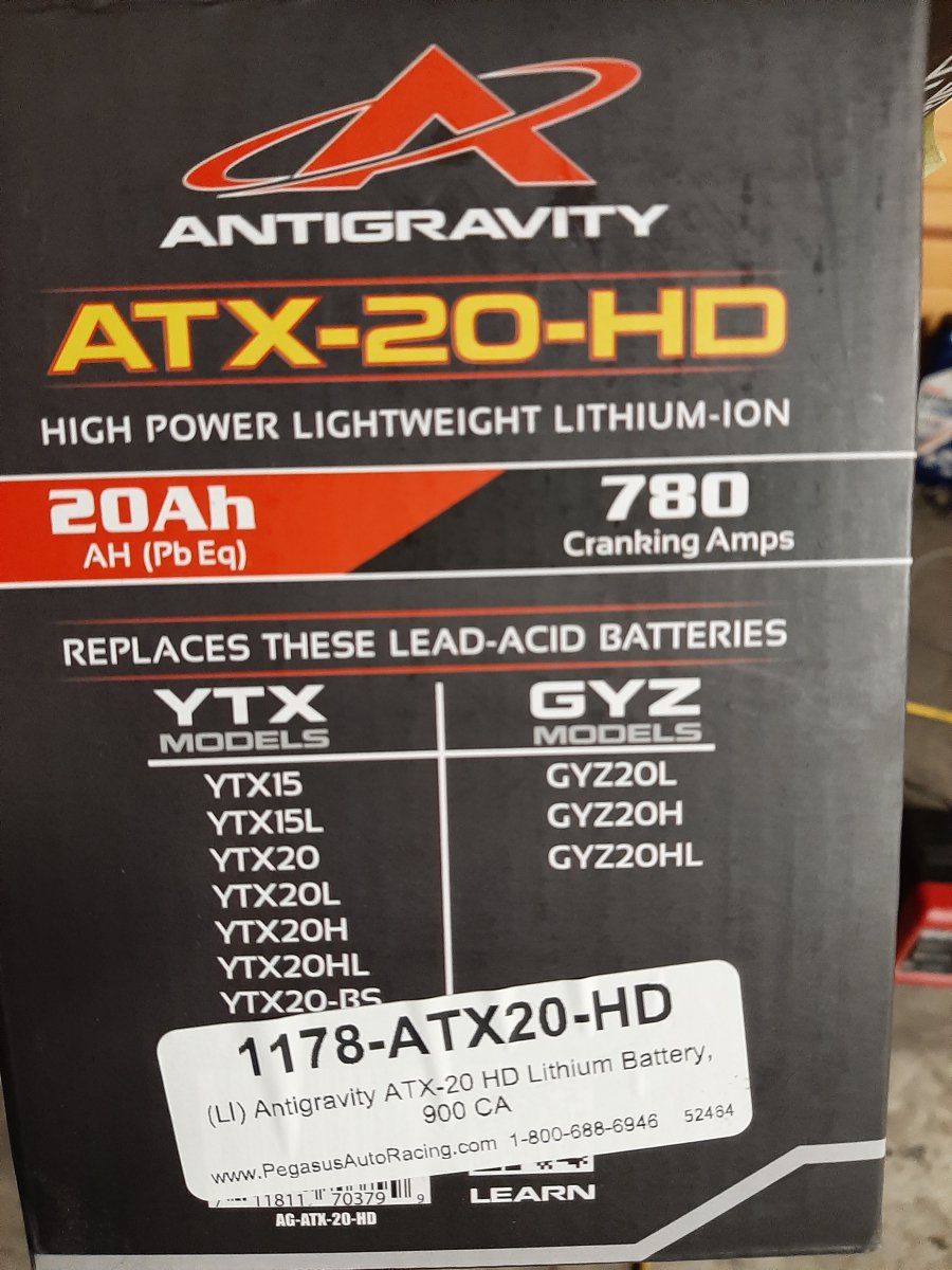

  25. 20200412_193345.jpg I go to the performance racing industry show every year. Last year I made a point of talking to every lithium ion battery manufacturer there.
    Not all of them are the same. The better ones have a computer in them that prevents under charge and over charging. Both issues can harm them. It was stated by each of them to use a charger designed for them. No more than 10 amps.
    I bought a anti gravity 780 amp unit. It's only 7lbs and can be mounted in any fashion. I also bought their charger. They have a cool battery monitor that after downloading their free ap i can see my batteries state of charge from my phone. It also has a start test I can perform through my phone. The battery can be jump started as long as the voltage is above ten amps. A conventional battery charger can be used with caution. No more than a ten amp charge and it must be disconnected when a full charge is reached. I just bought this so I don't have much experience with it. It does start my blown 498 ci hemi with ease. The size of the battery will determine the reserve it has.
    The cheaper batteries wont have the over/ under charge protection. I hope this helps.
