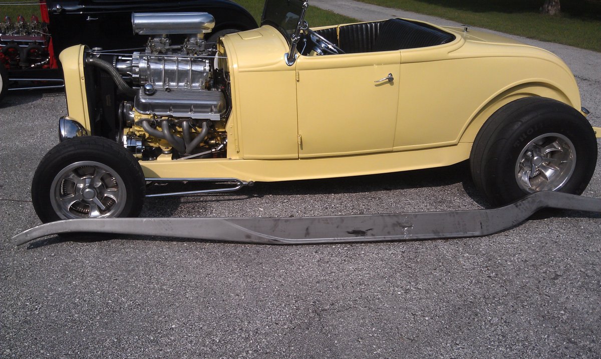

  11. I've got a pair of the Gearhead rails in my frame jig right now. Took about 5 or 6 hours to jig in place which is not bad which included some changes to the jig over the last frame I did. I tacked the front cross member in place tonight. It pretty much fell onto all the stations in the jig. This one will be for a pals street rod highboy tupperware car. It will take a little tweak here and there as I go. All the supplied parts look good. I have no idea who they buy from but they look pretty good.
    We picked this "kit" and a set of rails and a front cross member up at Nats North. The pair of rails and a front cross member were $450. I will be doing a frame for a '29 roadster pick-up high boy using a lot of left over stuff from inventory.

    How are the top and bottom flanges? Are the dead straight, or do they need some or a lot of tweaking, like most do? Hope you are going to post some build pic's.

    I think something like this might be great for a guy building a T or A that would need a lot of re-curving anyway. Just as long as both sides match each other. But before I'd use one on a '32 I'd need some more confirmation that the dimensions are correct.
    How's the radius of the top/bottom flanges to the side? That's one of the easy giveaways to a repro frame.
  16. Radius top and bottom look okay but I don't have any radius gauges to check with. Both rails were the same length. Spreader bar holes were the right size and places. The top flanges aren't dead straight but it won't be hard to fix the portion where the engine sets. Bottom looks pretty good. Look at a set the next show you go to.
    I deem them acceptable but I'm not building a restored dead-nuts Henry Ford "perfect" car nor is my pal. The rails fit my jig with an acceptable amount of push and pull. The front cross member went in place with about 7 degrees of caster. I'm good to go. I'll take a couple prints this weekend when I get back out there.
    The last time I sighted a great set of Henry '32 rails at any price in this part of my world was in my youth - admittedly a good number of years ago.

  28. So, I finished the perimeter frame using the Gearhead rails and parts.
    In general it fit my jig well. The steel welded fine with no snap, crackle or pops. Dimensionally it had a few minor problems - the pass rear rail was about 1/8" high at the very end and was corrected with a slice down through the kick-up and a re-weld - a few of the body mount holes on the passenger side had to be moved in about 3/16" - the drivers side upper rail was about 1/4" wide over most of it's length and that was corrected with a reciprocating saw and a grinder. Maybe an hour tops.
    The draw marks on the top of the rails dressed off with a 36 grit disc - no big deal.
    I stuck my rails in and they were fine on width of the upper and lower rails and I had to correct the same high end on the passenger side.
    Not withstanding the concerns some have over the possible metallurgy I would use them again unless some sort of proof presents itself.
