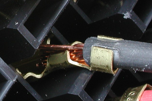

  8. I have a brand new E-Z Wire kit in my garage right now. It's there because they sent it to my customer to replace the defective one currently in his '37 Ford sedan.
    Whilst looking it over to find the wire that was causing the problems in his installed kit, I moved the harness and, lo and behold, strands of wires started popping out of the crimp just like they did in his installed harness.
    Here's a shot. This is typical of the poor quality found in E-Z Wire kits.
    Does the phrase "product liability lawsuit waiting to happen" mean ANYTHING or will you guys keep using these things because "the price is right".

  18. This kit needs NO manhandling to come apart. Normal road vibration will do it.
    The crimp they use is TOO SMALL FOR THE WIRE. The crimp boesn't roll over into an inverted "w" shape and capture EVERY wire strand. The crimp doesn't even close up.
    EVERY KIT THEY MAKE IS LIKE THIS.
    BTW, I understand these kits are assembled offshore.
    Painless, Centech and American Autowire make good quality kits.
    You get what you pay for

  21. He's right about the loose joints. I had some loose in mine. Just went through and recrimped them before I assembled it all. No problems after that.
  22. Yes, soldering is ok IF you don't let the solder wick up into the wire itself and make it brittle. That's what I'm going to have to resort to when I put this kit into the cutomer's '37 to replace the defective one. i.e. solder every pre-crimped connection and to do that, I have to disassemble the fuse box to get at the crimps.

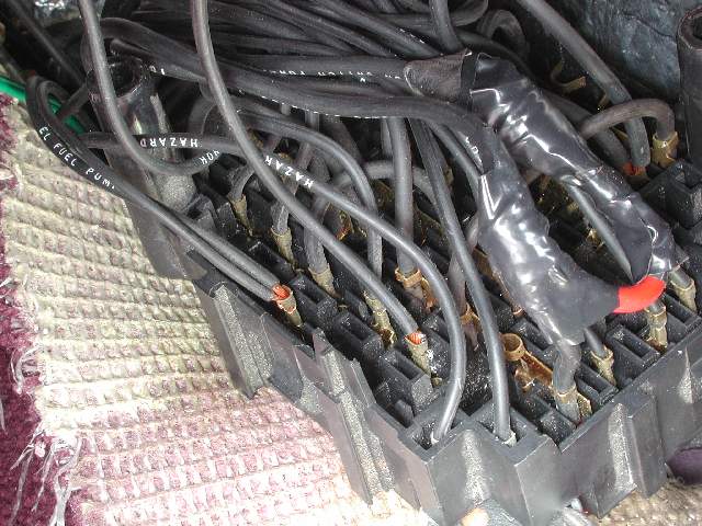

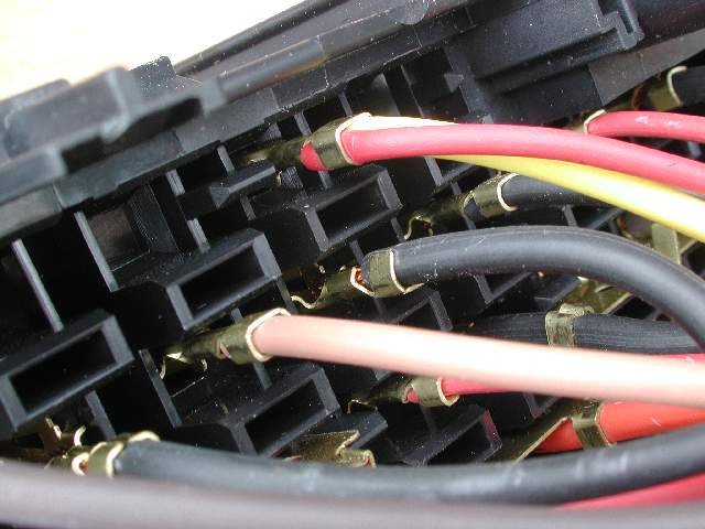

  26. Friend of a friend phones.
    "My car won't run"
    He has it ramp trucked to my place one Saturday. Says he has a "new" E-Z Wire kit they sent him when he complained about numerous wiring problems in his car.
    I drop what I'm doing and figure out that there's no power going to the ignition switch. Chase the black wires back to the fuse panel and it's got a loose connection on the ignition switch supply wire where it's crimped to the buss bar.
    I remove the insulation on it and the adjacent battery feed wire from the solenoid, solder a jumper across it and tape everything up.
    The engine fires but the harness heats up when the AC is switched on. Recommend he refrain from using the AC as it's wired THROUGH the ignition switch and is overloading it.
    Send him on his way as I had to get pack to painting my car for the Nats.
    Couple of days later he phones up. His power windows don't work and he needs to be able to run 'em up and down if he's going to drive from Mass to Louisville and back.
    He drives it back down the following Saturday and brings the new harness, too.
    I cut a few wire ties so I can get a better look at the back of the fuse box and some of the rest of the harness. Find a few more bad crimps so I open up his new kit to show him what I’m finding and lo and behold, the new kit (this one’s got the colored wires) has the very same wires falling out of the crimps.
    THAT’S when I decided to shoot some photos for my new book. (Yea, I’m writing a sequel).
    I’m to re-wire the car this winter AFTER disassembling the fuse box and re-crimping and/or soldering the offending crimps.
    Here’s a shot of the fuse box that’s currently in the car (black wires Check out the crimp quality. The insulation isn’t even captured in the crimps.) and the new box before the wire fell out of the crimp when I moved the harness to get a tighter shot of the crimp quality.
