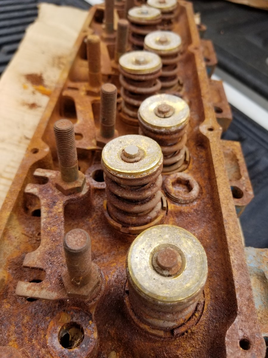

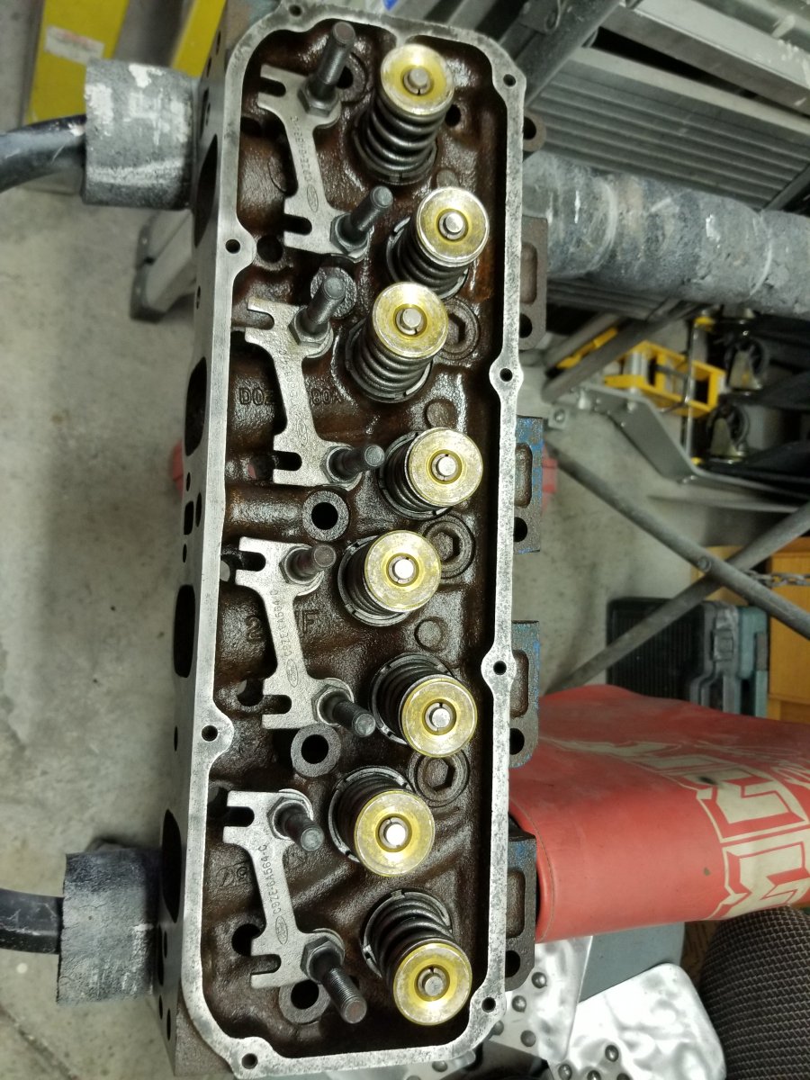

    I drop smaller hardware into a vinegar bath. Leave it there for a day or two. Pull it out and drop into a soda bath for a little bit to neutralize the vinegar. Then I hit it with a wire brush in my bench grinder and then spritz with marvel mystery oil. Got a pair of boss 302 heads that looked bad when I first got them. First photo is how they were when I started. The second photo show it afterwards.
    kidcampbell71 likes this.
