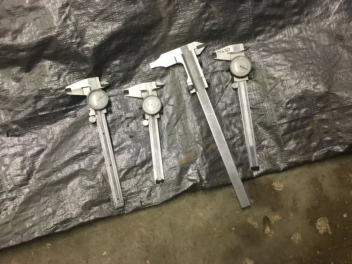

    That has always been kind of a debate, the “ feel” of feeler gauges, hence the name. But tight, too tight, not tight enough.... usually will get you in the ball park and is usually close enough on rocker arms on most engines.
    Here’s some of my calipers, not all, but I’m in the process of reorganizing my shop and can’t find everything right now! Lol
    PS: feeler gauges can “ wear out” using them on a running engine. I personally prefer to set the valves on an engine static, but a lot of old timers used to set the valves running.
    PS: one thing I like about the Vernier calipers is they can be inch and metric at the same time! Dials can’t do that, but I guess digitals can.... never use one.
    Bones

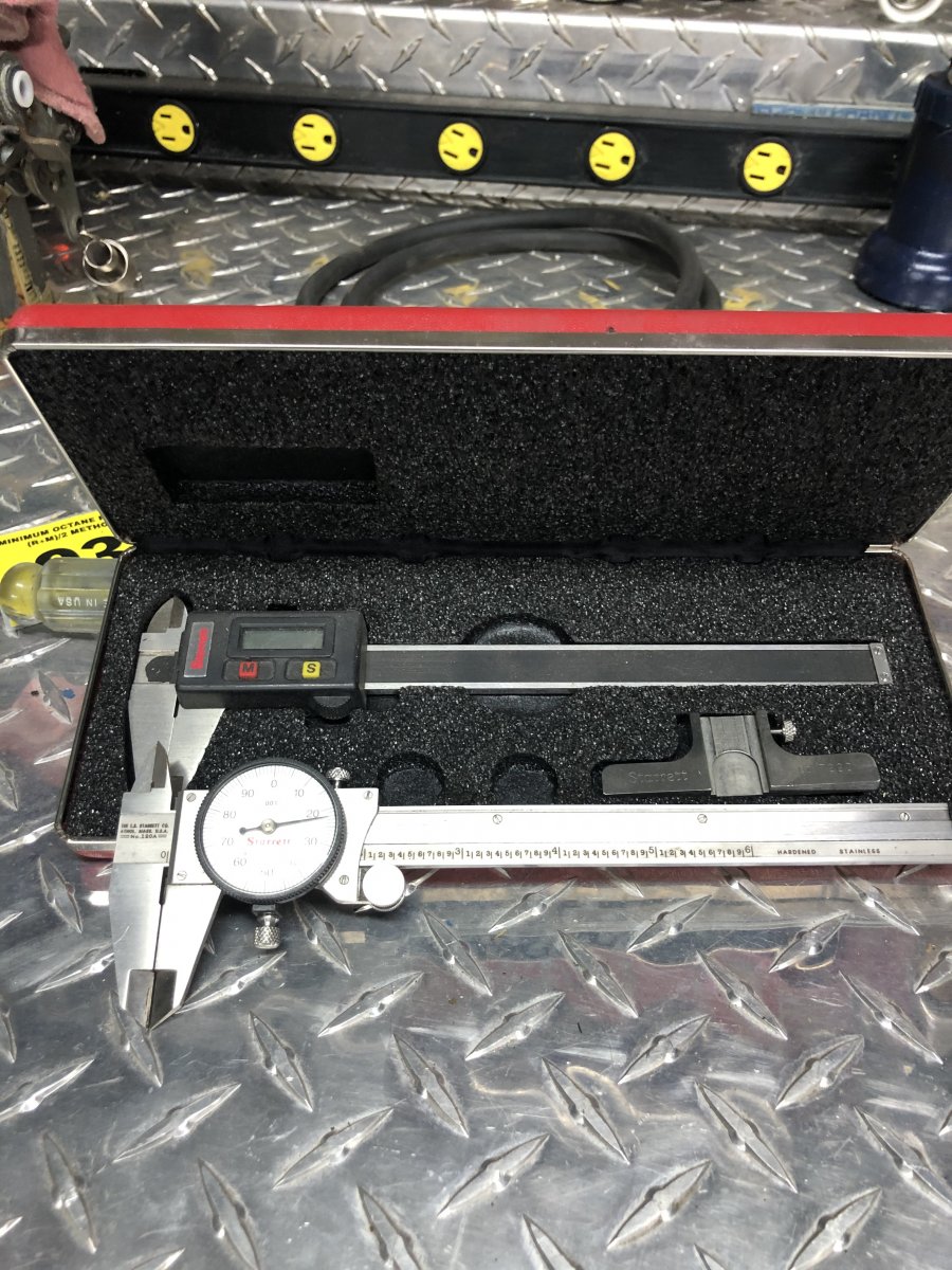

  30. This reminded me to check, guess which one I could use today?:D
