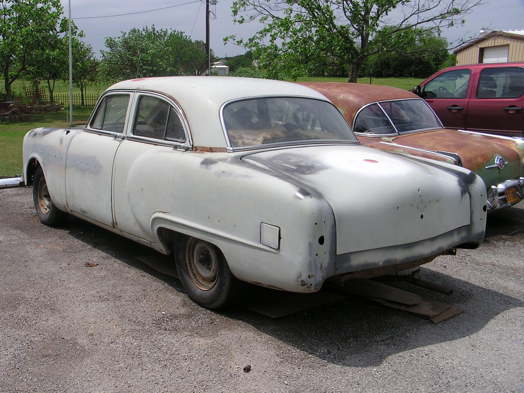

    You are correct Gromit.... I just thought mine looked like the TBI in my '89. I looked a little closer this weekend and I do have the Central SFI (Sequential Fuel Injection) system. And I spent a half a day reading a Hanes Repair Manual and it sounds like every sensor ever made is on this engine/trans configuration and they control anything that spits, sputs or sparks. Having second thoughts.:confused: Thinking of giving the truck to the grandson :rolleyes: and coming up with an older modern (oxymoron) driveline. Maybe I should just rebuild the L8 flatty in it and just convert it to 12 volts.:cool: Decisions, decisions..... Well here is a pic of my new Mistress that I will be bringing home this weekend. Can't wait!!!:)
