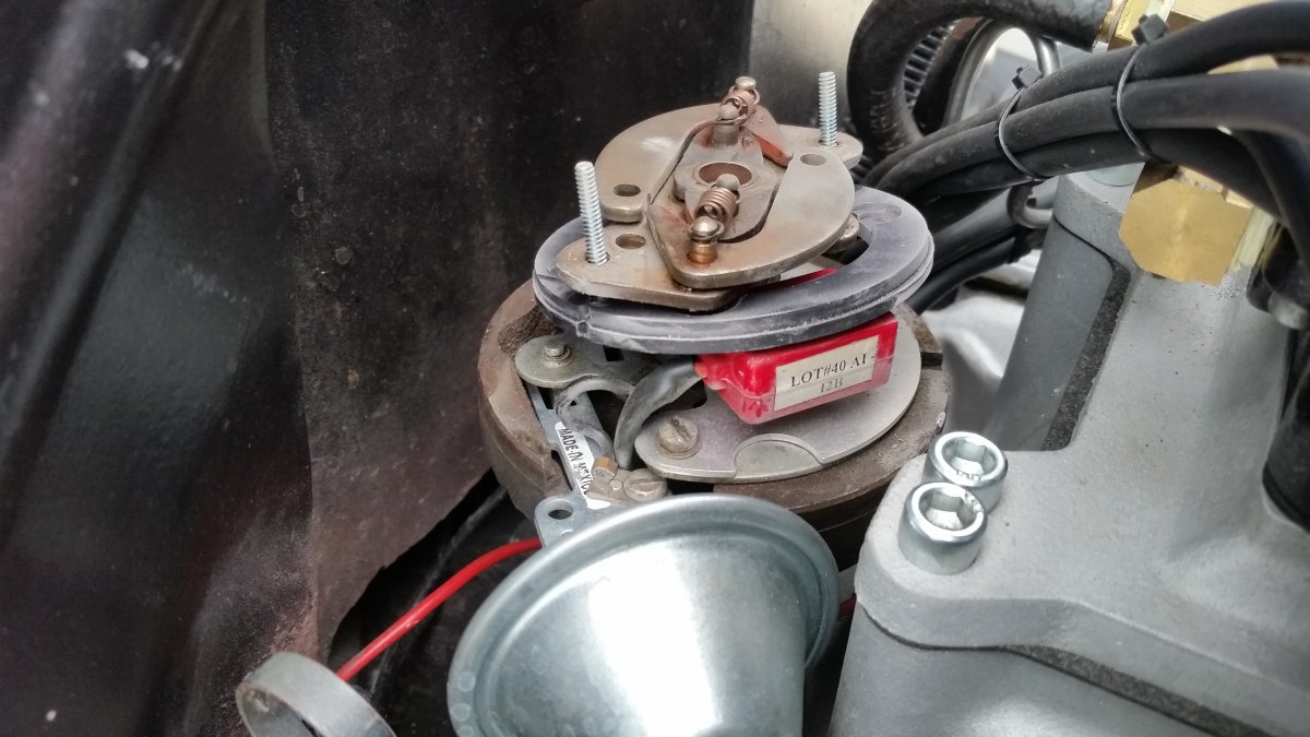

    from So Cal
    Is this a Pertronix unit? It was installed by the previous owner, I'm assuming it's Pertronix, but could be some other brand (are there any?), but no labeling is visible. It looks like a simple design, just a magnetic ring that rotates with the upper assembly and triggers a hall effect in the sensor mounted directly below it, which in turn closes or opens the coil primary circuit. If it fails on the road somewhere it looks like it would be pretty easy to swap in a new unit (if you have one). No more difficult than installing points/condensor, probably easier.
    It's not like I haven't had points/condensor systems fail on me before.
