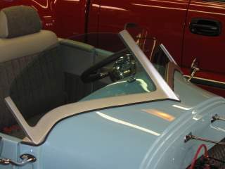

  24. bob giles
    Joined: Dec 4, 2007
    Posts: 147
    bob giles
    Steve Sellers made frames with two sizes of groove. I contacted him 2 years ago and he recommended using the rubber that he had for sale. He sent me the rubber but it got lost in the groove. Thats when he remembered that they were made with diferent size grooves.
    I had a regular glass guy cut and install my glass. He recommended using clear silicon and gluing them in. He thought if they ever broke, ureathene would be dificult to clean out. Mine are two years old with no problems
  25. nick_c
    Joined: Apr 27, 2011
    Posts: 149
    nick_c
    from texas
    Your frame looks super clean installed.
    Is there something in between the frame and the cowl top?
  26. bob giles
    Joined: Dec 4, 2007
    Posts: 147
    bob giles
    Nick c, I glued 1/4X1/4 angle rubber around the base of the frame
