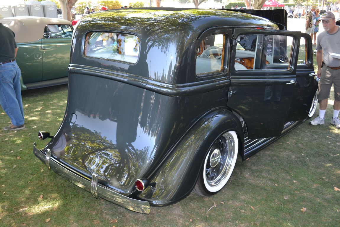

    here is an approximation, the main back panel goes to the very end and then bends where the frame end meets the curve.
    you are right it hard to find pics of that panel. you may want to start conversations with people with these style bodies. I may have some pics someplace, I have a '33 I'm working on and that panel is much shorter on a 33.

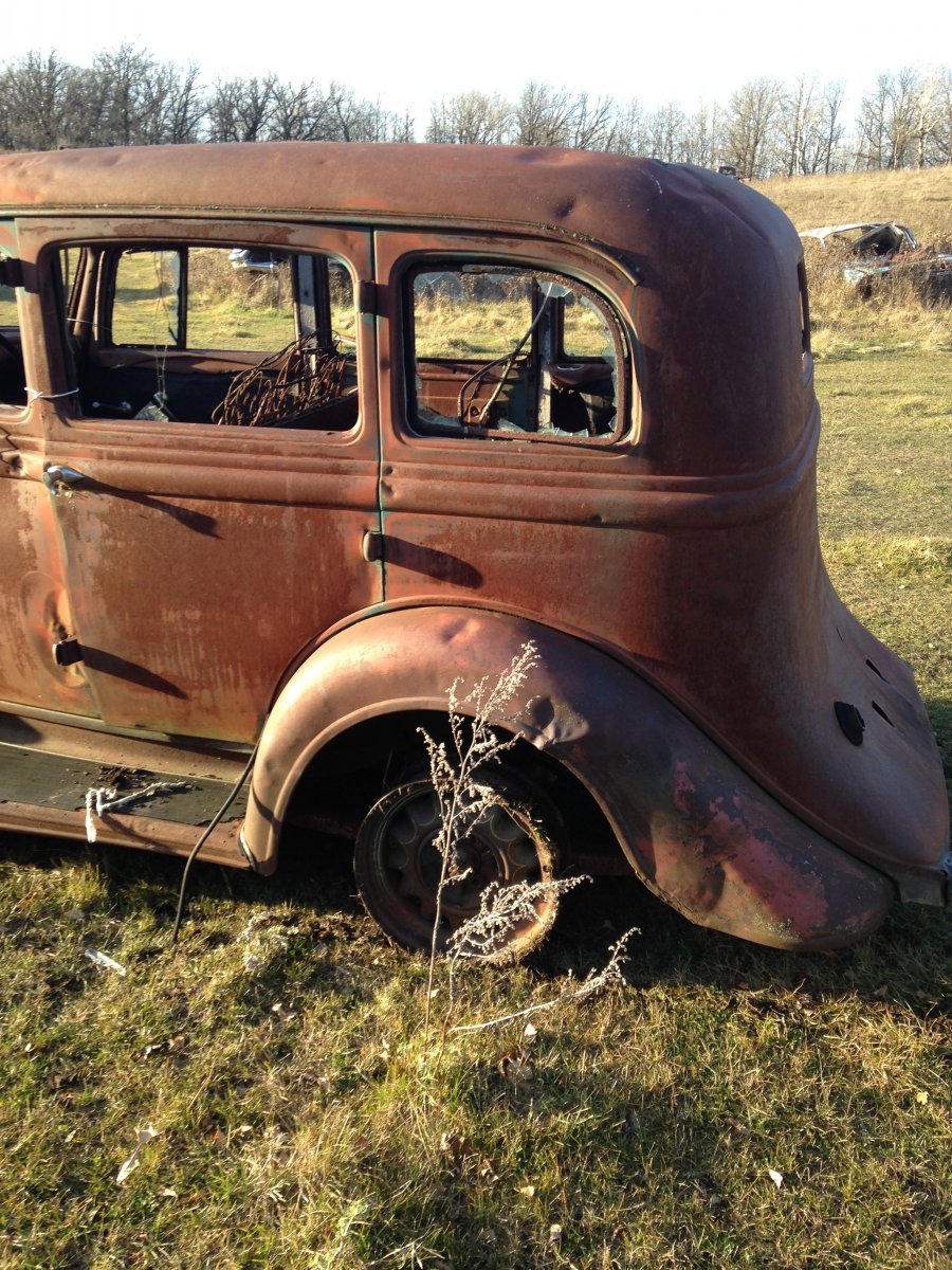

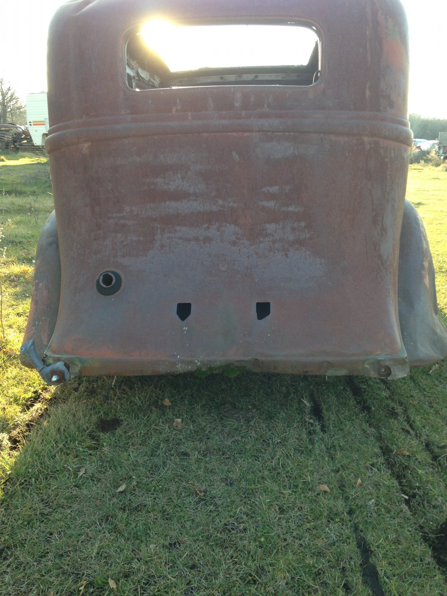

    image.jpeg image.jpeg I have this car in my yard. If I can get you more precise pics that would help, just let me know.

    Thanks for the help. mrloboy, your pics were what I was looking for, looks to be a lot more missing on mine then I thought. Can't quite figure why the curve of my fender doesn't match the body curve at the flange, wonder if the fender is the wrong one.

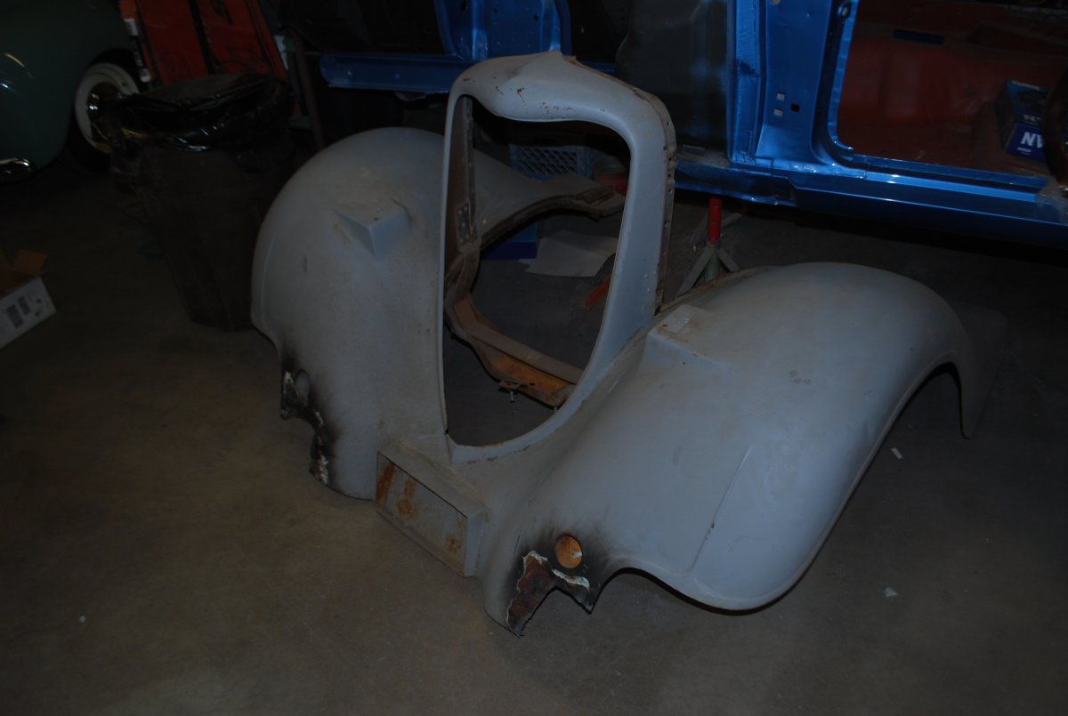

    Not much to look at yet. Has a solid body, no rust at all and pretty straight. Keeping it Mopar powered, we're putting a 360LA/ torqueflight in it. DSC_0079.JPG DSC_0080.JPG A po did more damage then good, ya got to love what he did to the front. He had put a Volare front end in it so he extended to fenders and grill shell down to hide the torsion bars, might as well put another ugly license plate box in it to match the back one!
