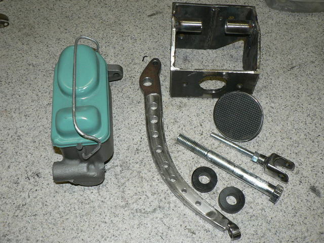

  14. I just finished up making mine yesterday, lot's of pics's here http://www.jalopyjournal.com/forum/showthread.php?t=664434
    I used a 5/8 pivot, the pedal arm is 1/2" thick, I don't think 1/4" seems beefy enough. My setup is only one pedal but expanding it out to 2 wouldn't be that difficult.

  16. WelderSeries
    Joined: Sep 20, 2007
    Posts: 765
    WelderSeries
    Alliance Vendor
    That pedal looks nice! Did you make it?
