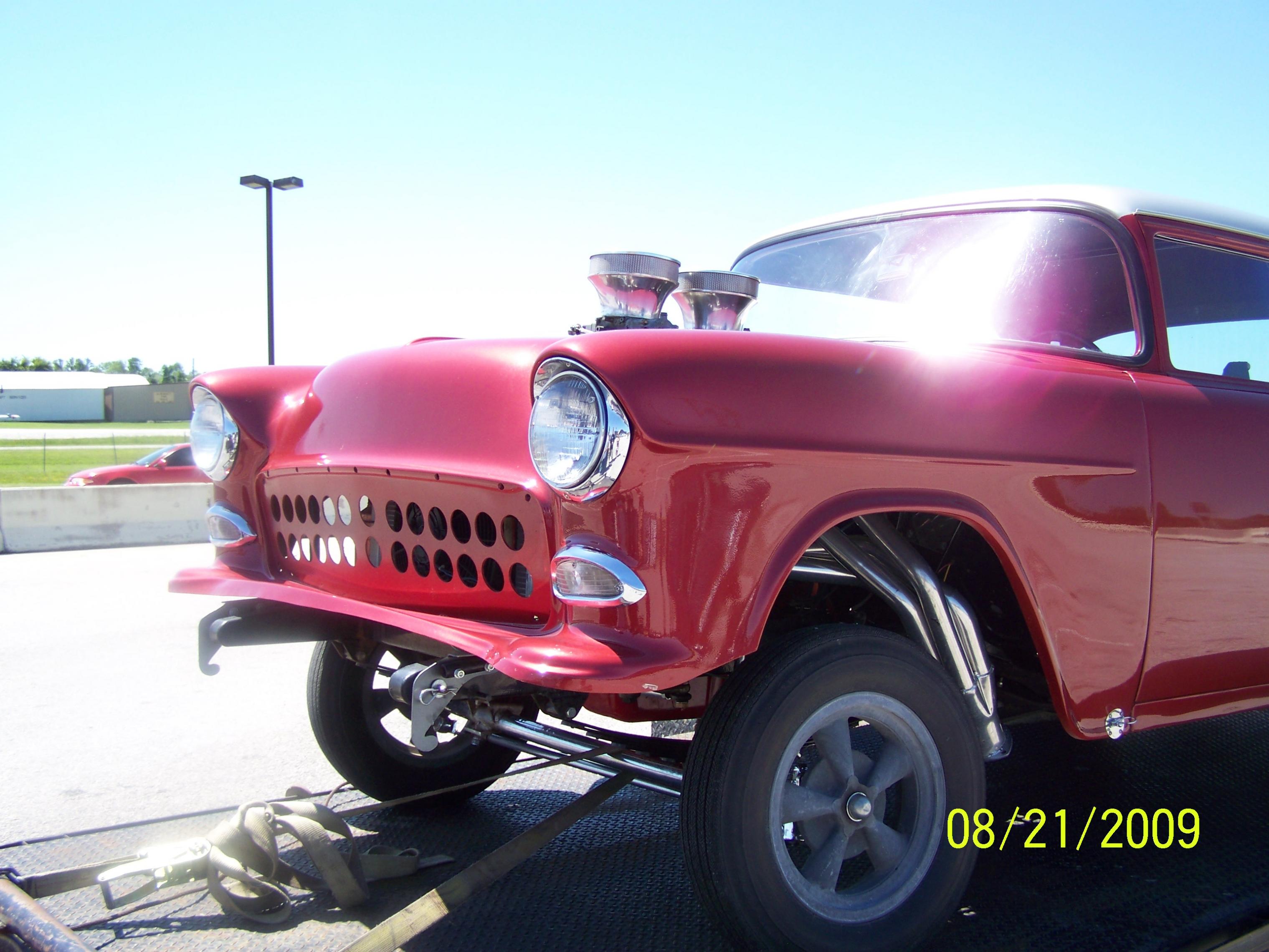

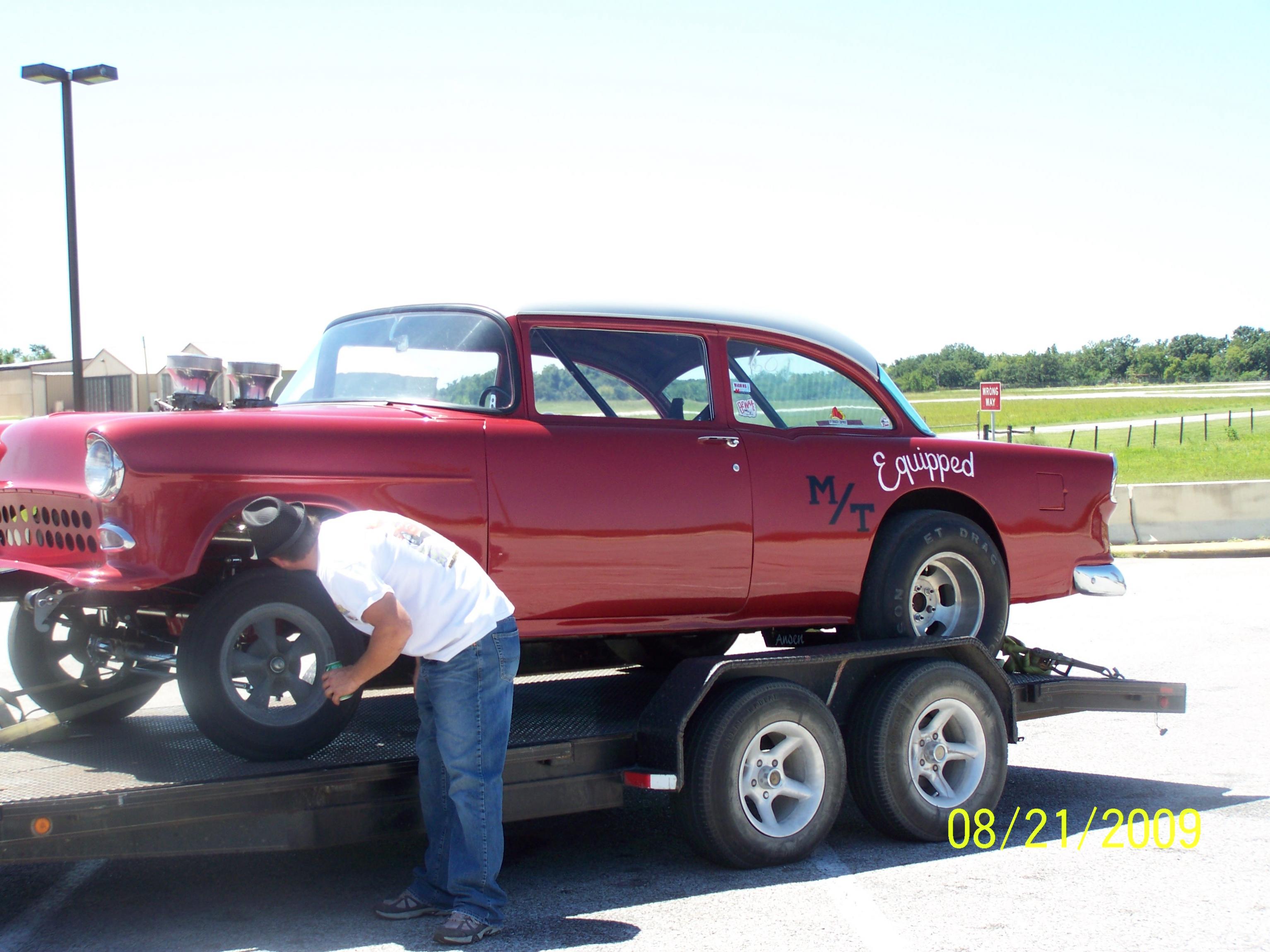

    The 55 is mine, it was at the HAMB drags
    The car is a 150 sedan that I built from a hulled out body, I removed the stock frame from the steering box forward and added two by four tubing, mounted an old chrome straight axle that I found at a swap meet it uses econoline spindles. I use a 65 mustang steering box moved in front of the axle and cross steer.
    The rear suspension is stock 55 springs with traction bars, a 62 Olds rear axle with 31 spline and 5:38 gears and a poor boy locker.
    The motor is a .030 over 454 with a crane roller, vertex magneto ,weiand tunnel ram and two 850 double pump holleys, the transmission is a Muncie M22 rockcrusher with a hurst shifter and an Eelco handle.
    The interior is pretty bare no headliner or carpet has lightweight black rolled door panels and a pair of Hemi Dart bucket seats that are super light. It has S/W greenline gauges and a Superior the "500" wheel, A six point rollcage all the side glass is lexan and the quarter windows don't roll down on 55 150's
    I painted the car and did all the body work, rear 1/4s are radiused and it has a glass
    frontend that is also a period piece from the late sixties. The wheels are all magnesium and fronts are spindle mount with no brakes.
