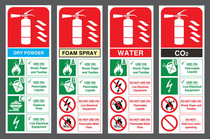

  30. I have several, of different types. If you have a fire in a confined area, like an engine bay, a CO2 extinguisher is mighty handy, as you won't be cleaning up afterwards. Just make sure the place is ventilated. Also, a fire blanket is good for smothering small fires. There are charts to show you what type of extinguisher to use with different type fires (fuel, electrical, etc). Using the wrong type of extinguisher can be useless or make it worse. FE-USE-e1552046424248.png
