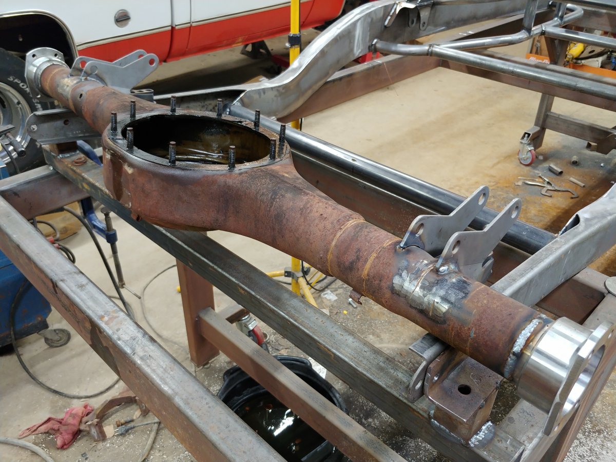

  11. I'm in the process of doing the exact same thing, new big bearing housing ends and Currier big 11 inch drums

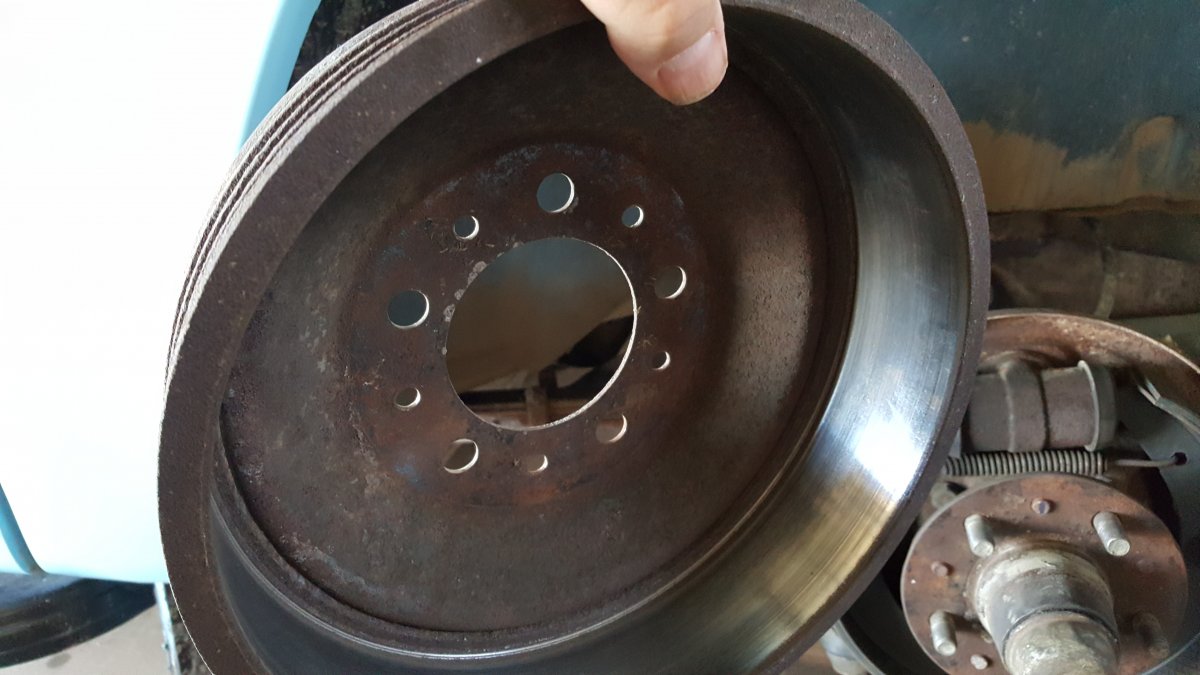

    I was fortunate to score NOS Buick drums from the old neighborhood parts store, so I went to salvage yard and got everything else from backing plates out on a Buick. A friend of mine had the adapters for ford spindles to Buick so I had a machinist friend make me copies for my model A. So I'm essentially running Buick up front should be more than enough brakes for an AV8

    It would have been a lot cheaper to have run discs.
