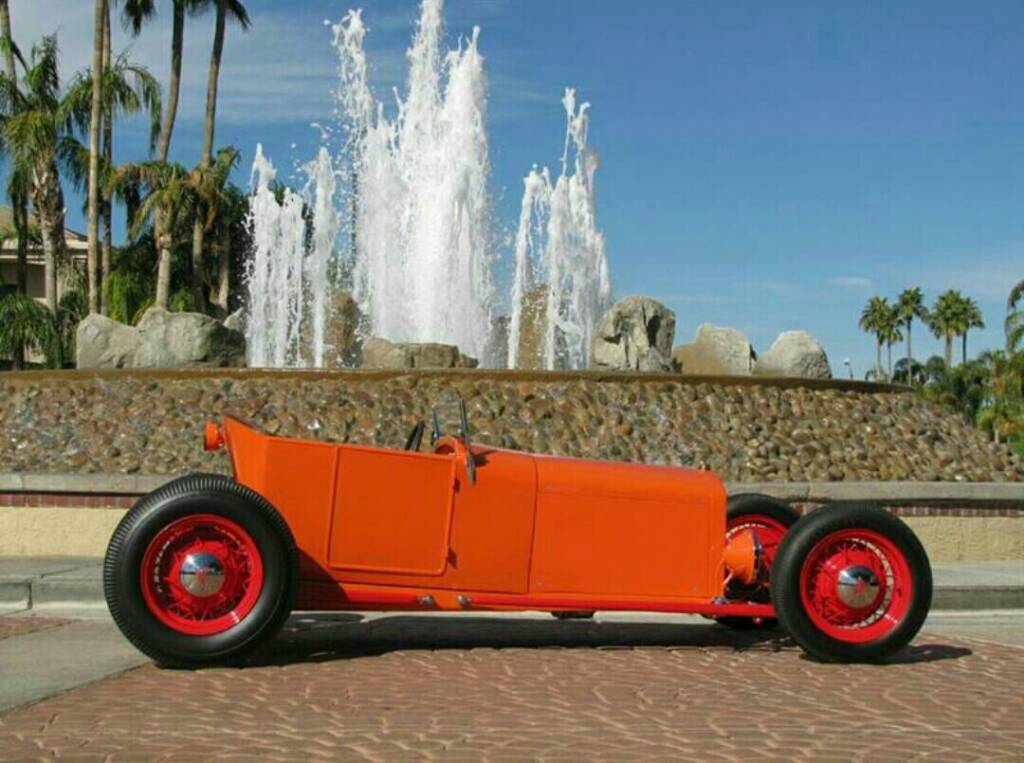

  17. modified
    Joined: Sep 21, 2006
    Posts: 326
    modified
    Anything specific?
    This is the car our mutual friend Alan Wisch owned for a few weeks!
    Sent from my SM-N900V using The H.A.M.B. mobile app

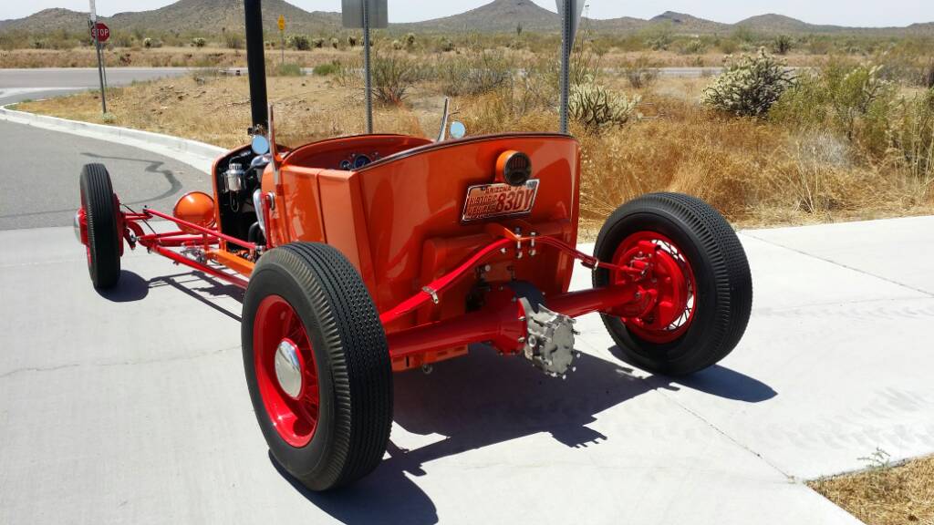

  18. A Boner
    Joined: Dec 25, 2004
    Posts: 7,438
    A Boner
    How about an action shot at 80 going down the 17! Or anything with some beautiful AZ scenery. How's Al doing.....what's he driving lately? Saw him back here a couple of times this summer, trying to wheel and deal on some rides.....Al doing, what Al does.

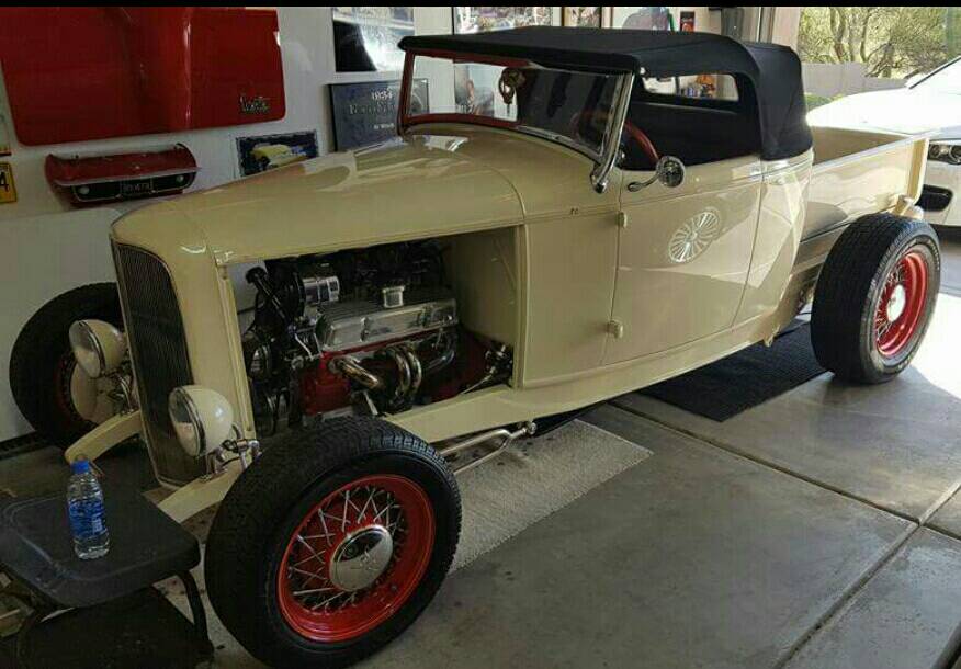

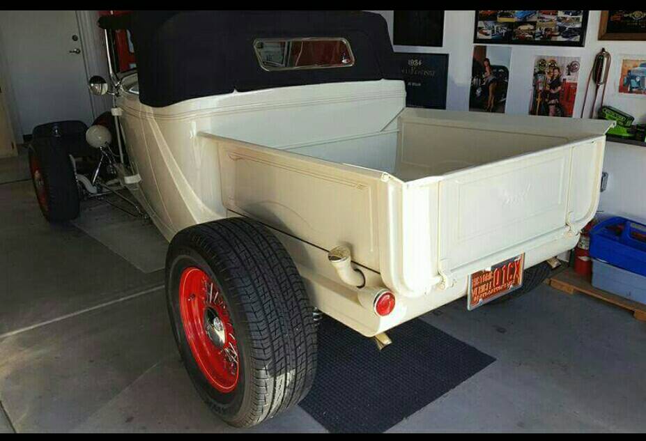

    Al recently bought a white '32 roadster pickup from Wisconsin and had it shipped to Arizona but I don't think he likes it much! tempFile_2018-08-09-14-56-27.jpeg Screenshot_2018-08-09-14-56-54-1-1.jpeg 20170525_113800.jpeg 20170525_113826.jpeg 20171118_112038.jpeg 20181006_173825.jpeg
