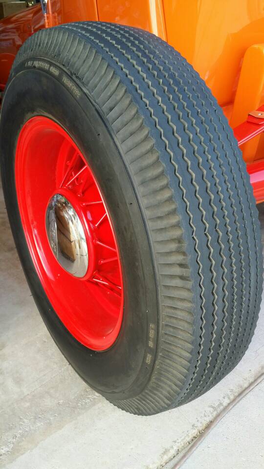

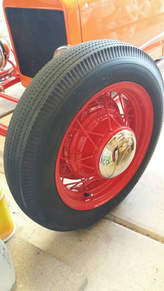

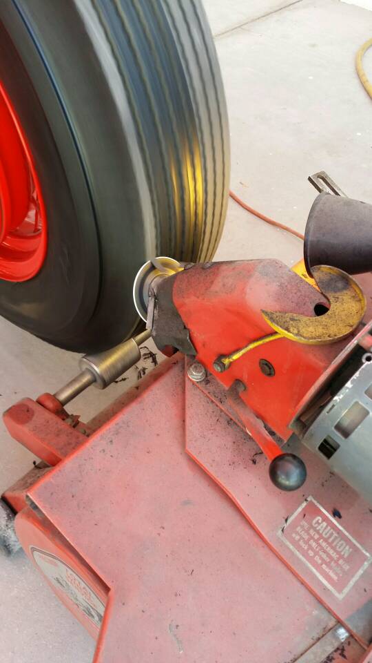

    Last week I did a post about tire shaving which helped quite a bit!
    I have tried DynaBeads for the 1st time and they also seem to help but I'm not sure how many ounces to run.
    On the front I have 4.50-4.75/16 Coker Firestone bias ply on '35 Ford wires on '40 Ford (Speedway) drums.
    On the rear, 6.50/16 '35 Ford wires widened 2" on Speedway '40 Ford drums.
    I have 3 ounces of beads in each front tire and 5 ounces in each rear tire.
    The fronts do well till about 65mph+ as well as the rears but at lower speeds I get a choppy little bounce in the rear.
    I think Maybe I need to add more beads! I went with what Innovative Balancing suggested.
    How many ounces do you guys find works for you? 20180827_174909.jpeg 20180902_120604.jpeg 20180902_120647.jpeg tempFile_2018-08-09-14-56-27.jpeg

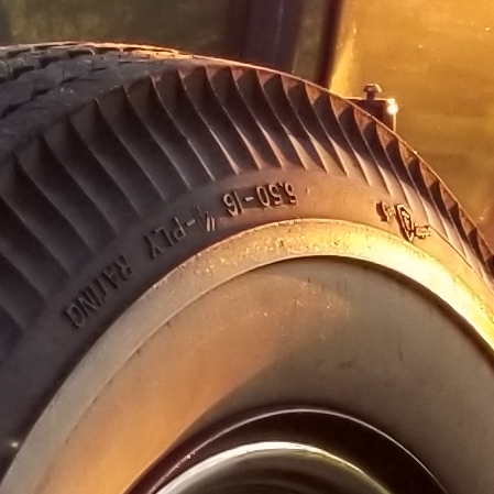

    @modified the antique tire chart says...
    650/16 _4 Ounces not 5...was that a recommendation...perhaps there is too much.

  13. well, they said to use 4 oz for a 550x16 tire but if the tire in question needed more than 4 oz of lead weights on the rim, i would think you would need more than 4 oz of beads. I have not tried it out yet, guess I will today it is hot and nasty out today so not looking forward to getting out there.
