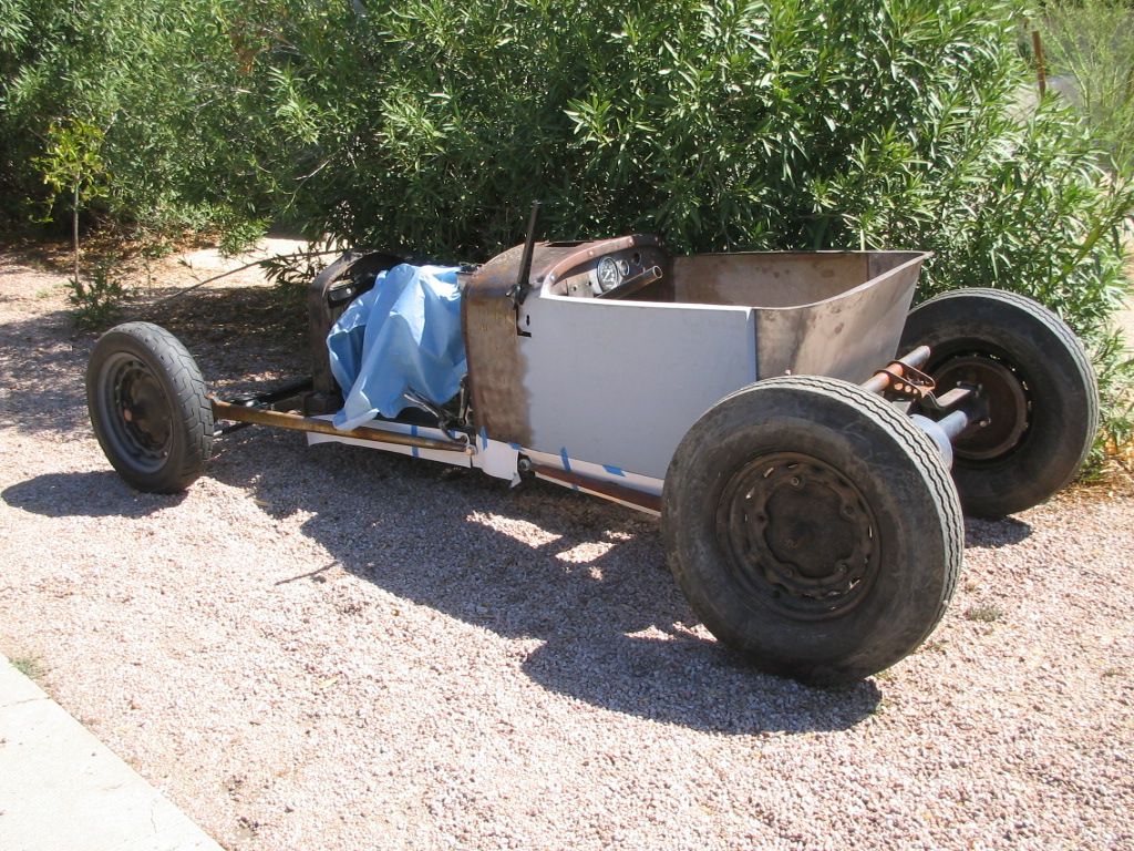

    I started to build one a few years back but it been awhile sense I touched it. I bent this up using one inch square stock on a home made bender on top of my bench.The body is based on a 27 Ford.I just scaled it up cause the 27`s were small.I have one quarter skin made and that is as far as I got.too busy at my shop to do any of my projects.But that is going to change!

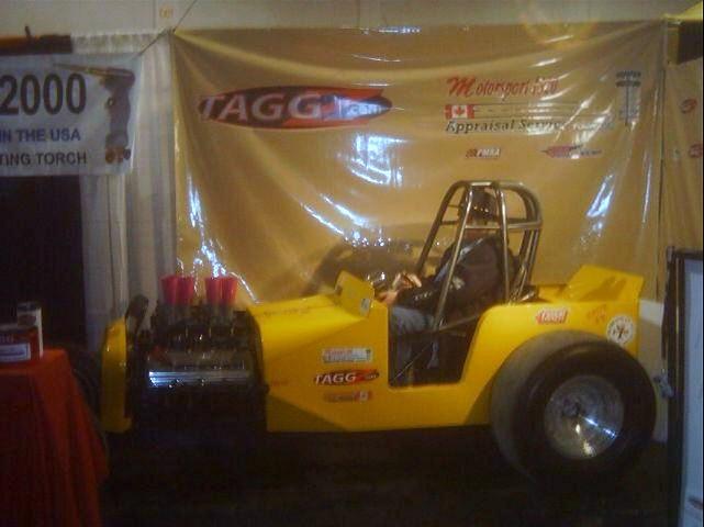

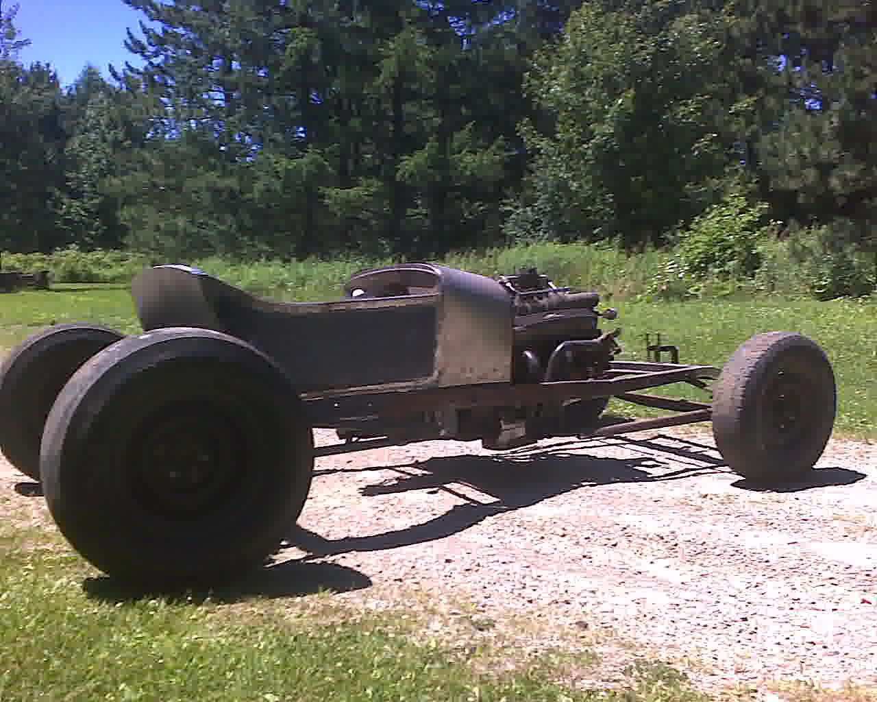

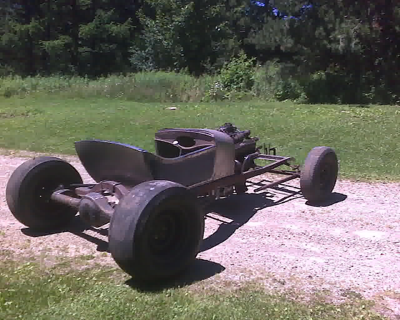

  4. I mocked this body up first in wood paneling and strappping. I cut and glued and shortened and modfied till I was happy. I went to Noronco Sheet Metals here in Belleville. i asked "can you duplicate this in Aluminum? He said "yes no problem." It did not take them long. Here it is on display at TO Perf Industry car show. It was easier than i thought. I started by tracing the side of a YJ jeep but then reworked it till if fit this Altered right. It will be on display at the Flatout Weekend in Shannnville I am told. It was sold before I had finished it but I did finish it for the new owner VC with his help which was considerable. The body was easy looking back i would do something similar without hesitation. My goal here was to build a Jeep Buckket rather than a T bucket. (Why? There is no reason. just idea I had that it could be done and would look ok.)

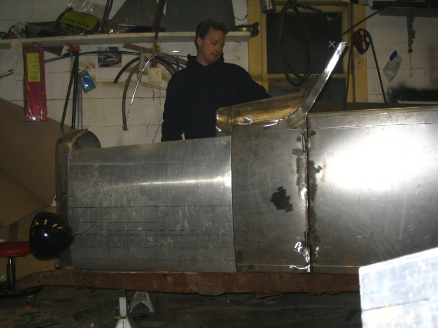

  5. Sawzall and I (along with a few other hambers) made this over the fall months a few years back. Lots of fun. - tok

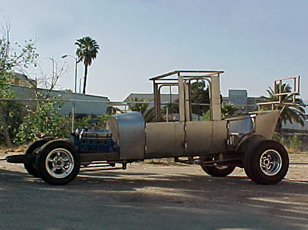

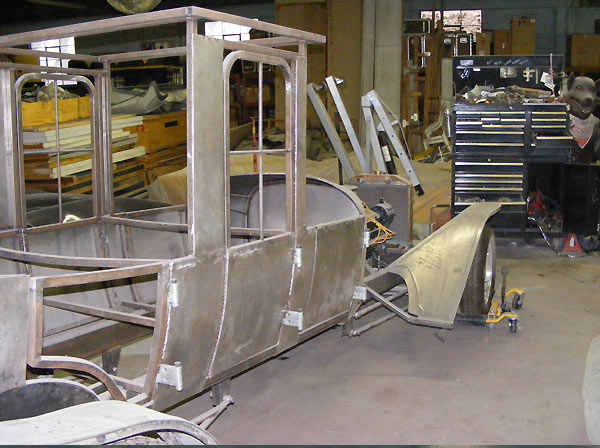

    Mark Towell at Gothum Garage builds all kind of things and he hand building a Munster Koach

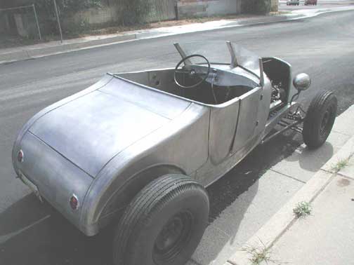

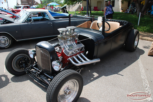

    The 27 roadster was built from scratch by Topcat662 on here. Even built the 32 style frame with the reveal by hand.

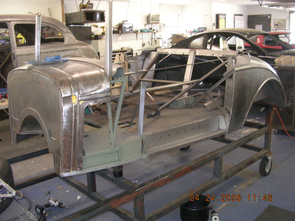

    Not completely hand built but 80/90% of this Vicky body I built. Used a 4dr cowl and tudor inner door frames and some salvaged window sections.

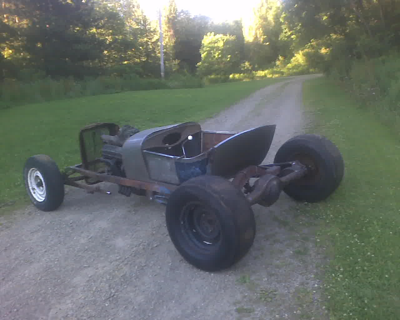

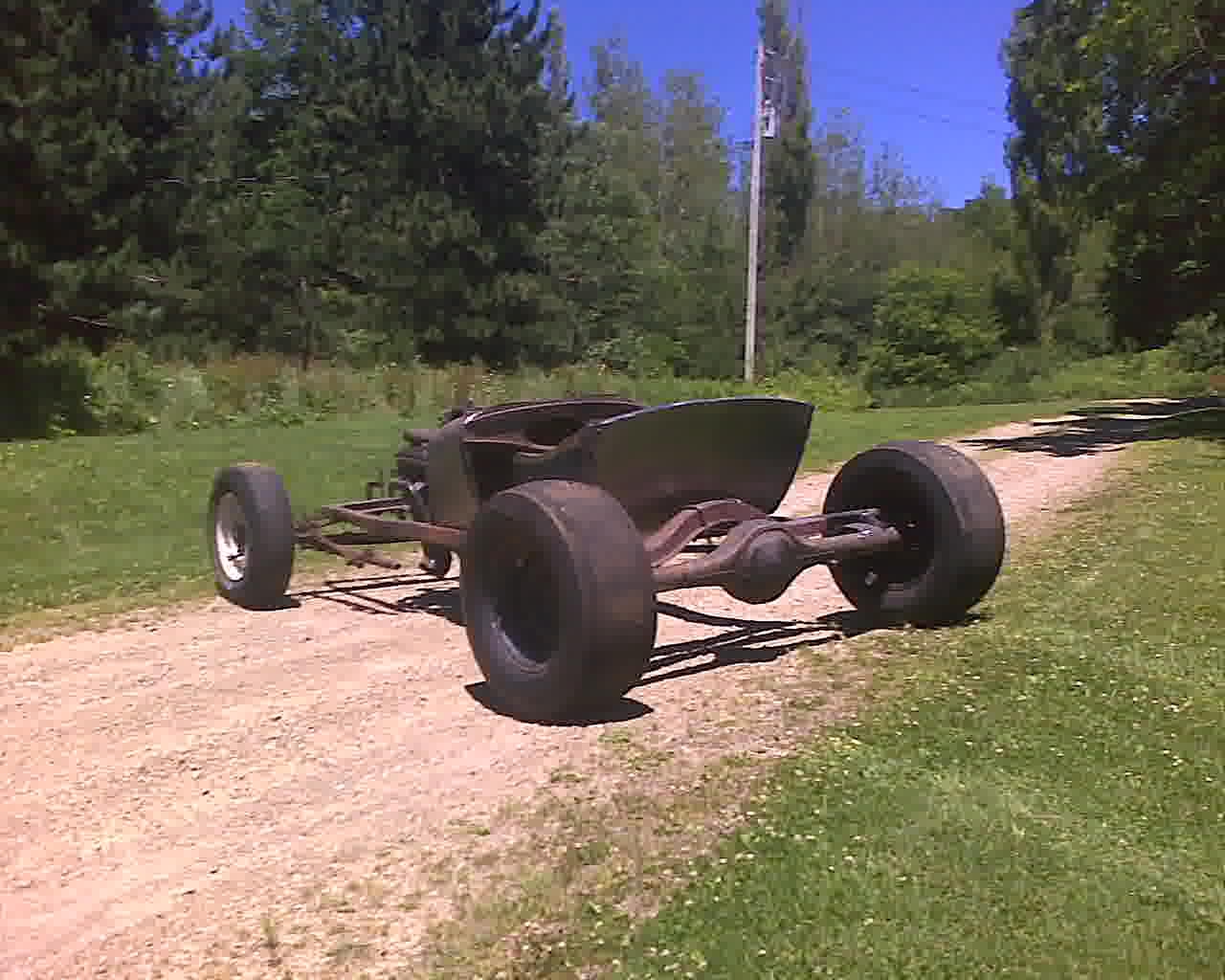

    It's not done yet,but everything on this roadster body is handmade,with the exception of the firewall.

  20. Thanks a heap guys!! Some great inspiration there!!! tokyo, that 4 seater that you guys built, can you give me a quick rundown on materials used, and/or any other info? That is EXACTLY what I want to built, EXACTLY!!!!!!!

    tokyo mentioned this thread to me yesterday.. kinda funny I see it now..
    here are all the photos I took of it.. tokyo may have more..
    http://public.fotki.com/sawzallshop/sawzalls-rides-past/sawzalls_shop_shop/
    I was given the early pontiac dash which the body is based around..
    we used about 6 sheets of 18 ga (floor was in the car etc etc)
    built it ontop of a model a frame I had..
    used a bead roller, small brake and a shrinker/ stretcher
    as well as a host of other hand tools..

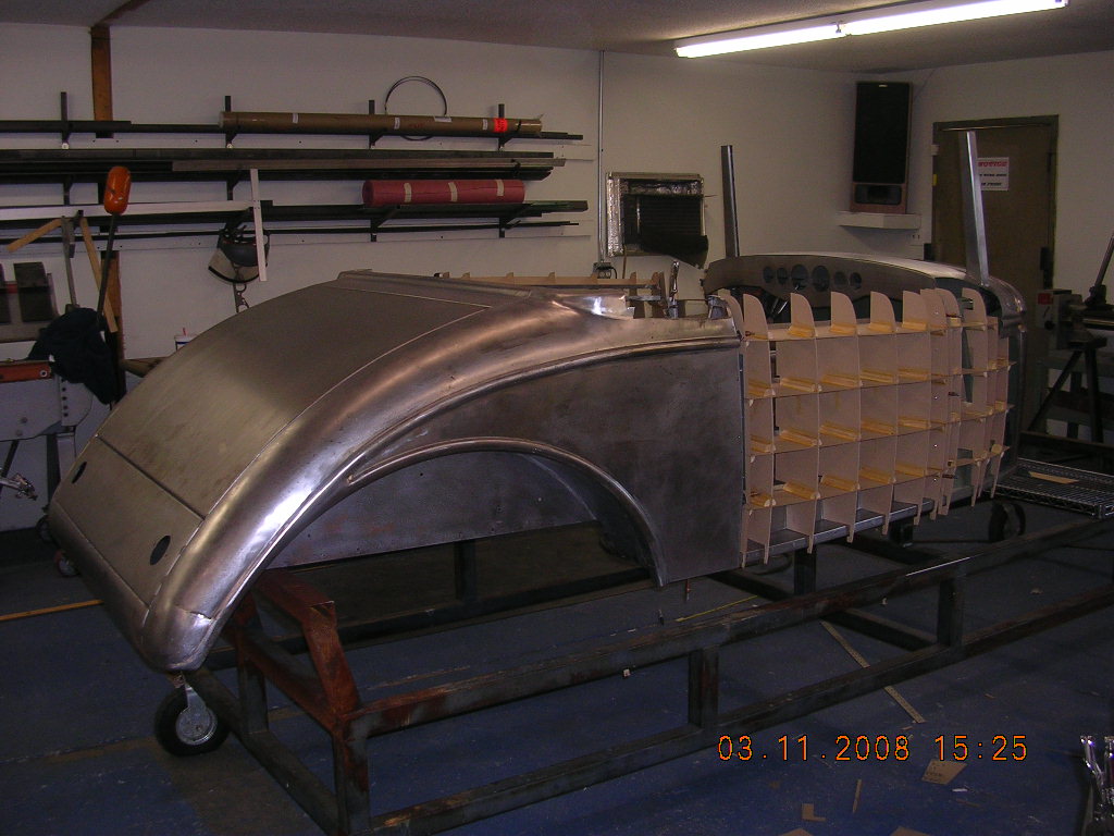

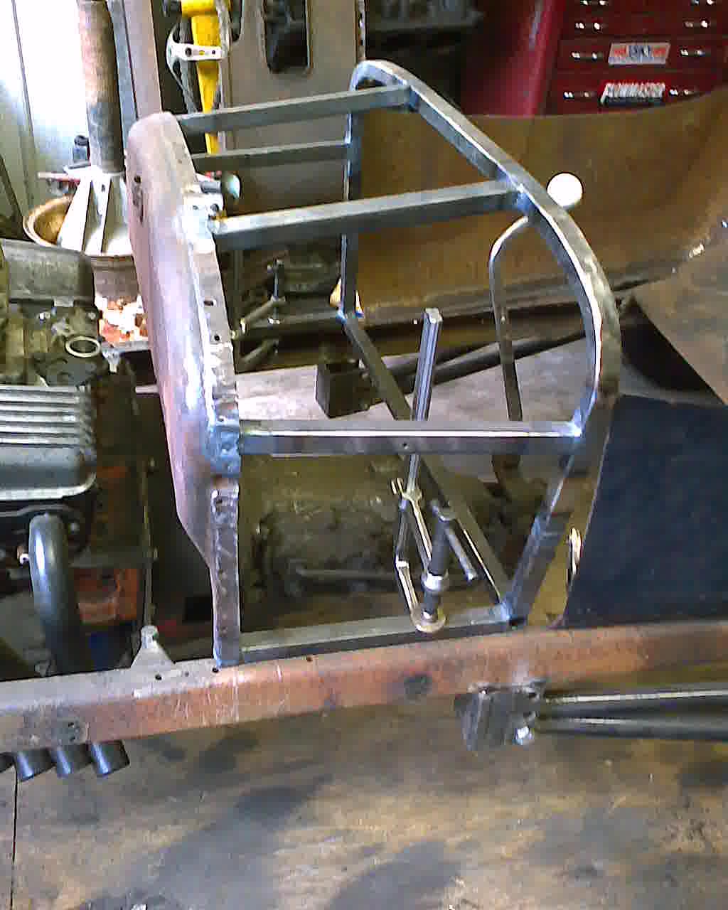

    Well I might as well throw mine in. I started with a '26-'27 roadster cowl, and the rest is all me... Well, that and a shinker stretcher, and a bead roller. Obviously not finished yet, but i peck away at it between paying jobs.

    Need louvres?,
    That is looking real good,keep peckin at it! What's the drivetrain?
