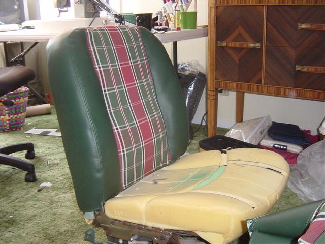

    For what it's worth ,I needed a seat for my car but I have O interior skills. I robbed the complete interior out of a Chrsler Minivan for $80 and am useing it. I'll try to post a pic, the seat was installed with the seats from buckets and the back from the bench, we even made it to where it still folds forward for storage. Went on Power tour and it was very comfortable [img=http://img152.imageshack.us/img152/3835/buick078zi1.th.jpg]
    [img=http://img152.imageshack.us/img152/3306/buick079pt5.th.jpg]
