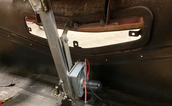

    I installed the Newport kit in my 41 under construction. I cut out the factory center dash support and installed a thinner version which I offset to the right slightly. I mounted an electric cowl vent motor from julianos which I mounted as close to the firewall as possible to retain the cowl vent operation. I also have a compact AC from Vintage Air that I mounted at the same time so not to run into clearance issues. I may have to shorten my glove box slightly but that is due to me moving the AC unit as high as possible so I didn't have to look at it.
  9. Bandit Billy
    Joined: Sep 16, 2014
    Posts: 12,370
    Bandit Billy
    Here is an old pic of the brace I installed and the cowl vent motor. Plenty of room for the wiper motor
