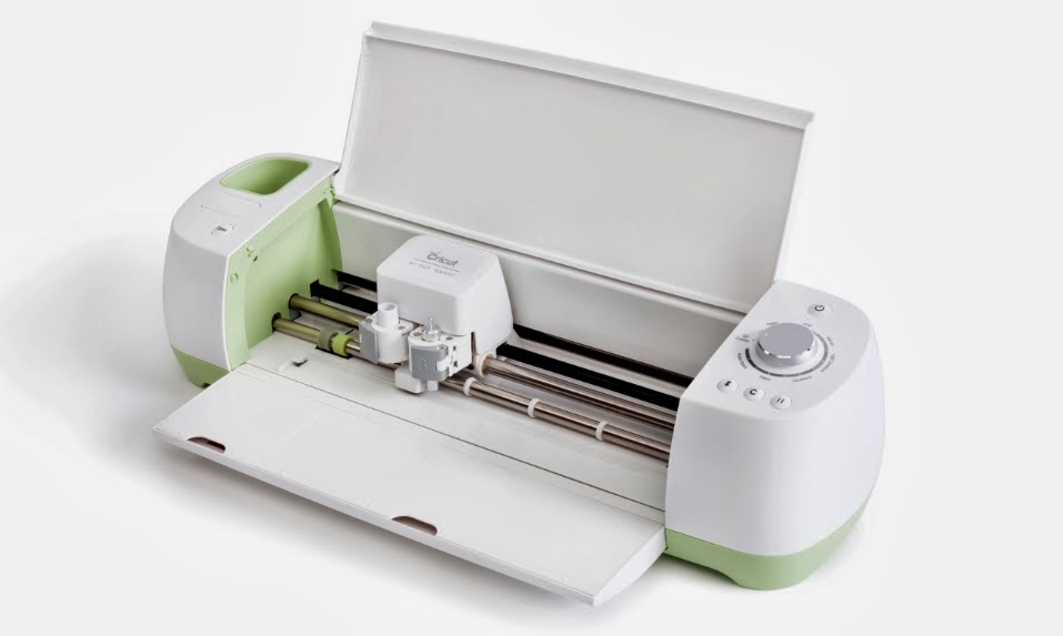

    Making gaskets would be as simple as putting your old gasket in a flatbed scanner (like for pictures), tracing it in their software, and "printing" it via the Cricut onto gasket paper (it'll even cut leather). I was just wondering if anybody here has ever done it.
    For folks that don't know what I'm talking about, they're these machines (see pic) that lots of folks buy at the craft stores to cut out cute stickers and stuff for scrapbooking, etc. You can even get heavier-duty blades, and adjust the tension for thick cuts. You can even swap out the blade for a marker and it'll draw the outlines instead of cut them.
    It's not as high-tech as 3-D Printing, and seems like it would be easy to do.
    Has anyone on here done this?
