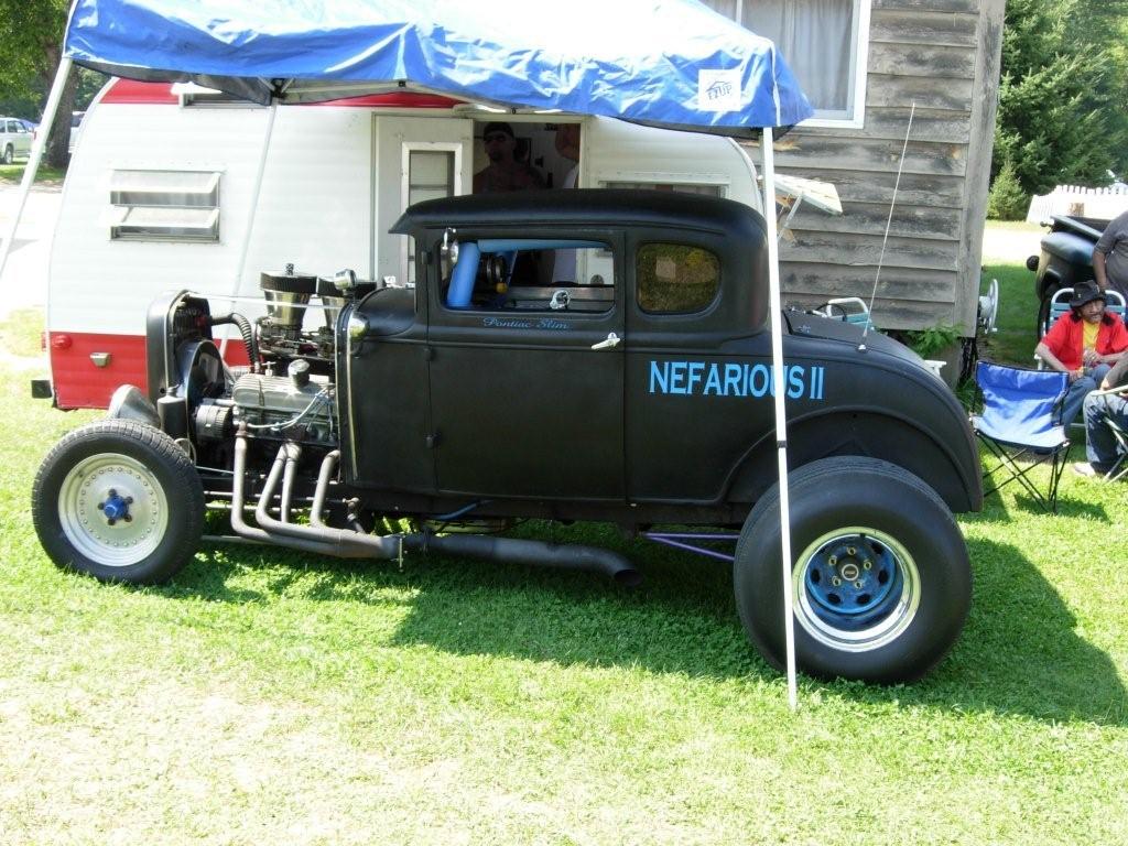

  9. flamedabone
    Joined: Aug 3, 2001
    Posts: 4,920
    flamedabone

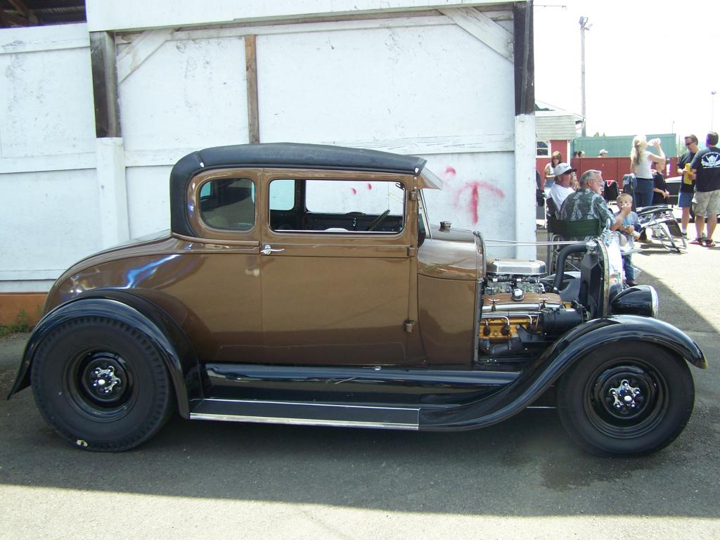

    Here is the Model A.
    Be mindfull of your starter to to steering box clearance, other than that, it will fall right in there.
    Good luck, -Abone.

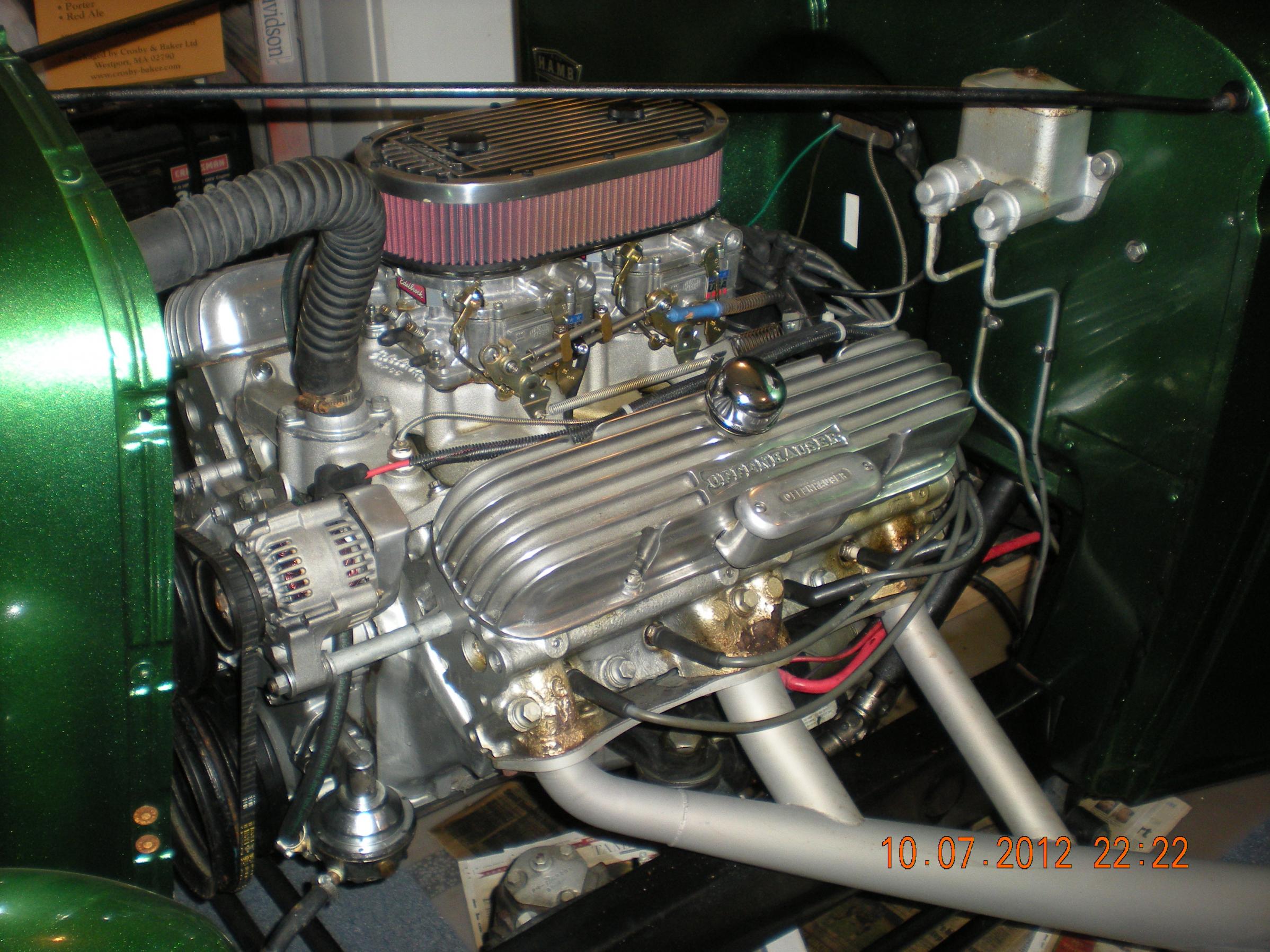

    Here's a pic it fits nice in original engine compartment with electric fans in front of the radiator.

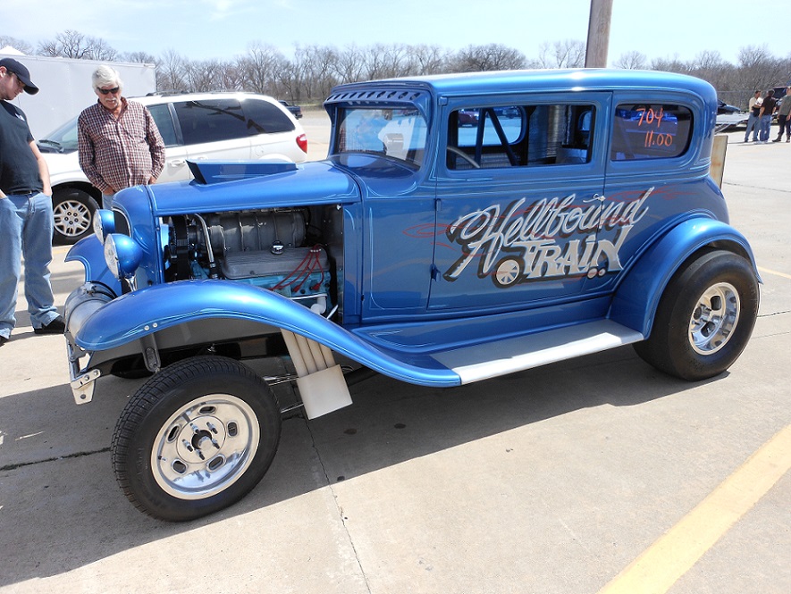

  17. Pontiac Slim
    Joined: Jan 16, 2003
    Posts: 1,188
    Pontiac Slim
    yet another..
