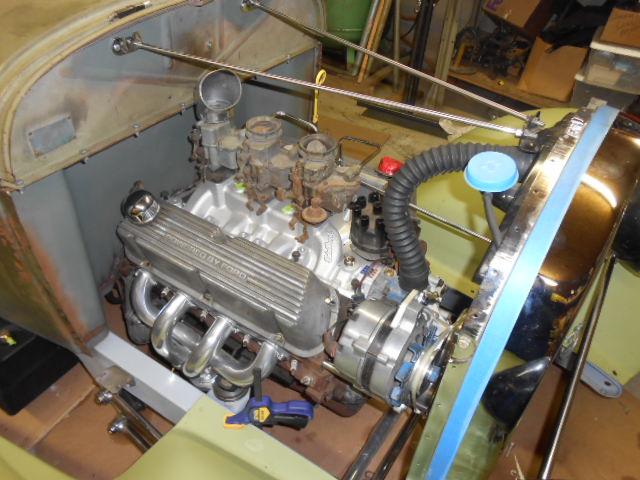

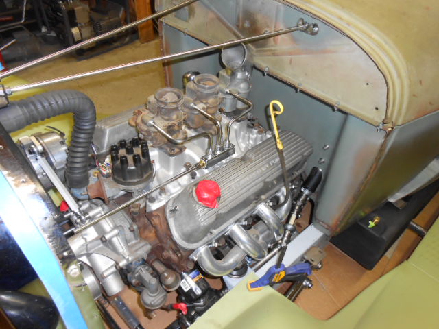

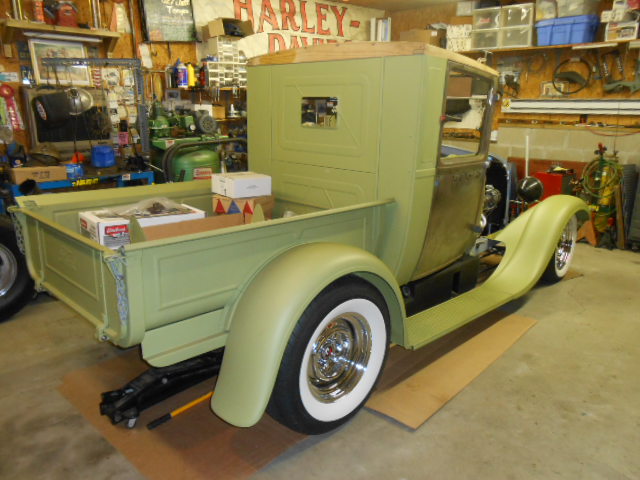

    Love the rpu. Did you weld up your valvecovers or someone else? Always loved those t-bird covers. And what waterpump are you running?

    running a spal electric pusher fan in front of the radiator due to having no room behind , and running the sno white waterpump conversion which saves about 2 and a half inches of room , it utilizes an opel gt waterpump and adapter to go to the timing cover , runs good and cool fan hardly ever kicks on , just been too busy with work to have any free time to make more adapters for the valve covers

    no welding they are stock fe valve covers , i machined thin adapters that go under them to bolt to the heads

    what does it take to use these valve covers?

    ^This car is tits man-I think being a machinist he made his own adapters!^
