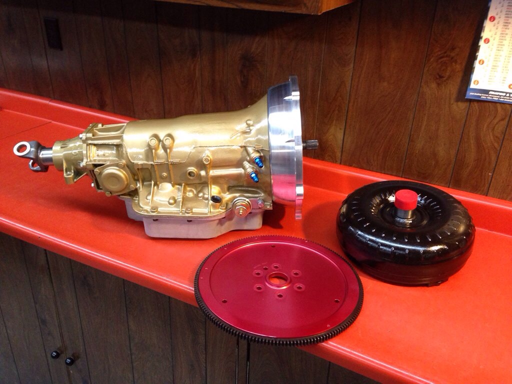

    The old style 4 speed hydromatic , (if that is what you are refering to, )will bolt right up to a 394 engine, you'll just have to bore a hole in the back of the crank to install a bushing for the end of the input shaft to slip into.

    Nice looking adapter, the only ones I found when I had my Olds (been a few years ago) was a plate & 4" crank spacer, didn't look like a good idea + the floorboard issues.

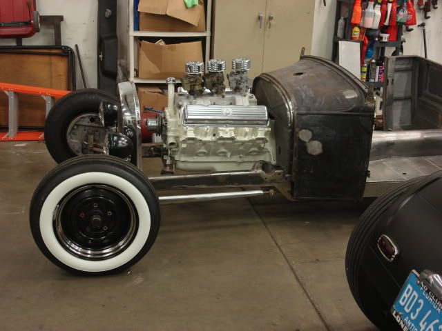

    as a teaser here is some stuff I've been gathering for some future project myself
    a 23 head long block found at a local swap meet, an NOS Crane full race cam on the 'bay, adjustable rockers from Blownolds here on the HAMB all freshened up by Delta Camshaft, solid lifters from Tony AKA Goatroper02, and an adapter and transmission left over from some long forgotten project
    maybe when I get tired of playing with the little Olds motors I will find something to do with this stuff too
