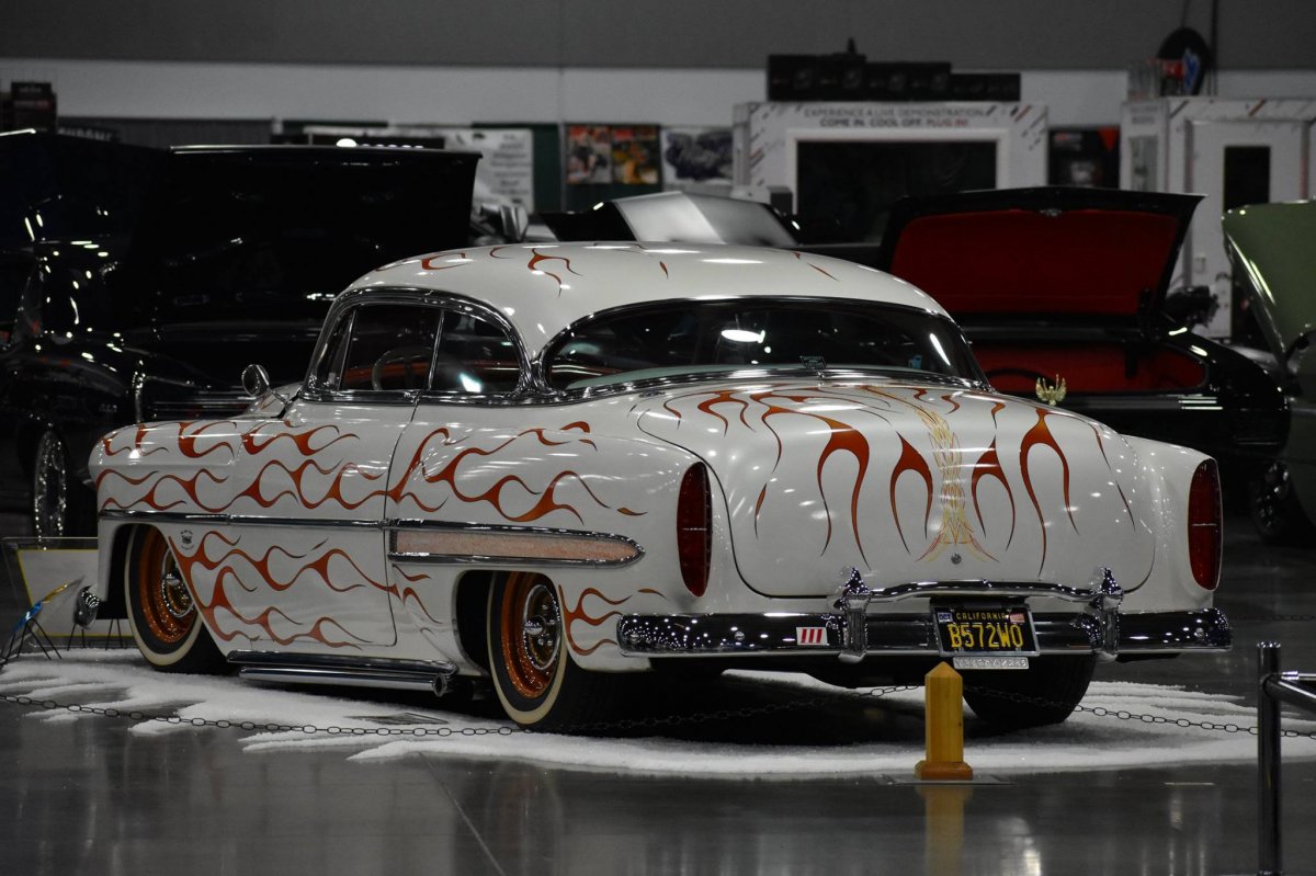

    how is this lowered FRONT? AND BACK? ITS PERFECT.... 14 inch wheels ?

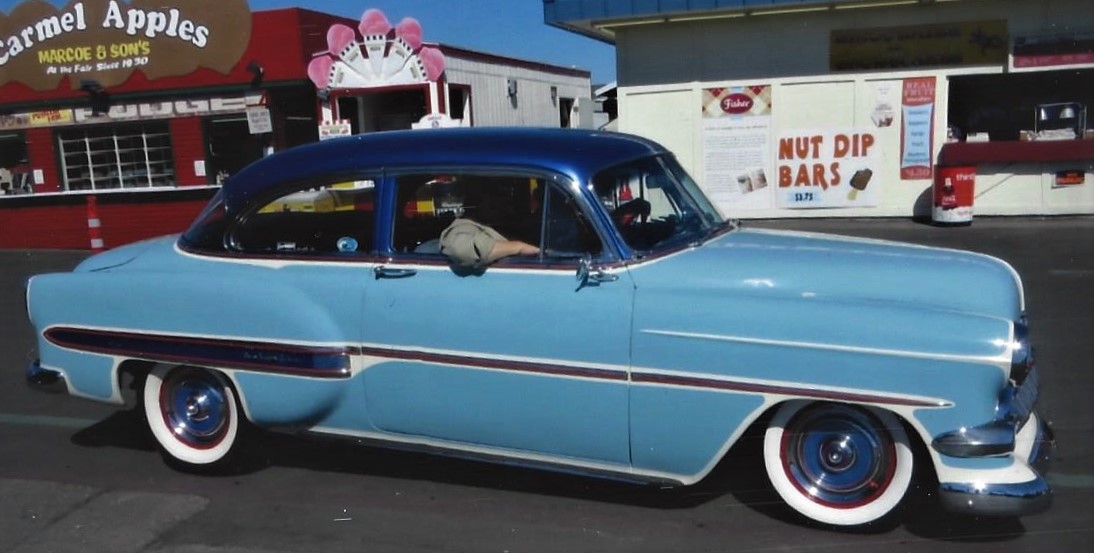

  14. Dyno Dave
    Joined: Feb 18, 2011
    Posts: 339
    Dyno Dave
    The front end of my '54 is lowered 5.5"+ using dropped spindles, 3" Jamco springs and 25" tires, the rear is down the same 5.5" with TCI 2.5" springs and 3" blocks, on a rake with 28.5 tires... That '53 looks 2"-2.5" lower in the front, unsure about the rear setting. Thinking it's air suspension, raised to drive away. If those are reproduction hubcaps they were available in both 14" and 15". It's a Looker !!!!!!!!!!!!!, Dyno Dave

    Is that your blue and white '54 two door ? I like the front,
    What do you mean 3" JAMCO springs for front? supplier ?
    Where did you get DROPPED SPINDLES ? supplier ?

    How did you lower front of yer 54?[​IMG]

    In 1999, I got the custom dropped 3" front springs, made to order for this engine/transmission weight from J&M Enterprises, Rohnert Park, CA. (707) 544-4950 The dropped spindles, with exchange/or core charge from
    Buffalo Enterprises, (360) 652-7684 Arlington, WA. I have the takeout '54 front crossmember with the dropped, all rebuilt, and aligned suspension.. Complete and installed the car rode and drove down the road very well,
    Brake drum to Brake drum, if you have a long haul trucker buddy, its available.... Dyno Dave (360) 774-6246

    they ALWAYS call it a '54 : but it has '53 front bumper..[​IMG]

    '53 bumper with a '54 grille .[​IMG]

    As I remember Hoffman's car, the '53 front bumper with a '53 grille surround, the end slashes deleted and housing a Corvette grille. Maybe '53 front fenders to rid the '54 parking light bulge... Wish my '54 had the very same pieces.
    Have always liked this one... dyno Dave

    not HOFFMAN'S Russ Meeks built it..
