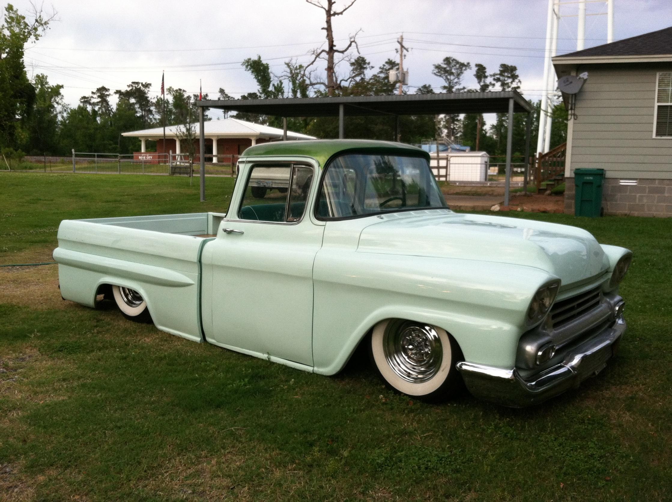

  3. hombres ruin
    Joined: Nov 21, 2006
    Posts: 3,306
    hombres ruin
    beautiful truck,the color is awesome
  4. Ha :) Thanks. Your car looks real good and stance is right on in my opinion.

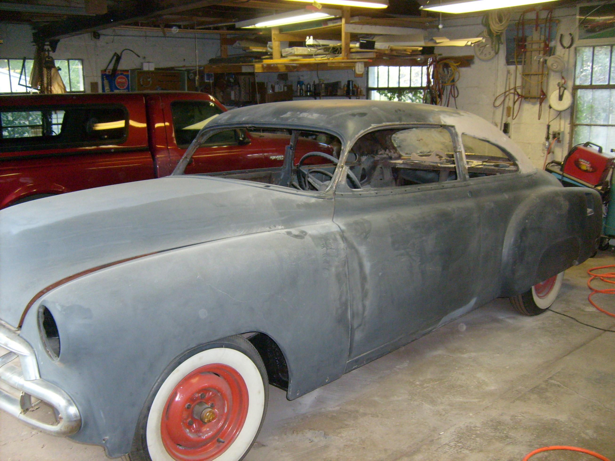

  5. JVK54
    Joined: Jul 19, 2010
    Posts: 479
    JVK54
    Thanks GovernorKC! I installed MonroeMA700s and a crappy little (free) compressor last night , gave the shocks about a 40psi bump and BAM!...problem solved. The car rides waaay better and the stance really didn't change at all..except psychologically. I swear though the rear end came up maybe 1/2 and inch or 1"TOPS I feel like it's totally different driving the car.
    Once again, thanks to you and The HAMB for the help!
    Here's what the stance looks like now. It was fine with me an a buddy in the car with my tools and spare in the trunk.

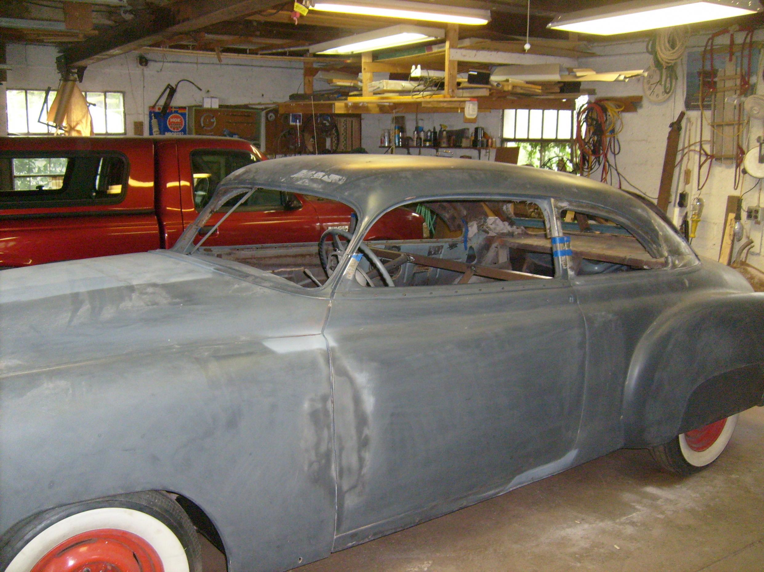

  6. cosmic12
    Joined: Oct 16, 2011
    Posts: 422
    cosmic12
    That looks perfect!
    I am now doing my chop on my 52 and am try'n to figure out how to get it on the ground. The floors in my car are perfect and I really don't want to cut them to do the tunnel or C the frame. I have 2" dropped uprights and blocks in the rear but it ain't anywhere near what I want. Yours is exactly where I want to be. Great thread guys please keep it going!
  7. JVK54
    Posts: 479
    JVK54
    Hey Cosmic, your car looks a lot like mine did in the rear when I just had 3 inch blocks on stock springs. I added 3 inch dropped Posie sliders and that gave me the stance I wanted. You might be fine with those and the blocks you already have..OR you could de-arch your springs.
