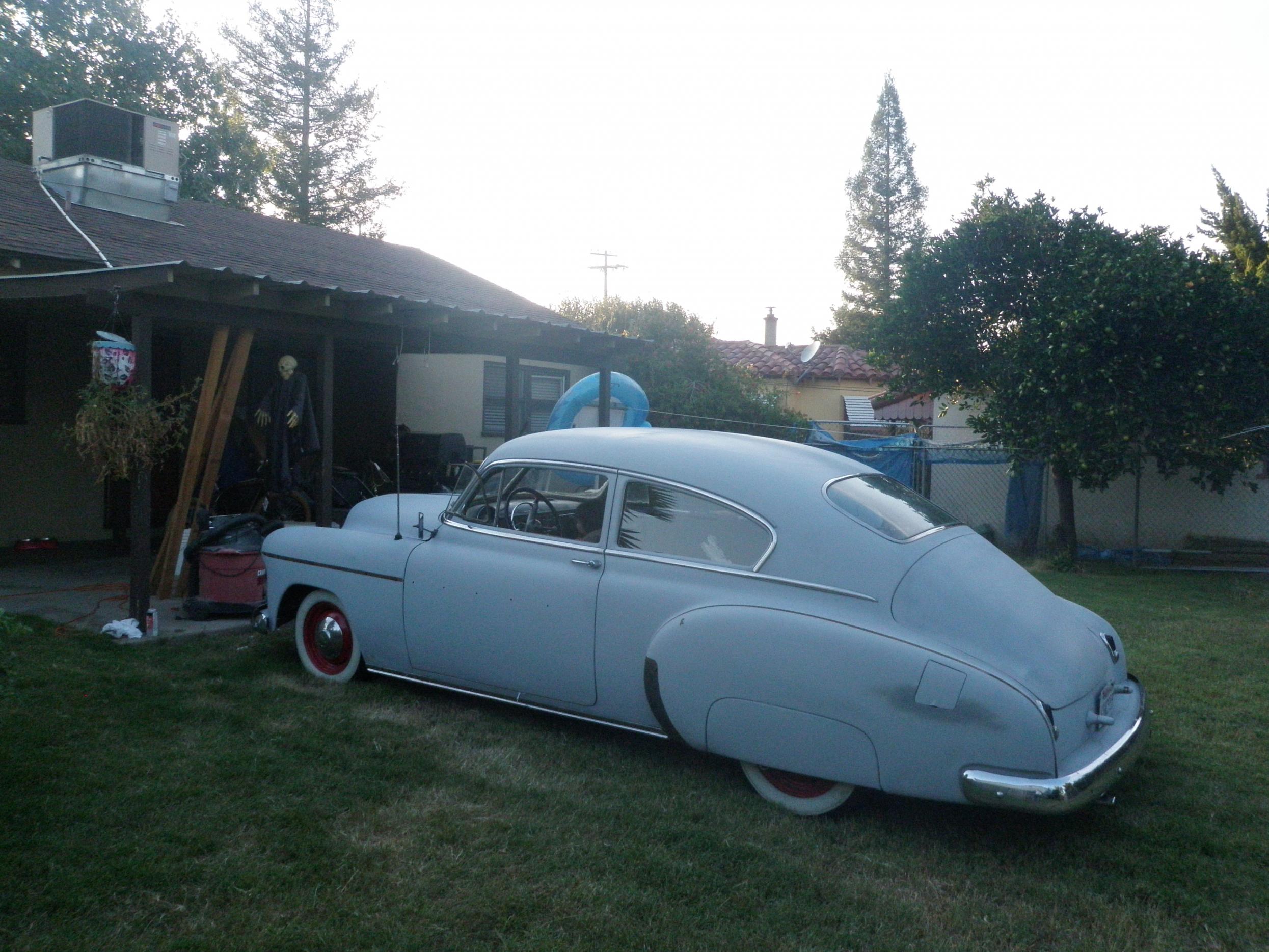

    Here's mine, stock suspension. Took her on the Aces Poker Run through the canyons, rode like a dream. Dips and potholes on the freeway, no problem.

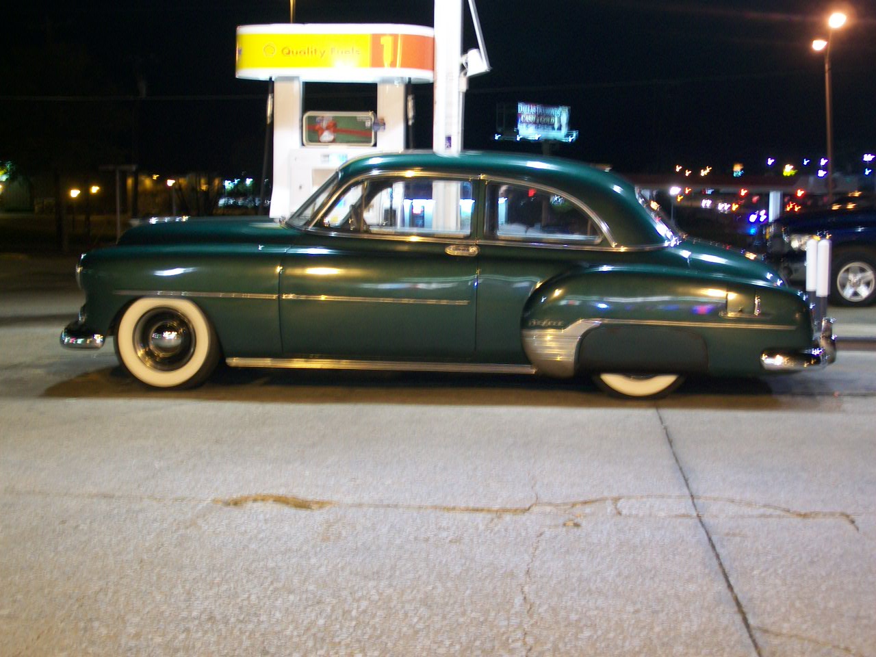

  2. Mines only half of what your looking for. The front is the stock suspension with the dropped uprights and cut coils. It's got air bags in the bag so don't look.

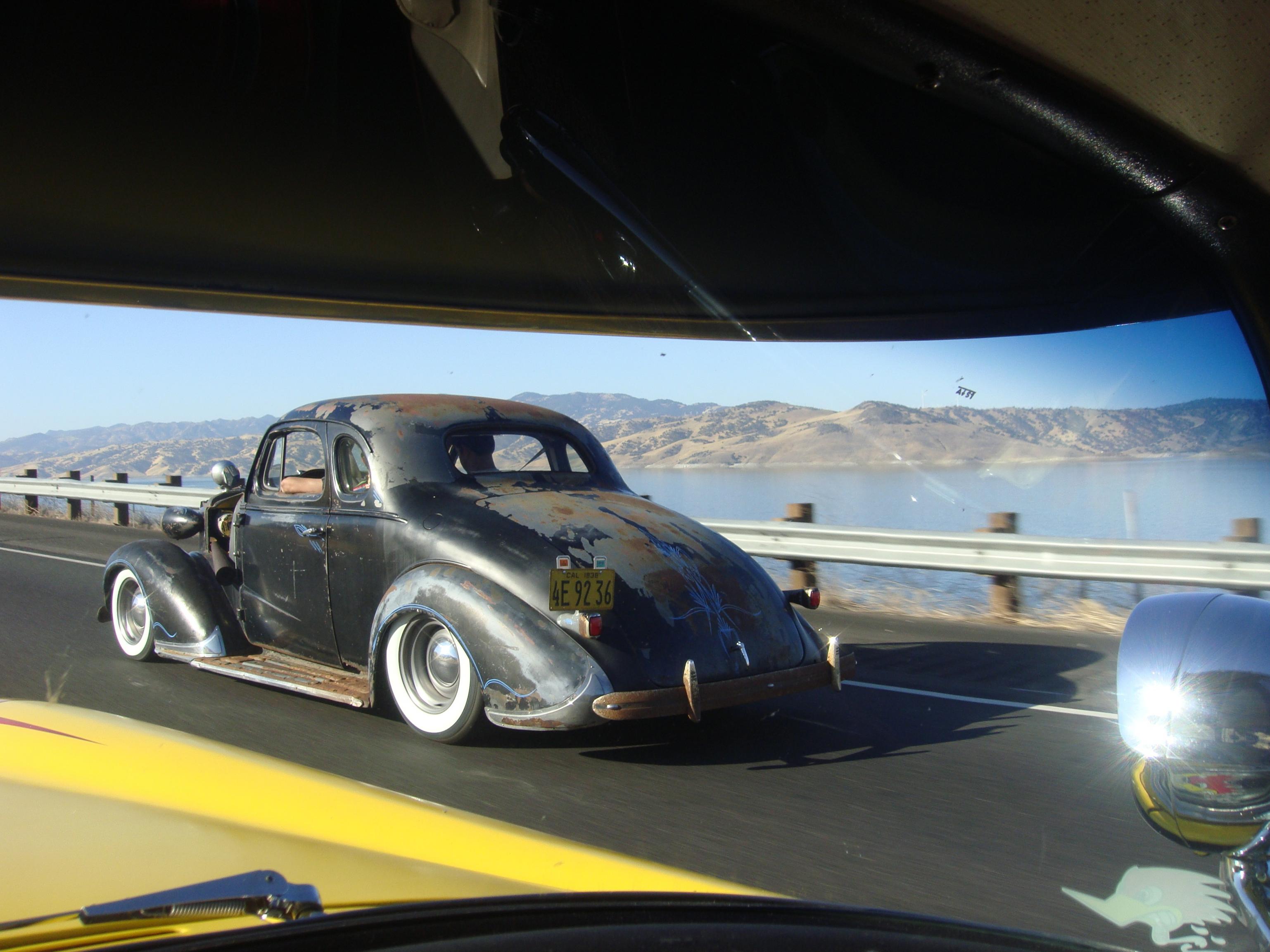

    This is my little Brothers 38 no air on his ride just old fashion lower it to the weeds, and as you can see on our road trip it drives that LOW 24/7

    That 38 is freakin sweet. Awesome stance,,, this is what I'm talking about ,no bags... just plain low!

    Gotta respect people driving this low w/out adjustable suspension, being air or oil, and i mean it.
    But also gotta be realistic, and be prepared to break stuff.
    B4 i went "adjustable" i bent the K part of the front crossmember because i hit it so many times, almost grinded off the rear lower arms pivotpoints (4 link), infact i have a new pair of arms now, and fucked the propshaft mid bearing, plus other stuff that i dont remember right now.
    Its fun and all, but driving 1 or 2 inches off the ground is gonna cause damage, no matter what.
    Oh yeah. Your chevy looks bitchin.
