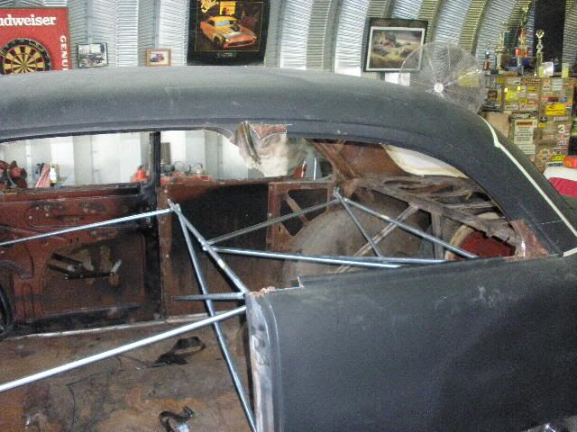

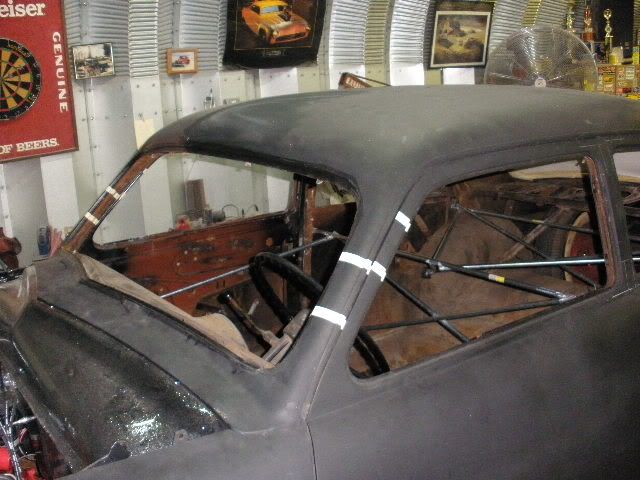

    Just a few shots of my buddy Lenny's '51 I have been chopping. Nothing special, just a mild 4 in chop, slanted pillars.
    Before
    bracing
    Layout
    The first cuts

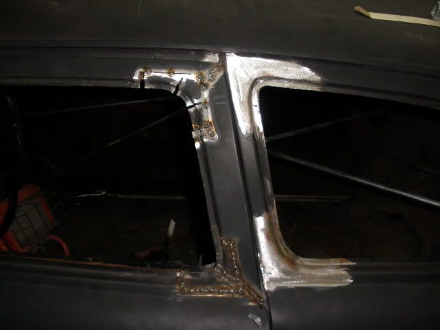

    Window placement
    Now back to work. Still more welding and grinding.

    THEKID49
    It is a straight 4 in following the a pillar, and a vertical 4 in at the c pillar. It gives it a nice slope, but not real crazy.

  30. lmte11
    Joined: Nov 10, 2006
    Posts: 59
    lmte11
    What did you brace the body with? It looks like conduit. If it is, how is it holding up? And the chop looks great.
