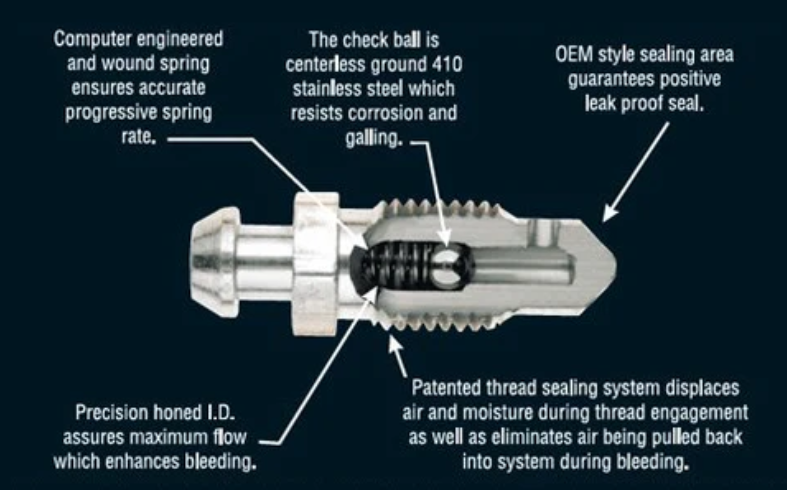

    If you're going to dust some money on a cheapo camera, just buy some "Russell speed bleeders" instead
    I had 9 of them on my Corvette race car [including the clutch]

    Now I've never tried the self bleed valves, I can see how these would work as they don't allow any reversion of the air bubbles back and forth in the brake lines...

    If you can't make Speedy Bleeders work you shouldn't be doing brakes.........................

    Budget36
    So you just crack them loose a bit, the make slow pumps?
    And you can leave them installed too?

    Found a video on them. Slick.
  30. Kerrynzl
    Joined: Jun 20, 2010
    Posts: 3,448
    Kerrynzl
    Yep!
    Crack 'em loose and pump away. Then re-tighten and you're good to go.
    Great at the track between races [especially with Wilwood calipers with 2 bleed screws each]
