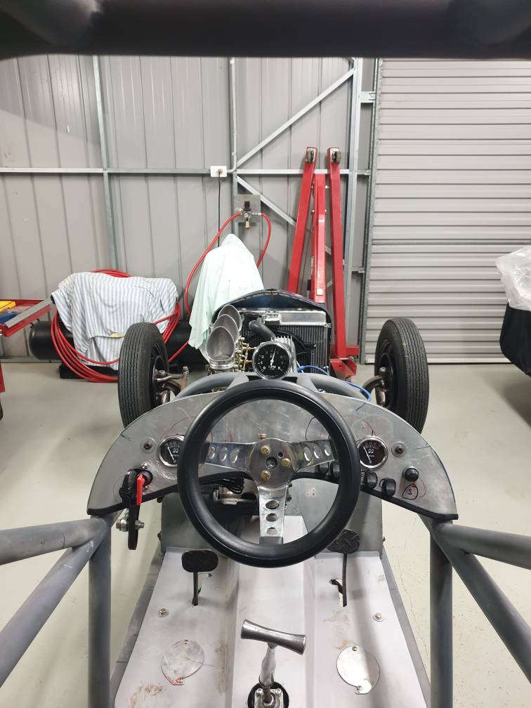

    Slow going this week but any progress is good progress I guess?
    The changes to the cage have now had the final weld done.
    While the car was off having the tig work done I managed to get the dash layed out and get the rest of the parts I need to finish the wiring on order. Once they turn up my focus will be to complete the electical system.

  8. bobw
    Joined: Mar 24, 2006
    Posts: 2,376
    bobw
    You should be well protected with all the pipe in that cage. Looks like a very high quality build.

  10. BS!
    Joined: Mar 17, 2010
    Posts: 193
    BS!
    Yeah I was suprised at all the changes and extra bar work the insector demanded but I guess at the end of the day they are the ones signing it off so I have to play by their rules.
