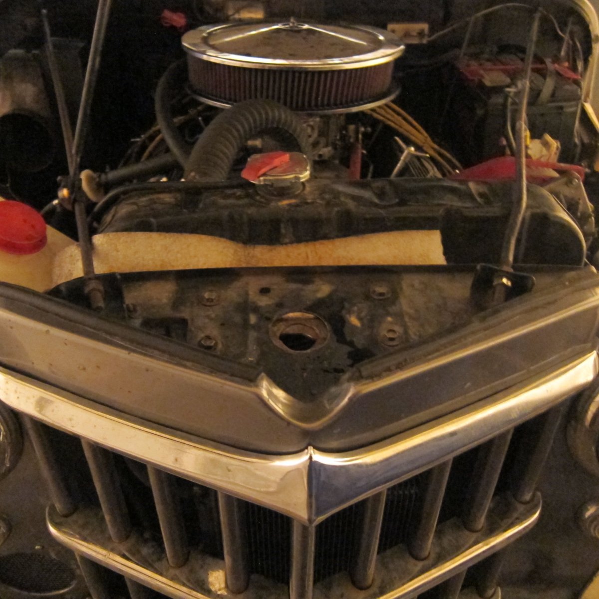

    Well I went to OReilly's and checked out their pressure tester. I pumped it up to 11 psi. The rad cap says 7psi on it so I was afraid to go any higher than 11 psi. Not sure if that is the correct psi cap. Any way it dropped 1 psi in 21 minutes. What do you think? One psi could be do to a ware and tare on the seals of the tester maybe...? Not sure if I should pump it up to 15 psi, don't want to create a leak...

    That shroud sux... Take that pusher off put a better shroud should help alot. Vapor lock is obvious on that thing. Reroute that fuel line more toward the front than having it above the exhaust. Problem should be solved. If still over heat go back to timing like Jim says. 34' at 3k rpm.

    No smells. Here are a few more pics of the rad, best I could get. Thanks for every ones help. IMG_2192.JPG IMG_2194.JPG IMG_2197.JPG IMG_2198.JPG

    It's a short water pump, and it's not aluminum, so it should not be reverse rotation. afaik.
    The radiator looks kind of small, to me. But I live in AZ, so I see things a bit differently.

    I wonder if the heater core is plugged ? Have you looked at that? Also have you replace all your hoses. And that radiator looks small because of that bootsie band strap shroud. With that 18 inch fan. Sheesh also I'm looking at the pics and the bottom radiator hose looks like it could be kinked right were the water pump is. or I'm seeing it like that because of Shadow. Escuse me I'm using my phone so pics are smaller no zoom. Also when the motor warm up those hoses get soft and I'm wondering if it kinks out on you and your not noticing the hoses. Also if those are fine. Take your temp sensor off the intake and test it or if you have a spare one laying around hook it up and see if it read the same. Could be bad temp sensor.

  19. A little off the subject... but the gas filter gives me the "willys". I never use plastic ones and never route one across the exhaust manifold like that.
    Karl M likes this.
  20. Given how tight the engine compartment is, and we haven't seen photos of the lower rad hose...is it possible that it is collapsing?

    Unless I missed it in one of the posts, what size pulleys are on the crank and water pump? Its hard to tell from the photos but the water pump pulley looks somewhat large in diameter.
    We run into this quite a bit. Folks will use performance ratio pulleys (smaller diameter crank and larger diameter water pump) and the car will overheat due to the water pump not turning fast enough. Always use stock diameter pulleys.
    We will change them back to stock diameters and 99% of the time the cooling issues go away.

    Take a good look at the lower radiator hose, rev the engine with it hot and watch the lower hose and see if it gets sucked together. Should have a spring inside of the lower hose to prevent it from collapsing.

    Thanks for all the great input. To much fun going through and fixing the PO modso_O. Yes the fuel line/ filters will be remedy soon. I watched the radiator shop guy pressure test the rad and no leaks. He back flushed it and said it had great flow. He said it did not need to be rodded out. He did say old antifreeze globs came out, like little bbs of jello.
    I am wondering if the PO put in orange anti freeze and I topped off with green, hopefully not. The bottom hose and top are new. They both have wire in them. Bottom one is not kinked, just a very tight fit. I am not sure on the size of the of the fan pully? Any ideas on what that should be? I did back flush the heater core when I flushed the entire system before taking the rad to the shop. Maybe I need to do it again.... I do see fluid movement in the top of the rad with cap off. It does not seem to make an difference with or without the new thermostat. Supposedly the water pump is new and not rebuilt... And we go...

    Great, good to know, how do I figure what is stock for this set up?

    If the water pump pulley is larger in diameter than the crank pulley, the water pump is under driven. Hence the term "under drive pulleys".
    Generally small block Chevys have a crank pulley around 7" in diameter and a water pump pulley around 6 1/4 ". Under drive pulleys are around 5 3/4" for the crank and 6 1/4' for the water pump.
    I'm sure there are other diameter setups also, with ac/without, different years etc.
    Most factory setups have the water pump overdriven, (larger crank pulley-smaller water pump pulley).
    Hope this helps.

    Did a quick measurement this morning...Crank pulley aprox 6 5/8, water pump pulley 7 inches. I'll take a closer look tonight, but the h2o pulley is bigger. will check Oreilly's tonight for a smaller one or junk yard. Go figure just put a new belt on.
