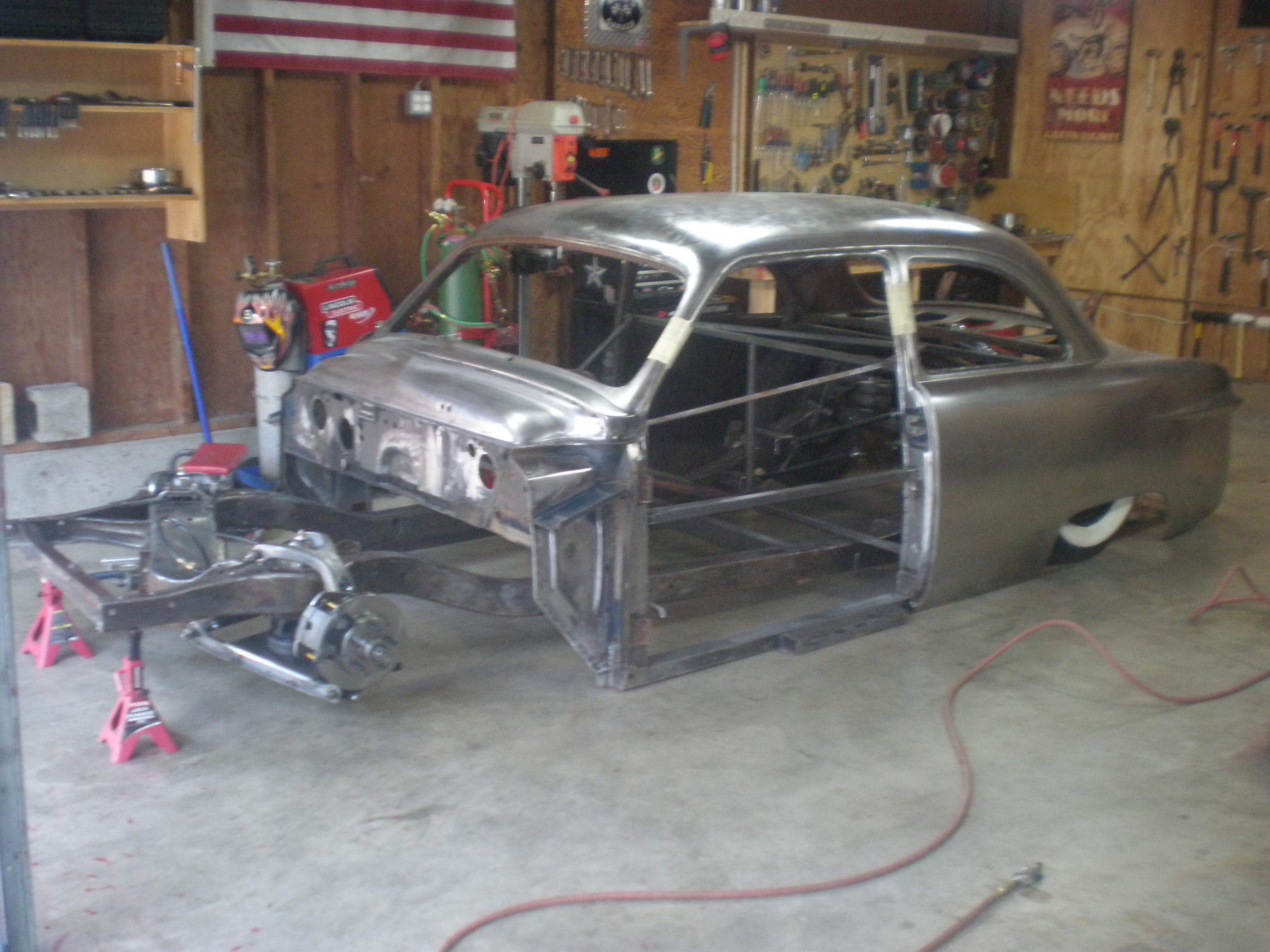

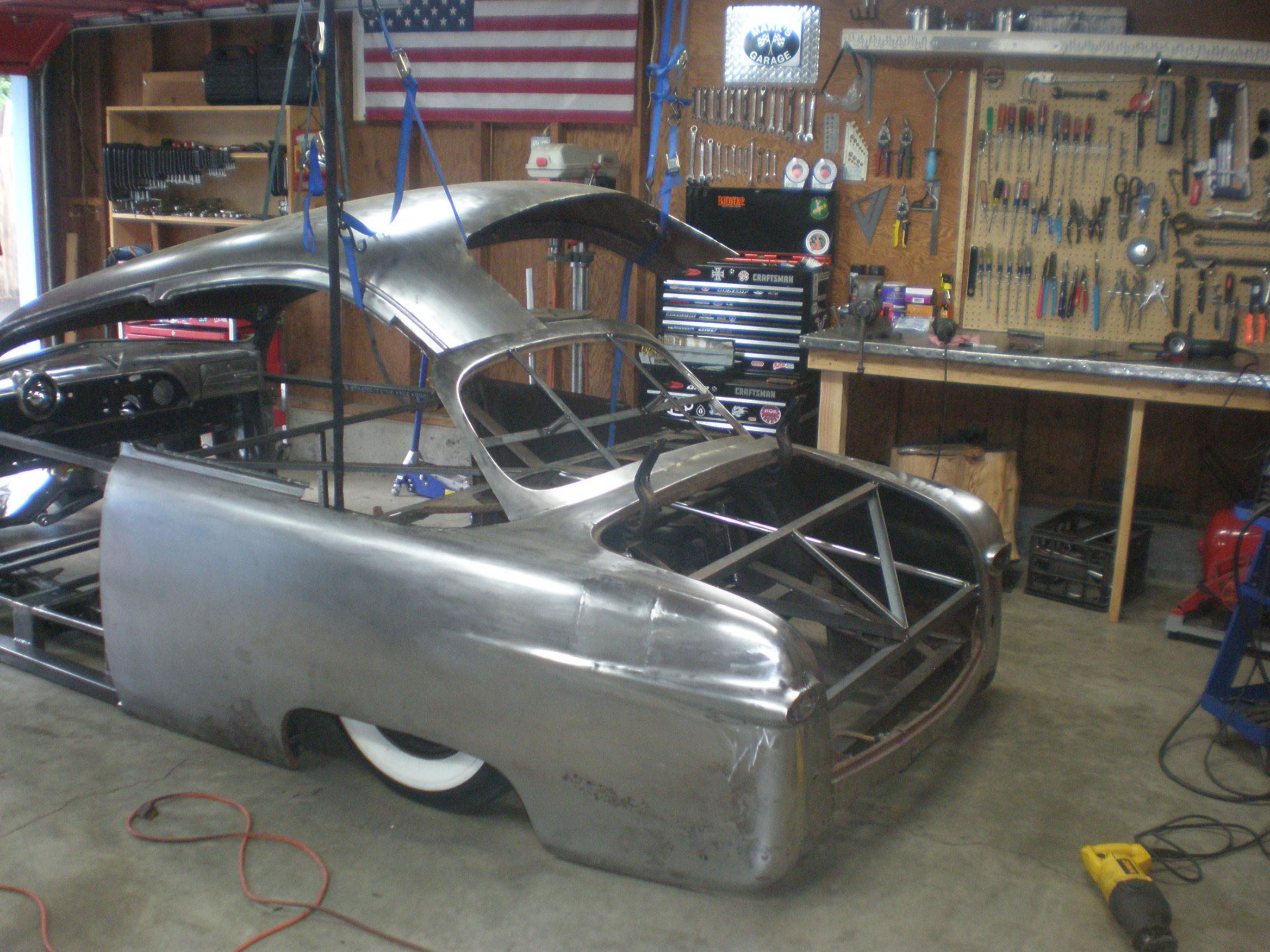

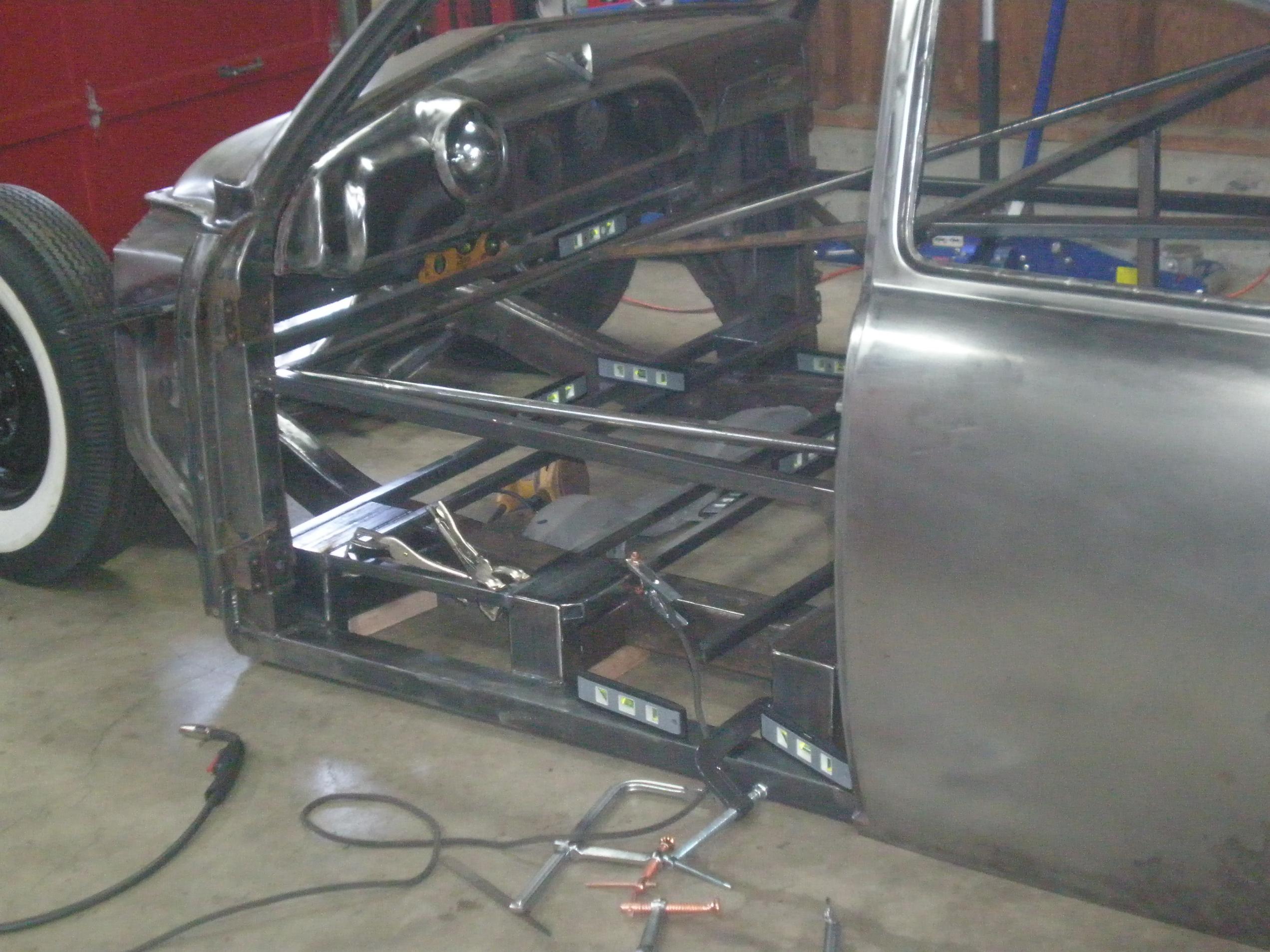

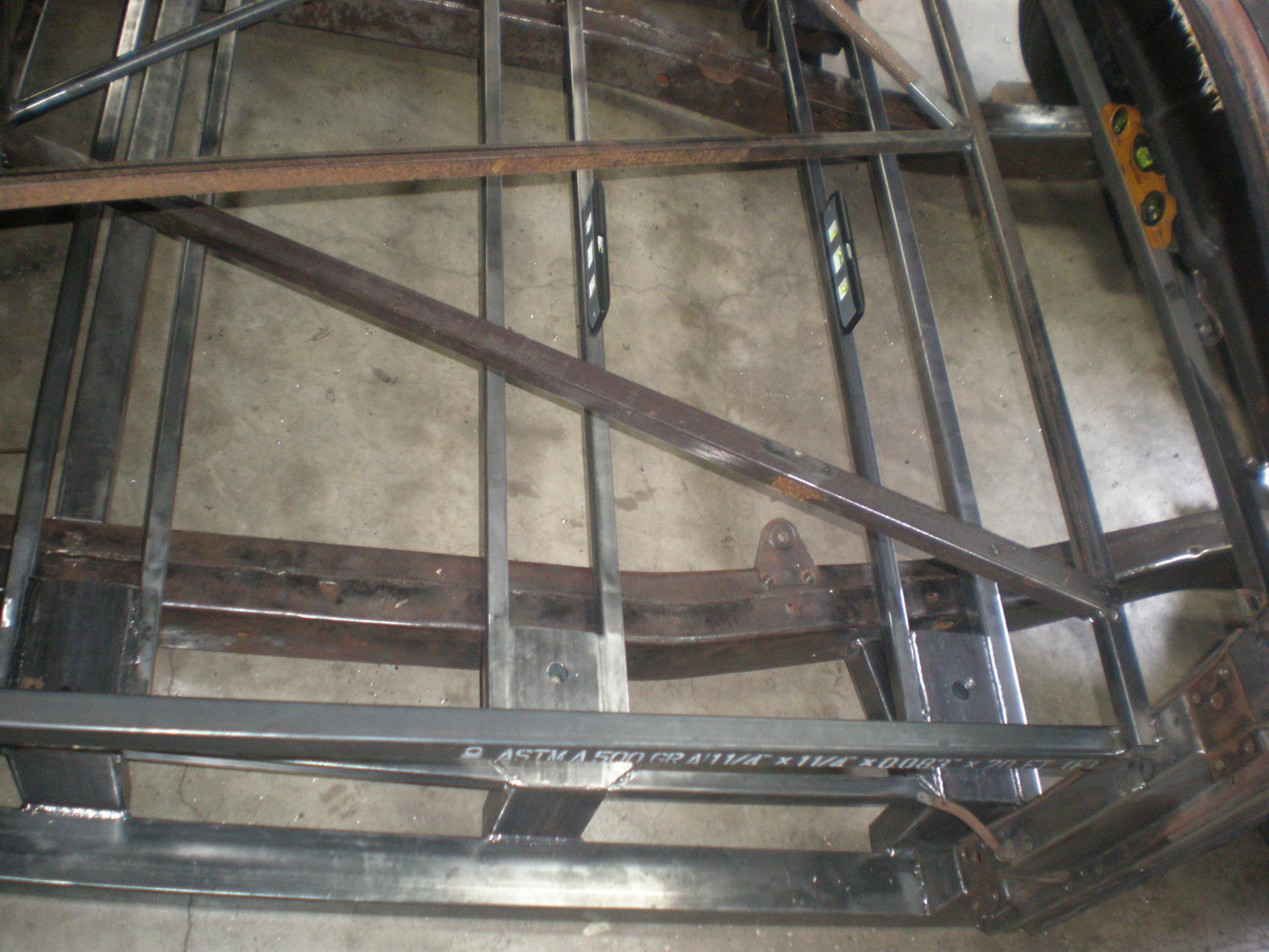

    I have spent the last 2 weeks channeling the body and building my floor structure. I ended up channeling the body about 4 inches. I am really stoked about how its turning out. This a really time consuming process, but I enjoyed the shit out of it. I have alot of finish work to complete, but the body is mounted down and very solid.

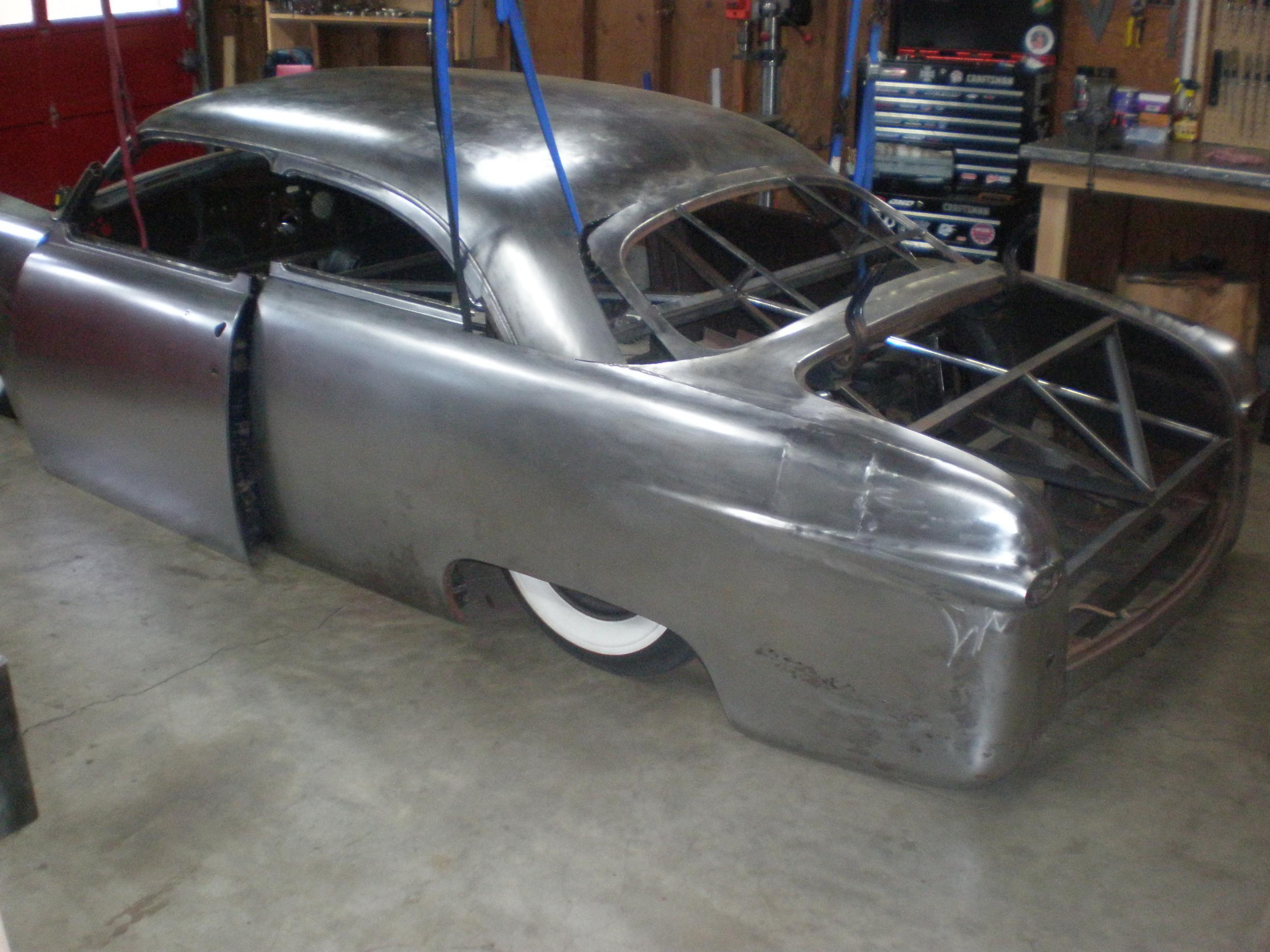

    It was great to roll this old gal outside today to get a view. With the 3 inches I took out of the lower body and the channeling, this thing sits real low. The good news is I get about 8.5 inches of lift which is plenty for me. The frame is up and clear to give plenty of room for my oil and tranny pans.

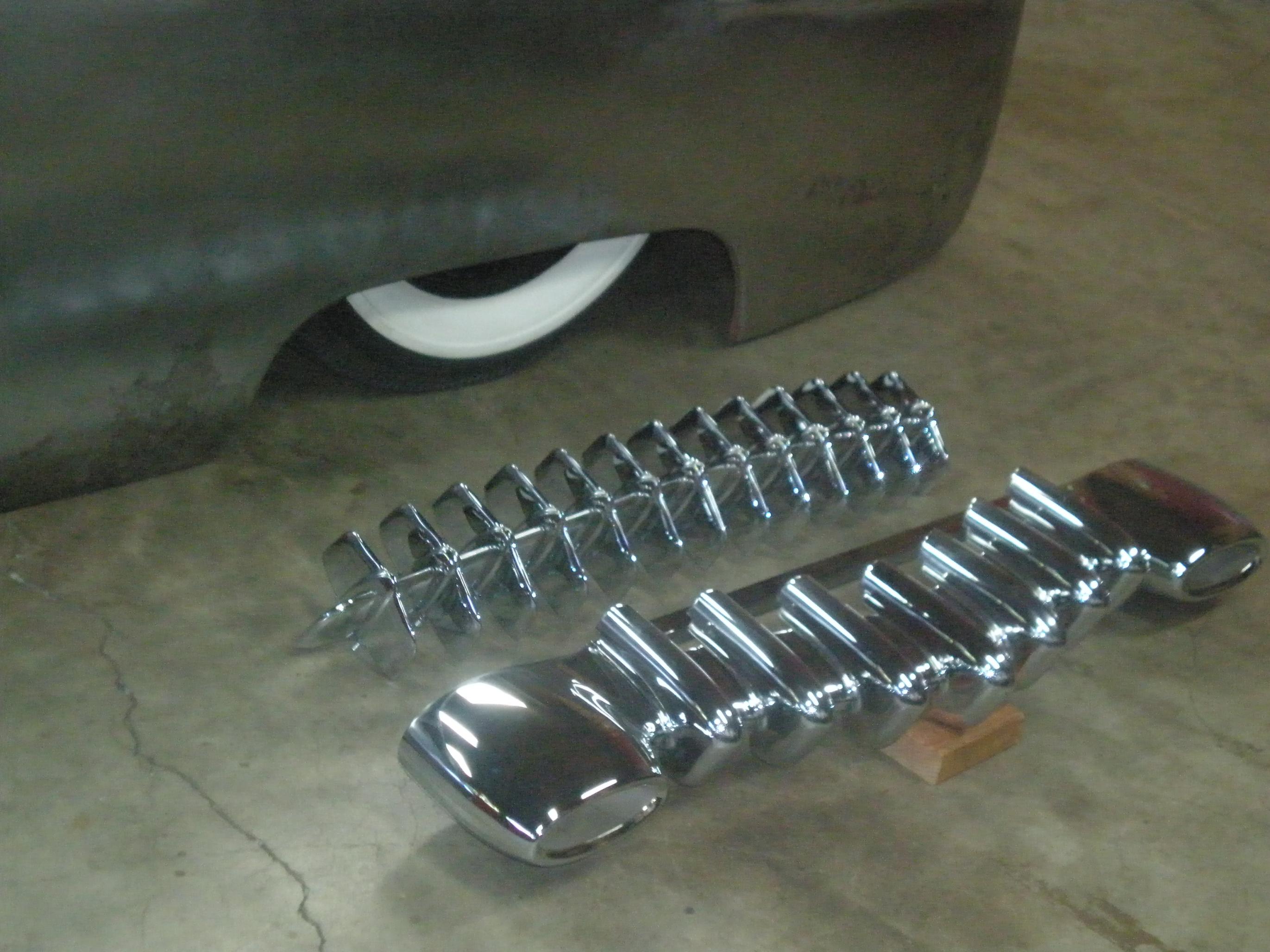

    So, I ended up being in the right place at the right time for this one. I picked up a cherry 54' Desoto 7-tooth grill!!
    So here is a question for my fellow Hambers - Do I use the Desoto or the Corvette grill? Any votes?

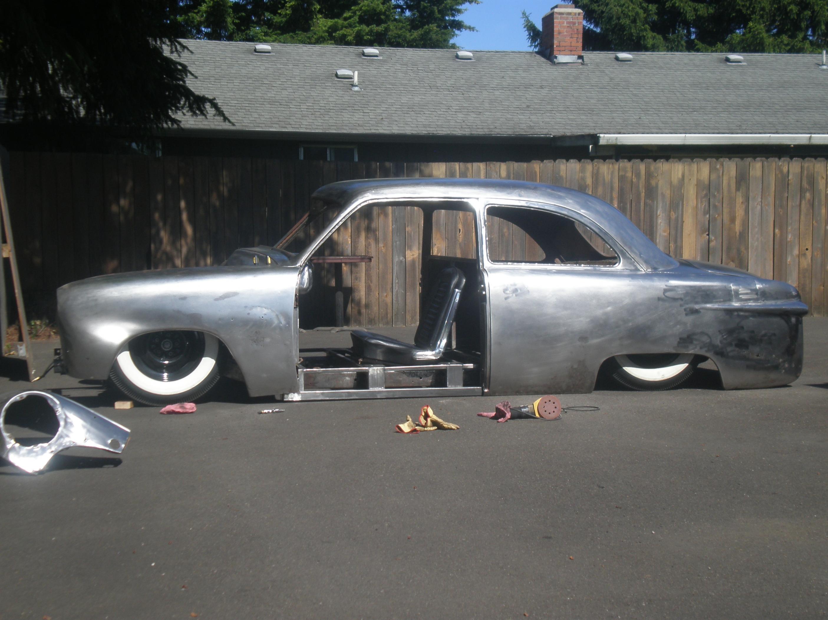

    Progress Update: CHOP SUEY!
  29. EssexCoupe
    Joined: Sep 30, 2010
    Posts: 176
    EssexCoupe
    from Vantucky
    5-inch haircut should work fine.
