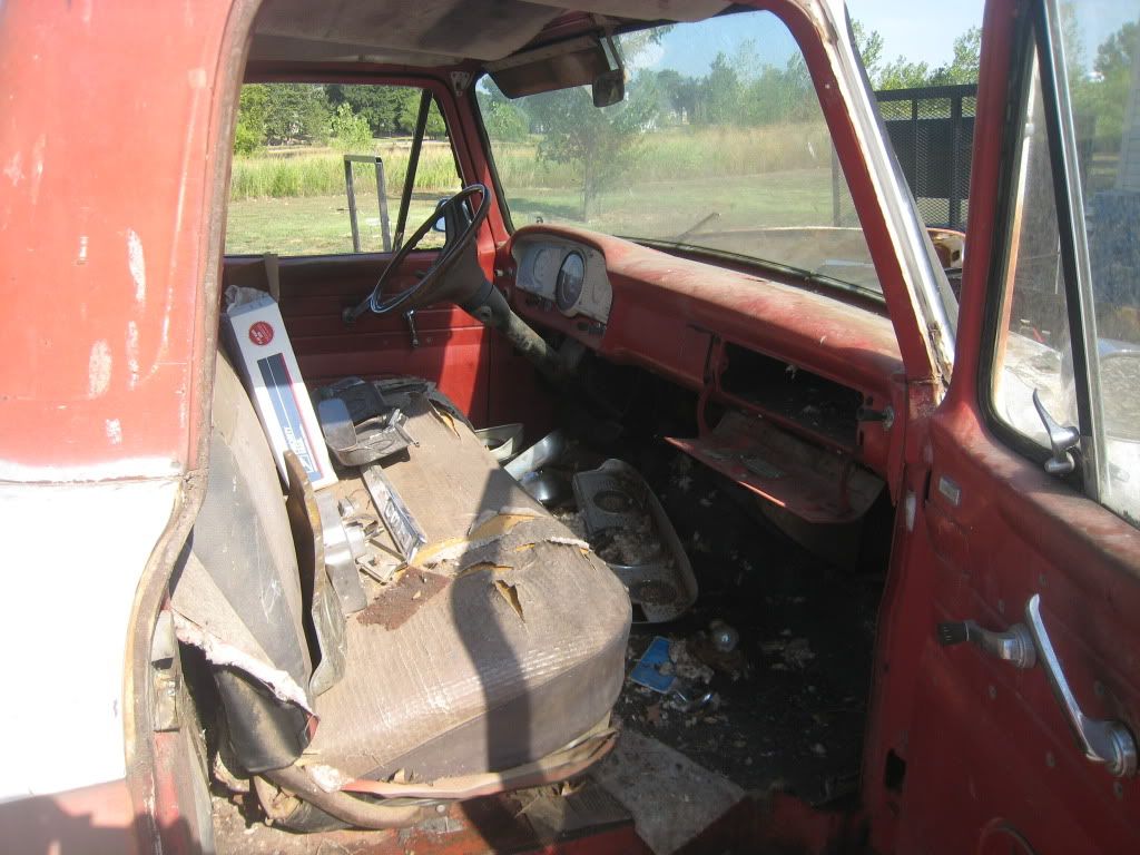

    i started looking on the net at different ways people where lowering thiers, or trying to get them low, with out doing a front clip. i quickly realized that doing a cheap lowering job was not going to be in the cards for me. i made a call to good old uni body/chassis expert elpolacko and got some info from him. my mind was made up that i now needed this, not sure why, but damn it i did. so a deal was made, and my buddy mike standley and i pointed the trailer south to pick it up. chadillac threw in some extra stuff and we had a good visit with him.
    got it unloaded in the am and spent a solid 5 hrs pressure washing and cleaning out the inside, not sure what was living in this ol truck, but it sure shit allot. the stock fuel tank in the cab had leaked and the spilled fuel had eaten the rubber mats on the floor leaving a tar like substance and stench. after the pressure washing i quickly realized that it had more rust then i was hoping for, the front driver cab brace is basically missing, and sagging, needs floors, toes boards, etc.. all fixable, just was hoping that i don't need to do this extensive of a build on it.

    cleaning up
    im a cali by so i don't do well with rodents, spiders, etc.. this thing scared the shit outta me, then i realized it was fake.
    all cleaned up inside
    quick mock up with the pony interior and center console.

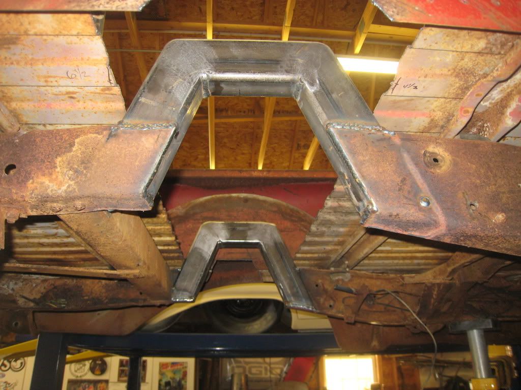

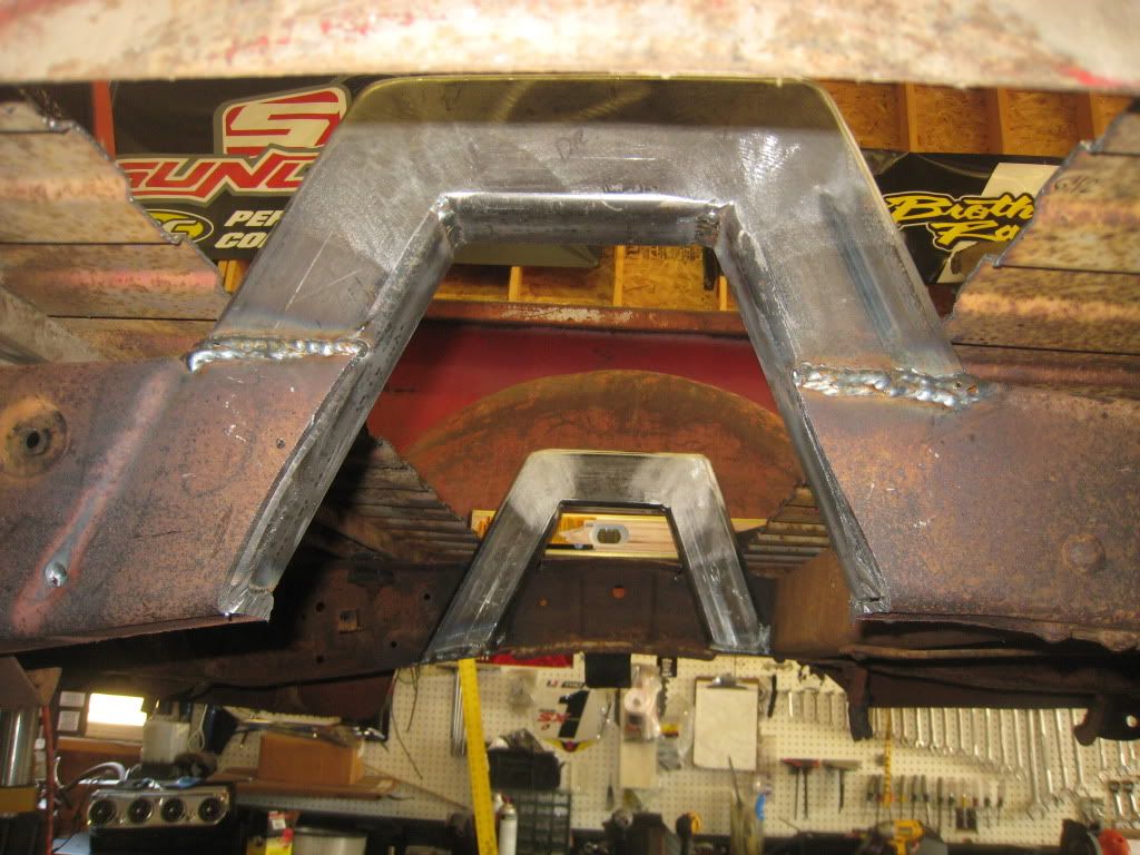

    day 3
    decided that i would start and get all the suspension ripped off the frame and ready it for the fab work on teh rear end and front.
    got it leveled out and on the lift.
    started on the rear suspension. notch fab'd and all welded in today.

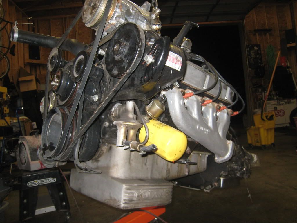

    didn't get as much as id like done.
    spent the morning cleaning up and removing the stock brackets off the rear end. got it all da'd down and looking good, when a buddy called and said he was heading to kc obsolete parts in miller mo to pick up some stuff from his buddy Reggie, and if id like to roll with, so i closed up shop and headed to miller/phelps, basically middle of now where!
    reggie only does ford trucks parts. he has a lot of stuff that id like to get, but trying to stay on track with the budget build here.
    after our trip and some lunch , we decided to dig into pulling the motor and tranny ( fairly built 289 30 over balanced etc, and a cruise o matic automatic) that im going to be using in this truck out of the donner mustang. we got the front sheet metal, gill assy, motor, tranny, etc all pulled in about 2 hrs! mike has been building custom mustangs all his life and knows every damn nut and bolt on these things like the back of his hand. we also got the 9" rear end all rebuilt with new bearings, seals,brakes, drums, etc and inspected the gears. all good and ready for some brackets and link bars tomorrow!

    day 5
    left the camera in the shop and im beat, so no pics tonight
    its been hotter then shit out there, about 110 in the shop today!
    got the link bars fabbed up, new hangers fabbed and welded to the frame, pan hard bars mocked up, need some more tubing and an insert in the am to finish it up tomorrow, teh front end should be in tomorrow as well.
