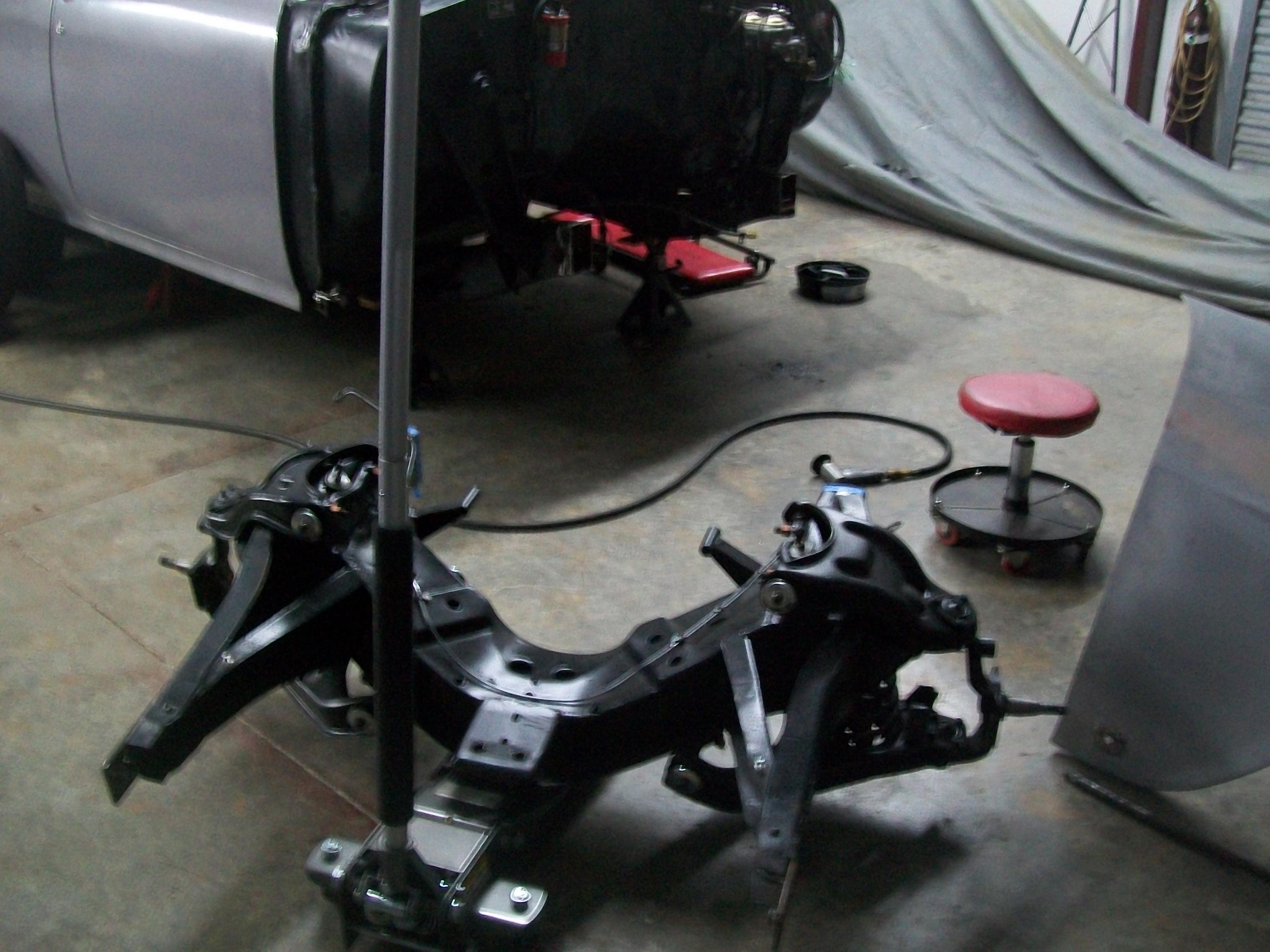

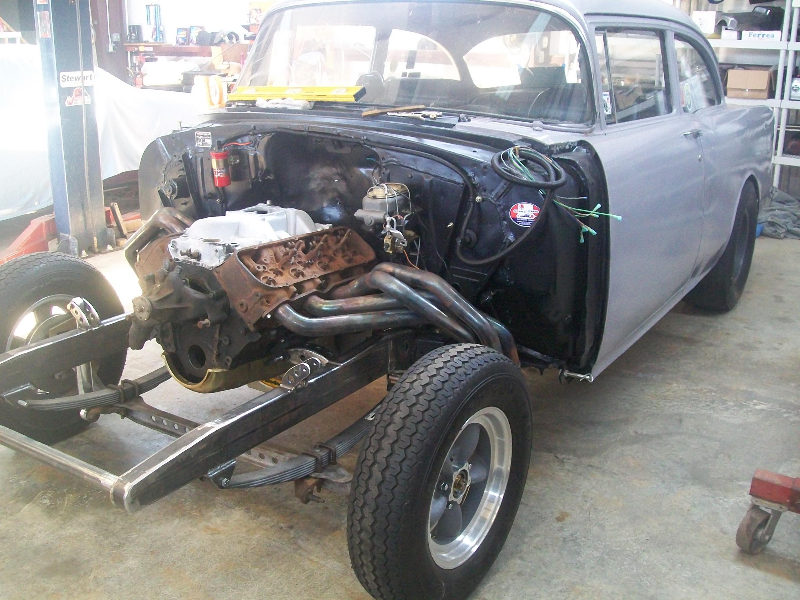

    Hey guys I've gotten far enough along on my car I thought I would share some pics. I am doing an axle on my car from scratch. Here is the front cut off, I cut 4-1/2 inches ahead of the frontmost part of the front body mount.

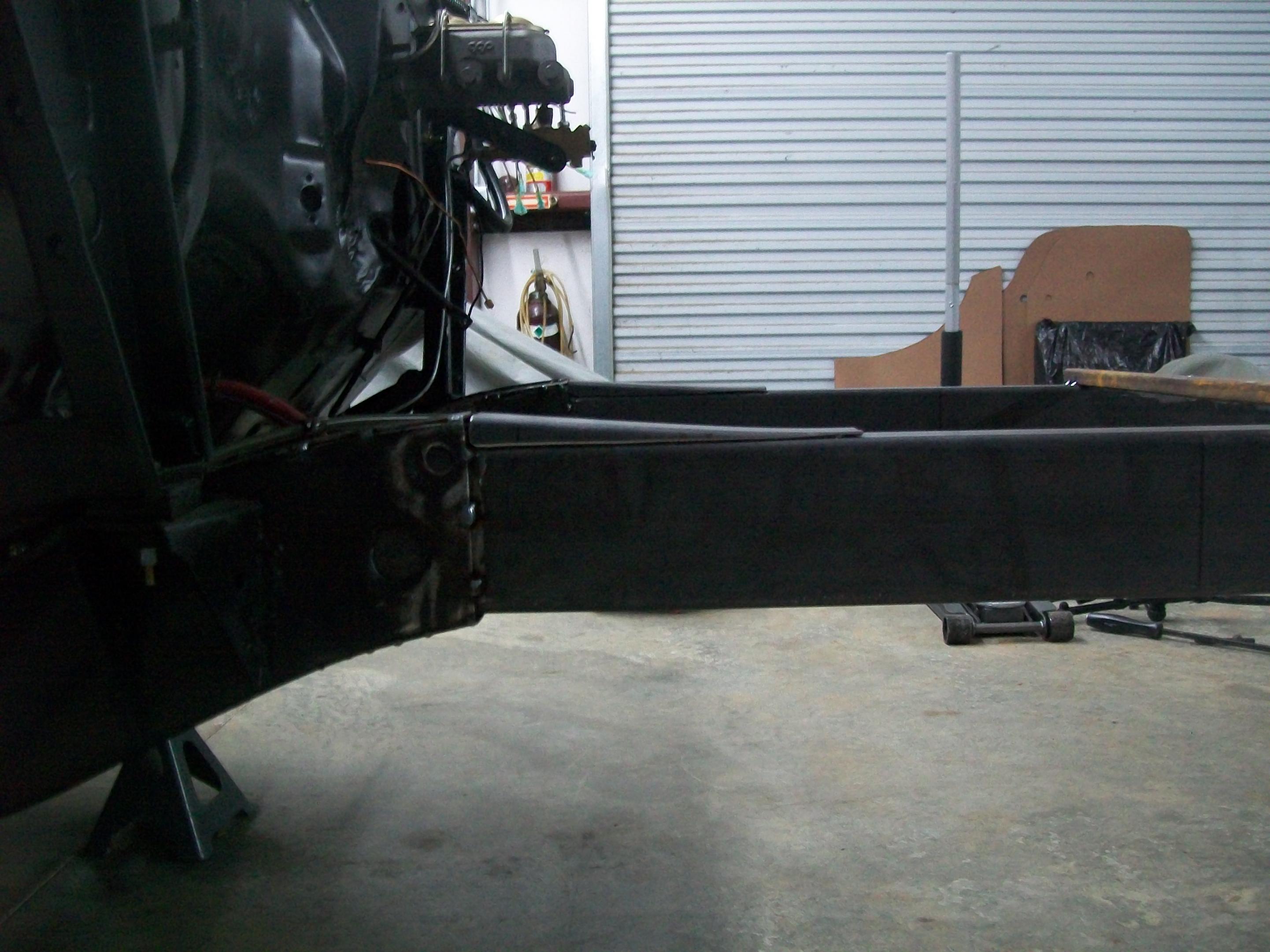

    Here is a pic of bullnosing the frame rails.

    Made the stub with center on 31-7/8 to match the centerline on the '57 truck axle I'm using.

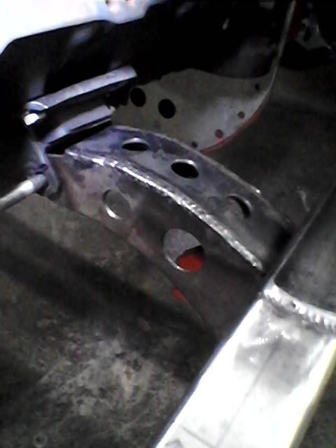

    I trimmed down the stub a little to where the spreader bar stuck out where I wanted it to. Then I sunk the stub in until it hit the downturn in the frame. I left it level on the bottom, pie cut and folded in the sides and left the top open, then filled the gap with a few pieces of 1/4 inch, then welded them to the old frame and new stub. I am using a wedge piece to cover that, and to blend the frames a little more gradual.

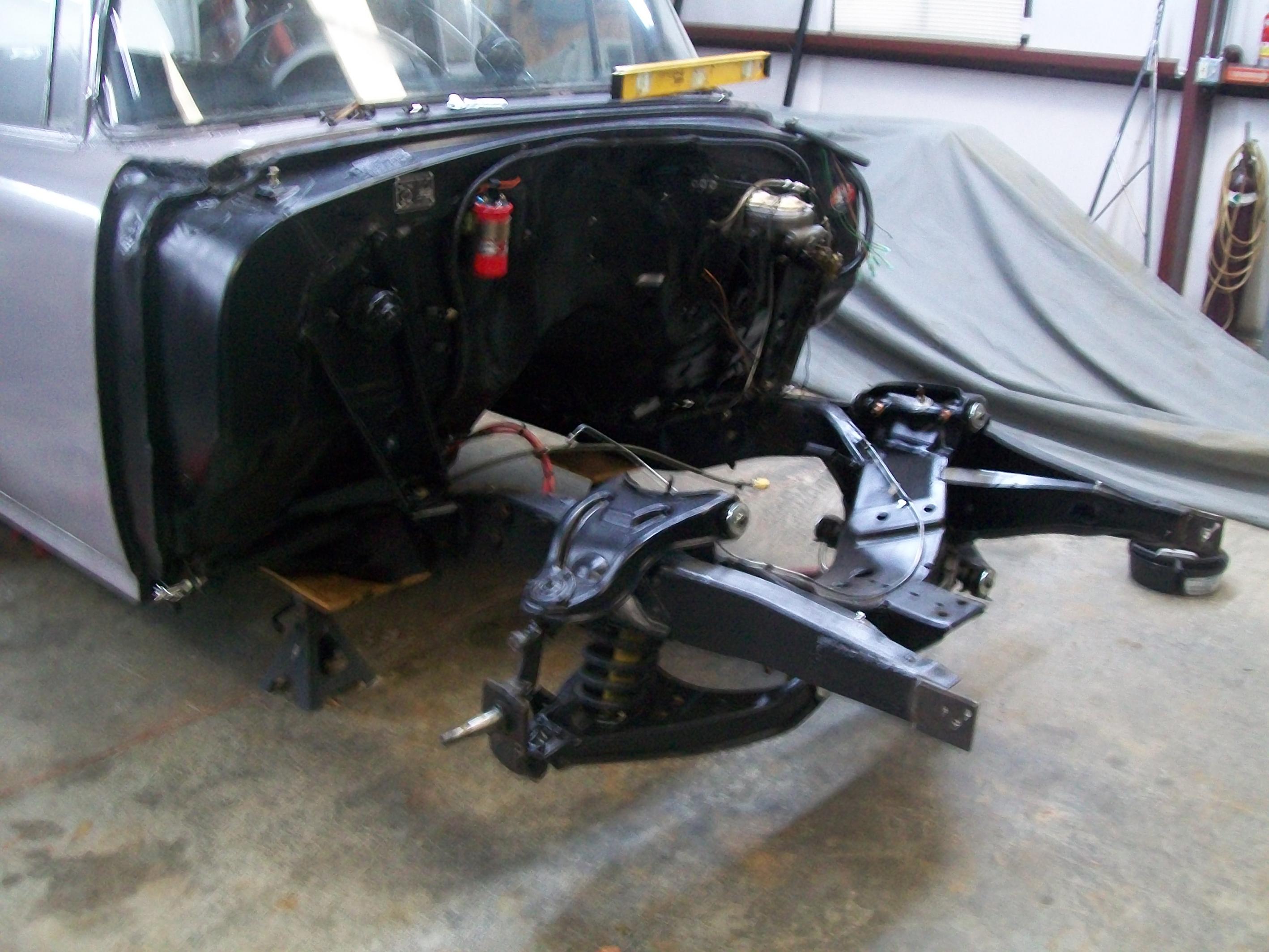

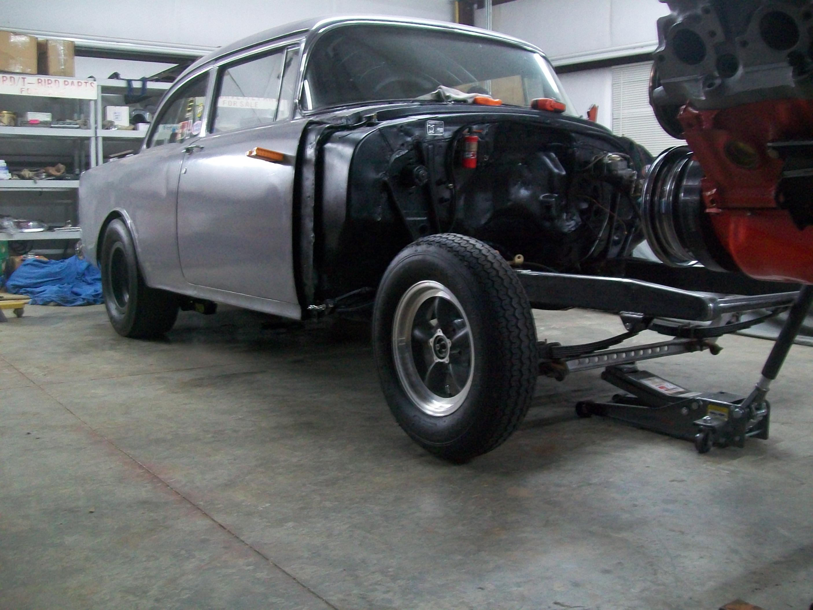

    I made sure the rear suspension was loaded and measured between the front and rear leaf spring mounts on the frame to make sure they were square. Then I verified that the rearend was square in the car between those two mounts. Then I dropped a line off of the front mount and set the centerline at around 117-1/2, the factory WB is 115"

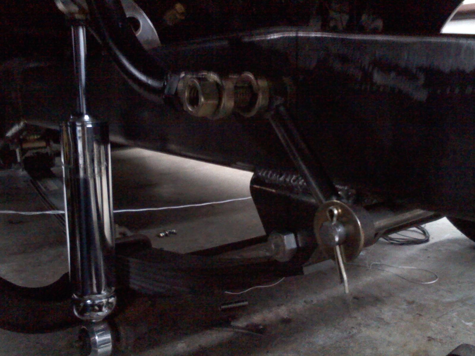

    And here is some pics of what I did today, I made some shock mounts and some motor mounts to match. I will try and get some more pics as I go. If you all have any questions or want any more pics, just ask.

    Here's what I got done today. Motor mounts tacked in place, shock mounts welded in, started mocking up the brakes so I can figure out how I'm gonna do the steering.

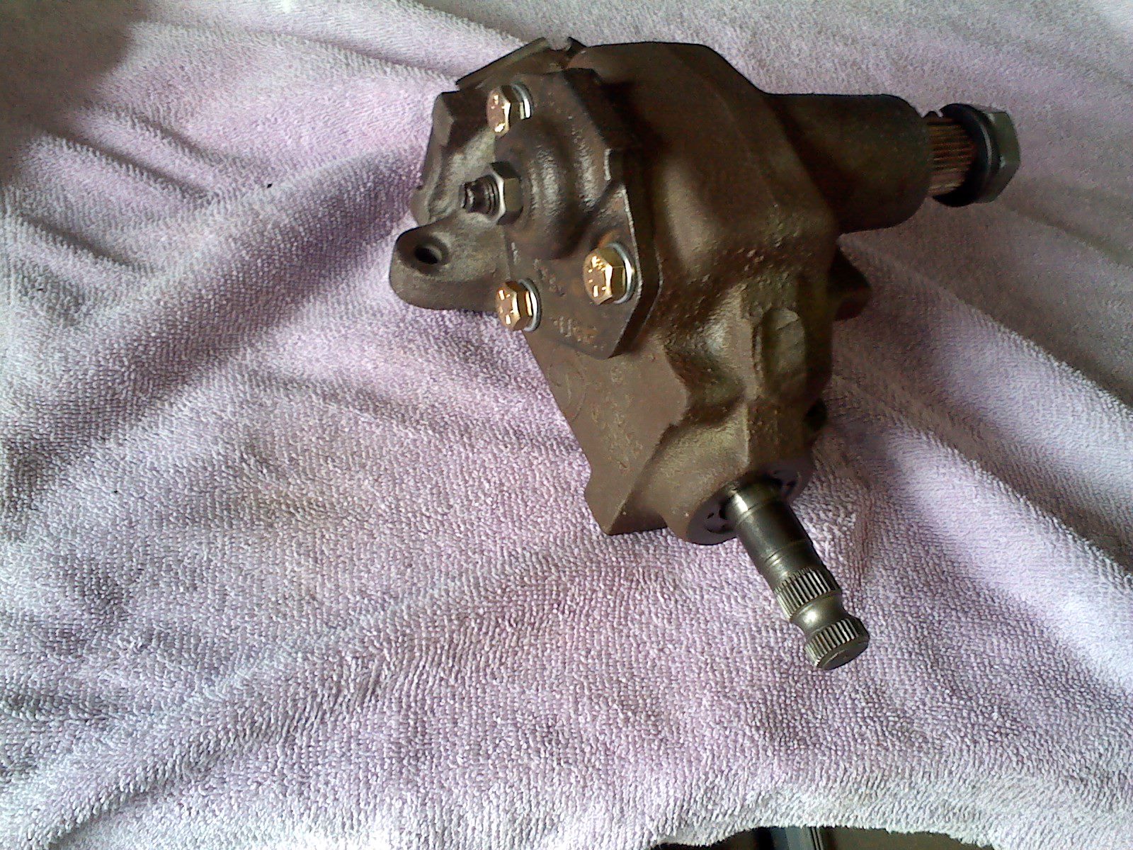

    Been working like crazy but have had time to do a little. I made me a short shaft, reverse rotation 525 saginaw box. I had to reverse the rotation to mount it inside the frame with the pitman arm pointed backwards and the steering arms on the back of the spindles. This is gonna work sweet as hell were I am gonna mount it.

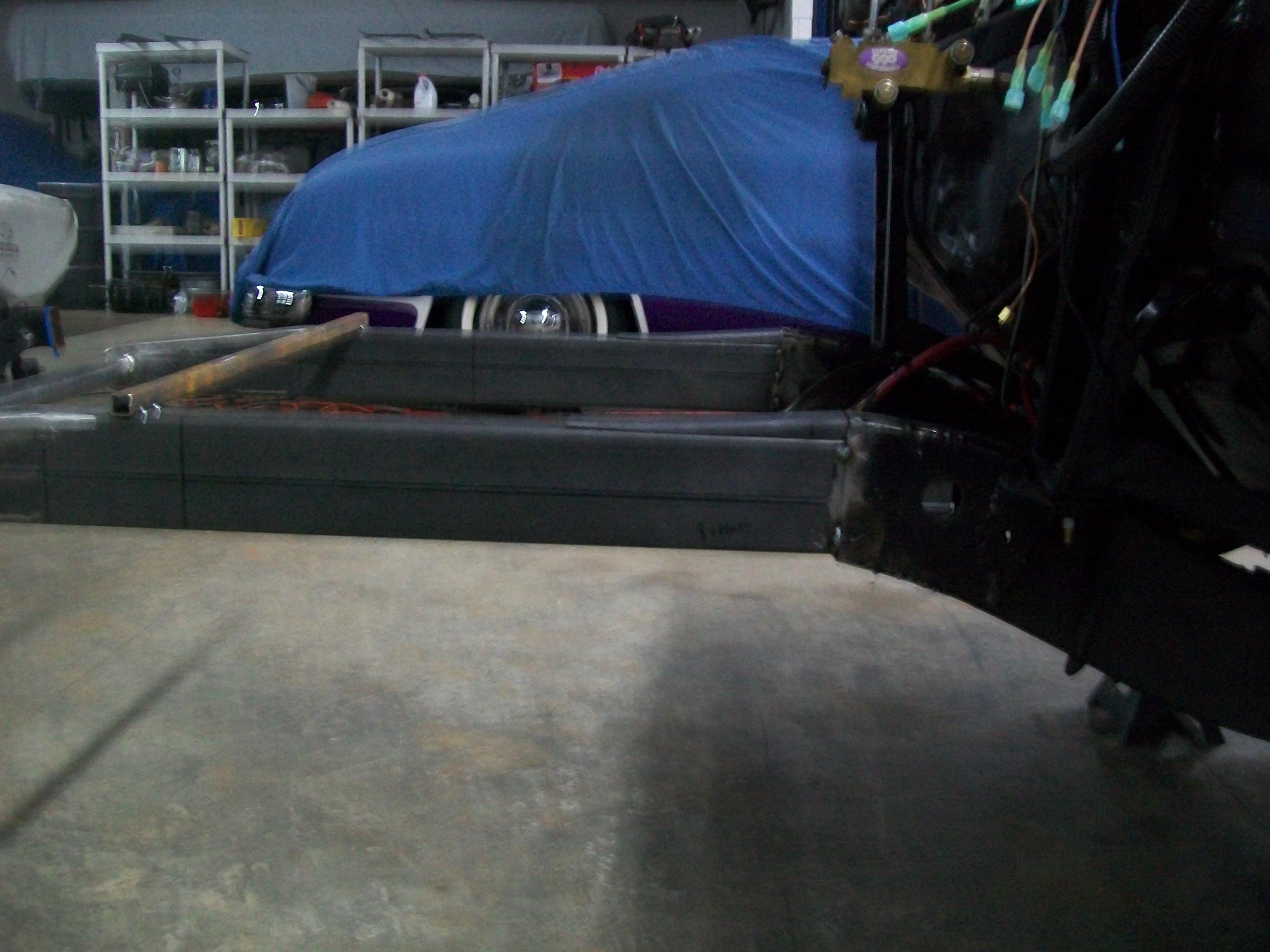

    Here is the setup I came up with to move the frontend forward and flip it.
